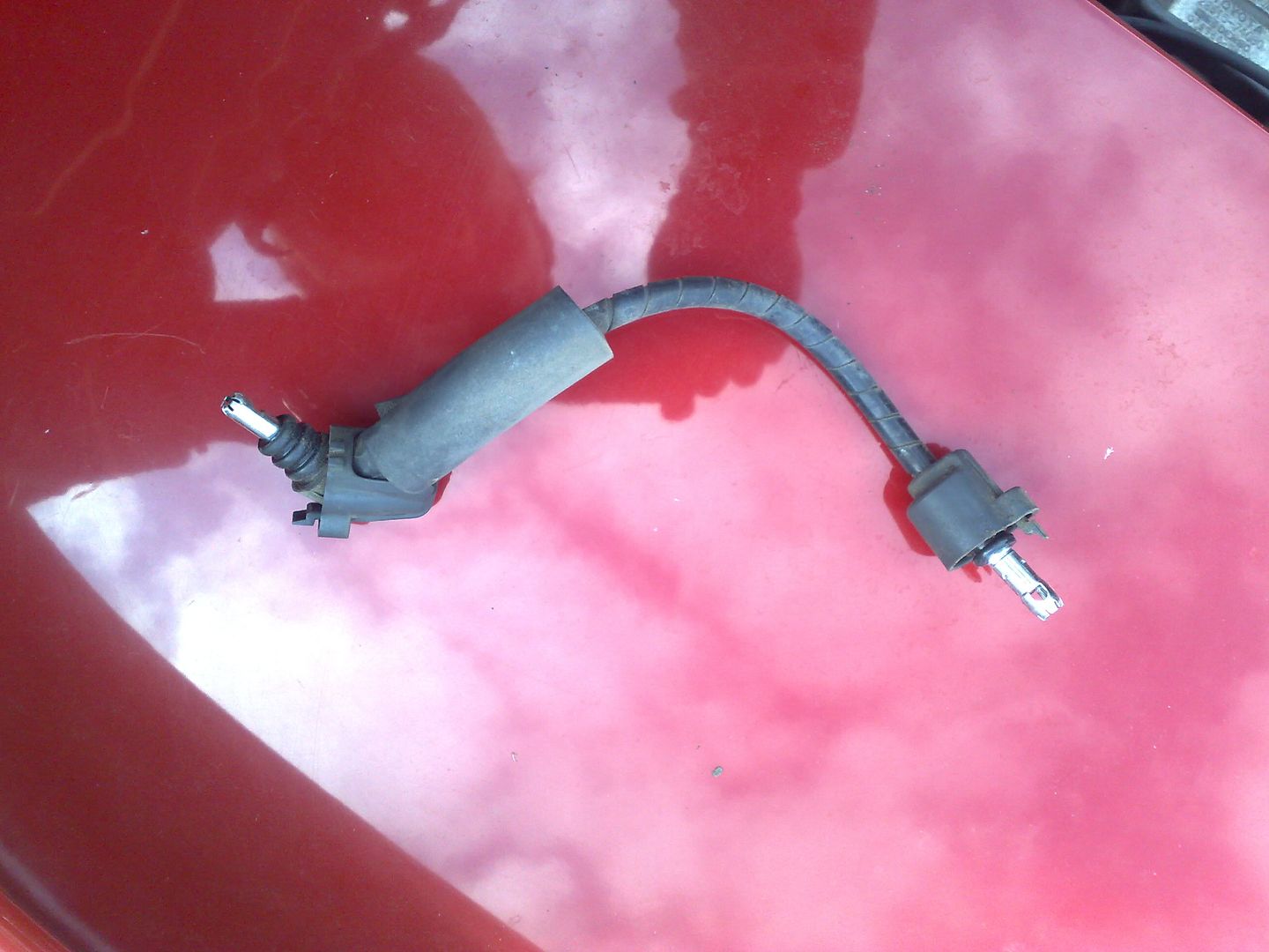

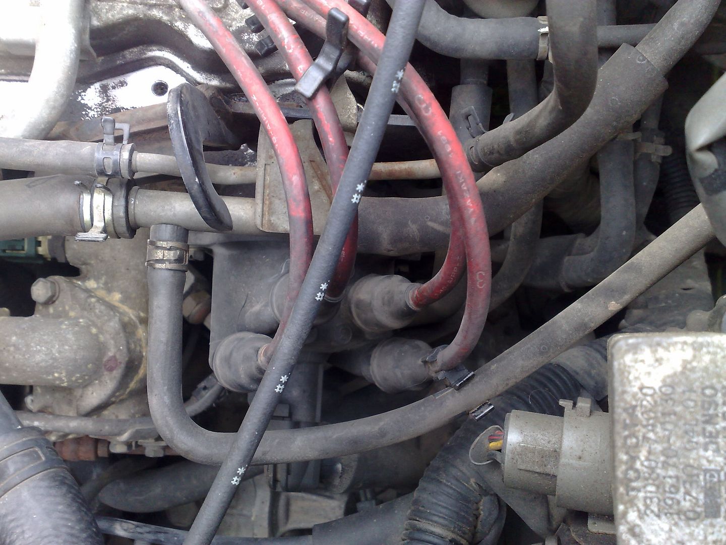

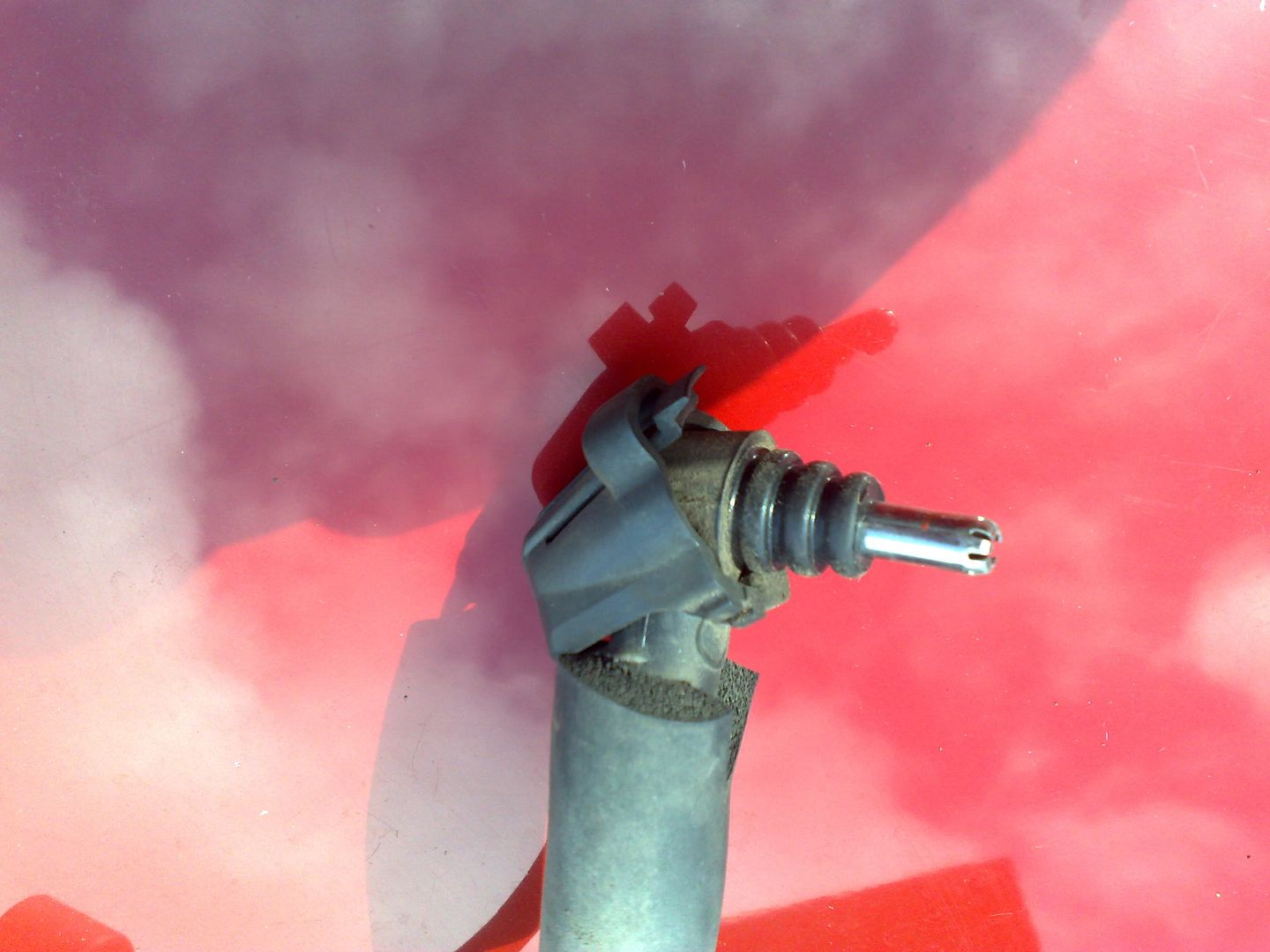

This is my current setp, its a screw/bolt on cap.
Daz

as you state it was standard when it came to you, then the ignition components would be old and probably in need of changing. was one of the first things i done when i got my rev 2!
new plugs, leads, cap and rotor arm.
