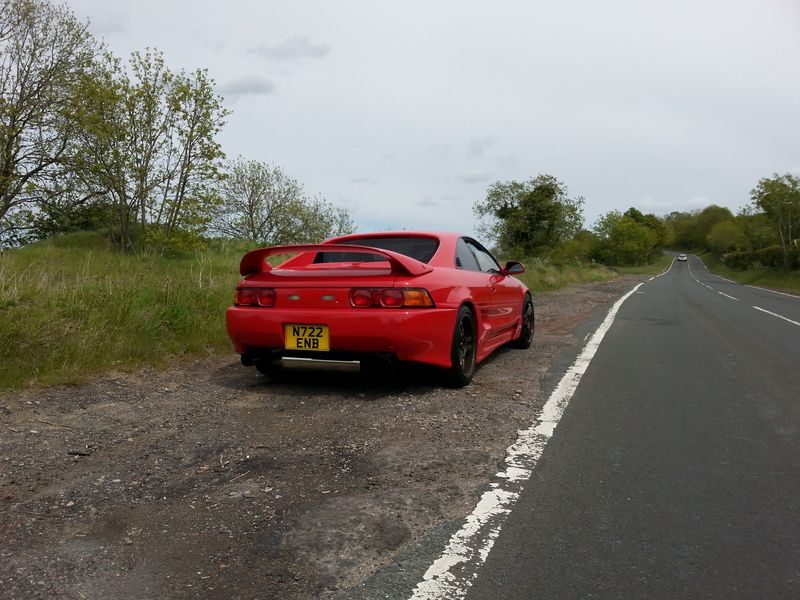

All polished up and no where to go. Until I tax it on monday that is.

Very pretty car ... keep going

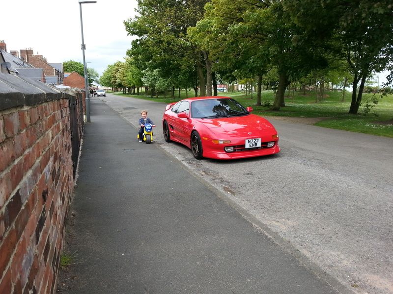

Tax today and been out for a spin with my son. Everything working as it should. Drives much better with the new coil.
Jobs to be done now, still need a decent amp, a 4 wheel alignment as Ive never got round to sorting one, although the tyres have always worn evenly so they cant be out by much if they are.
Also tempted to get the profec EBC set up on a dyno. Im sure some one with more experience will be able to set it up much quicker and better than I can, and I wouldn't mind it on a dyno just so I can be sure the car is running fine also, ie check for knock etc. Not bothered so much about a power run but would be nice if they do that also, will need to shop about round here and see what it available.
Back home with my son, needs more than that crotch rocket to make it at race wars

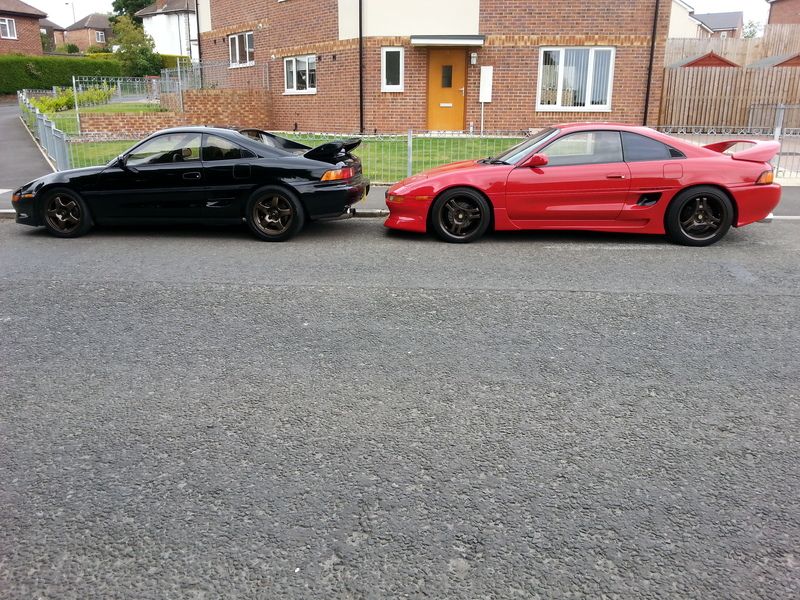

Went over outruns yesterday and did a few jobs. Not many pics by me but if outrun ever updates his thread he may break the internet. Spent a good few hours with 2 broken aerials and as usual the easy way was the right way but was done last. At least we know them inside out now. Literally.
Rechecked my timing and changed the clutch fluid on mine. No pics as doing it but as you can see its a job worth doing. Made much easier by the fact outrun has a compressor and a line vac so can just suck it straight out.
