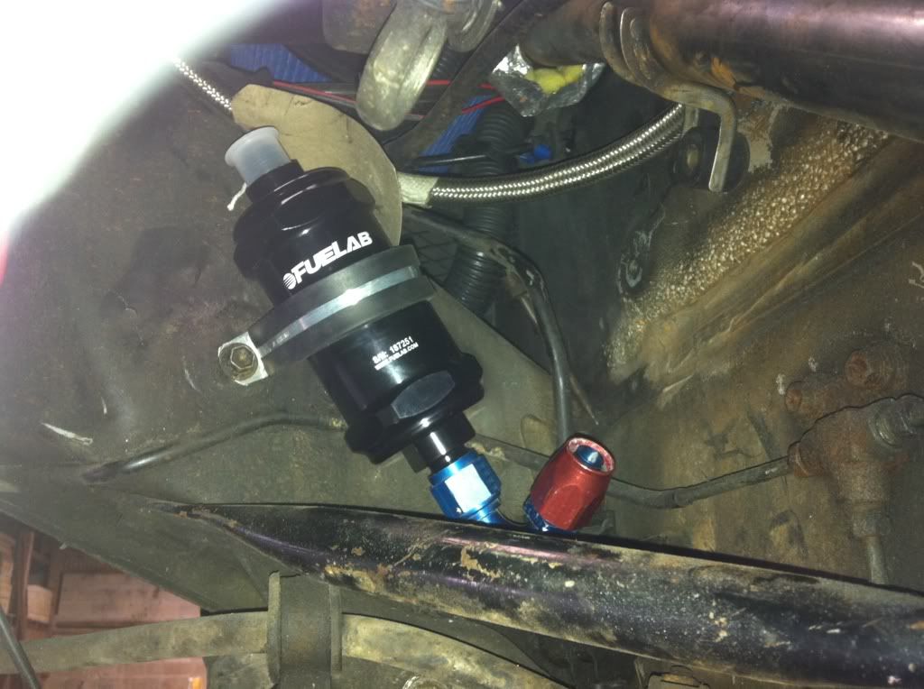

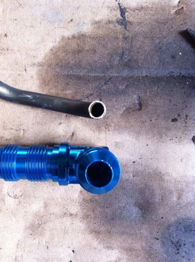

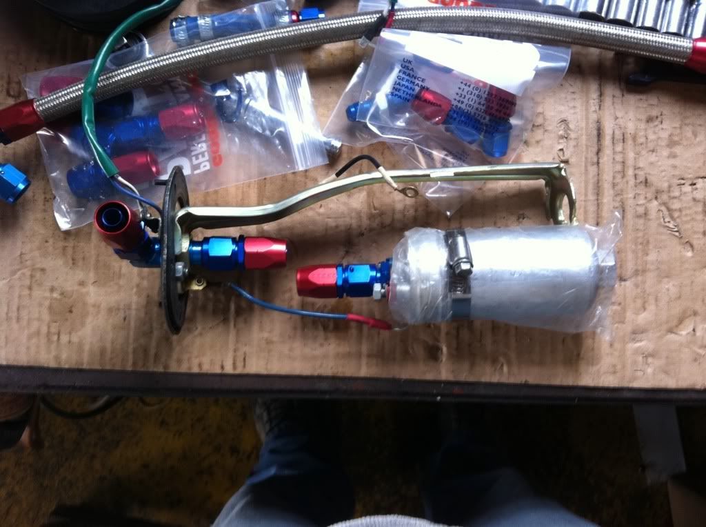

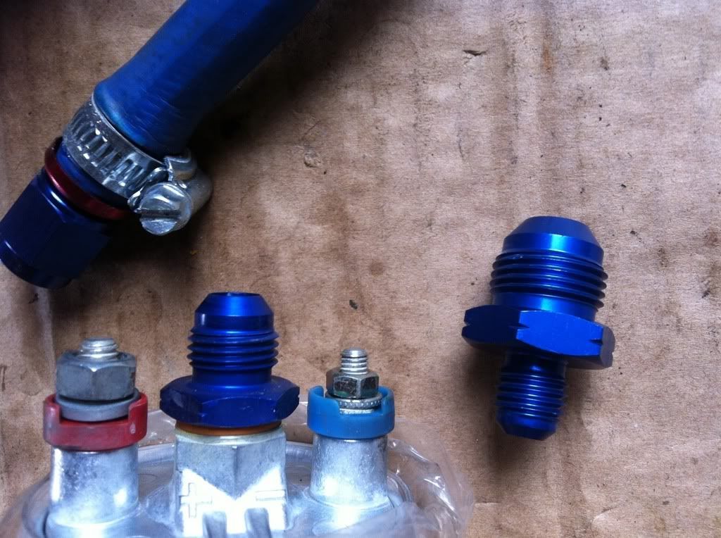

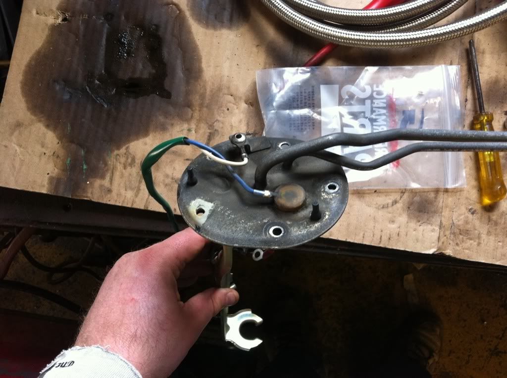

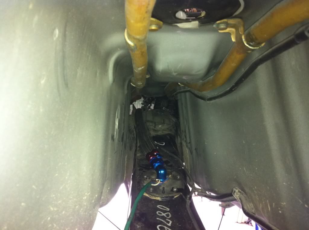

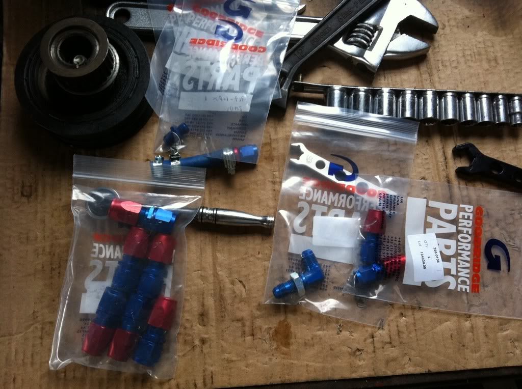

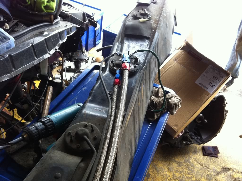

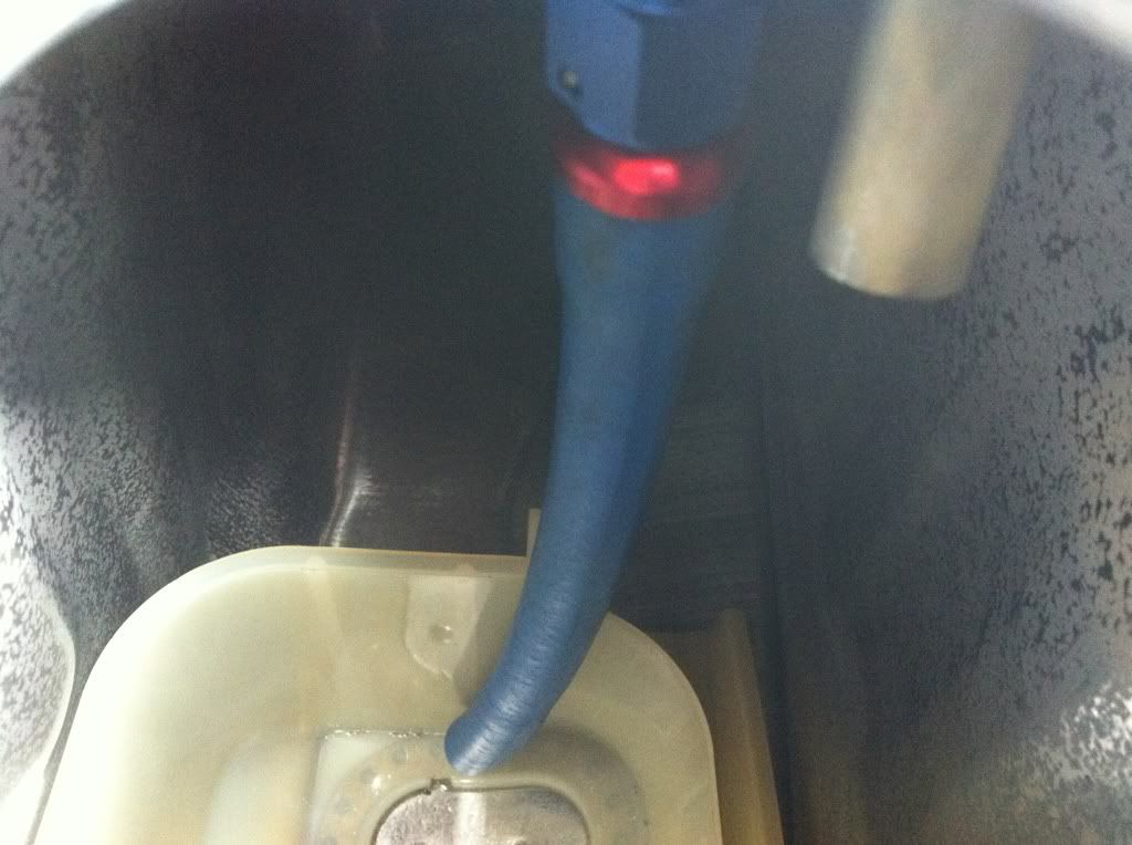

so time for the fuel tank

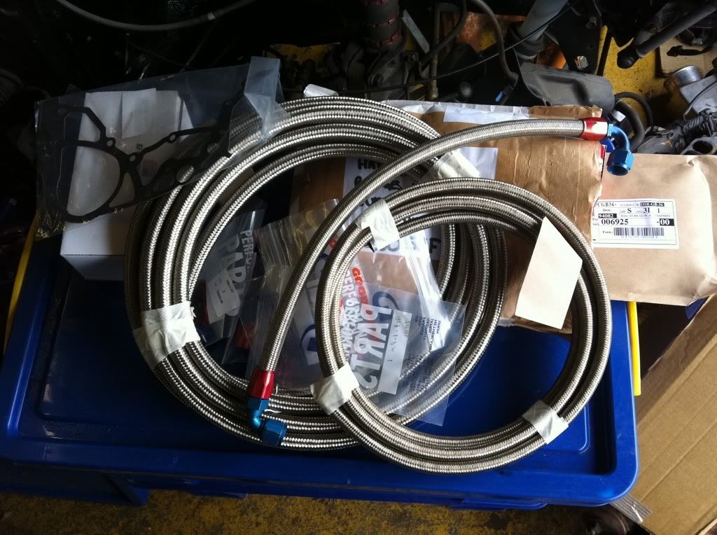

i had a bosch 044 pump in there anyway but running on stock main tank lines so these needed changing
i went for -8 flow and -6 return
bits!

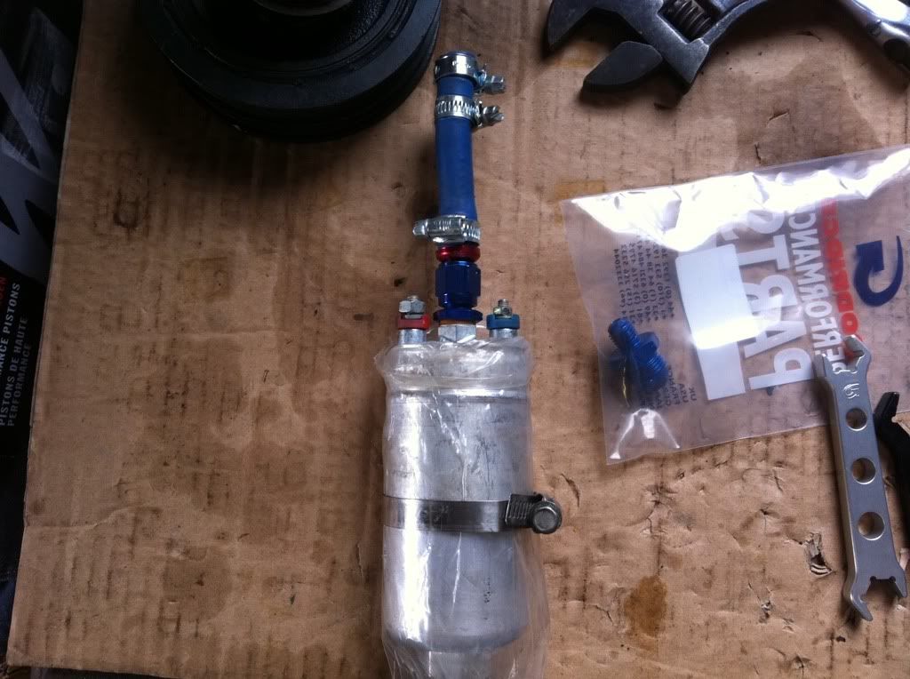

got the pump out
little bit of cutting needed to fit the bigger adapter

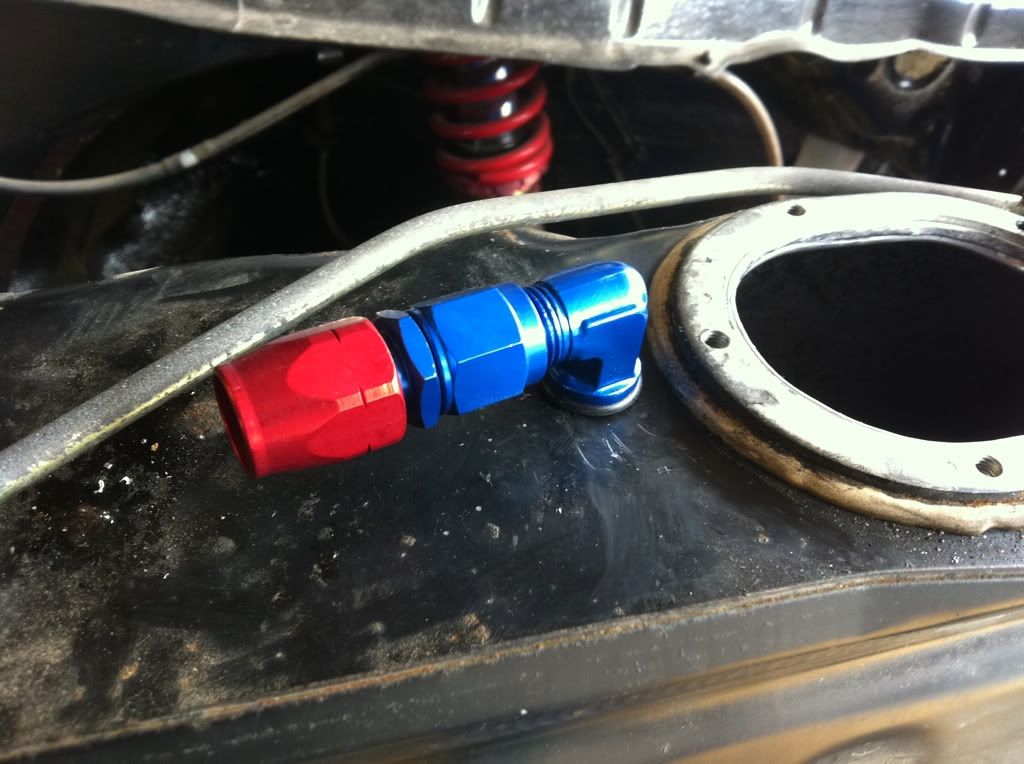

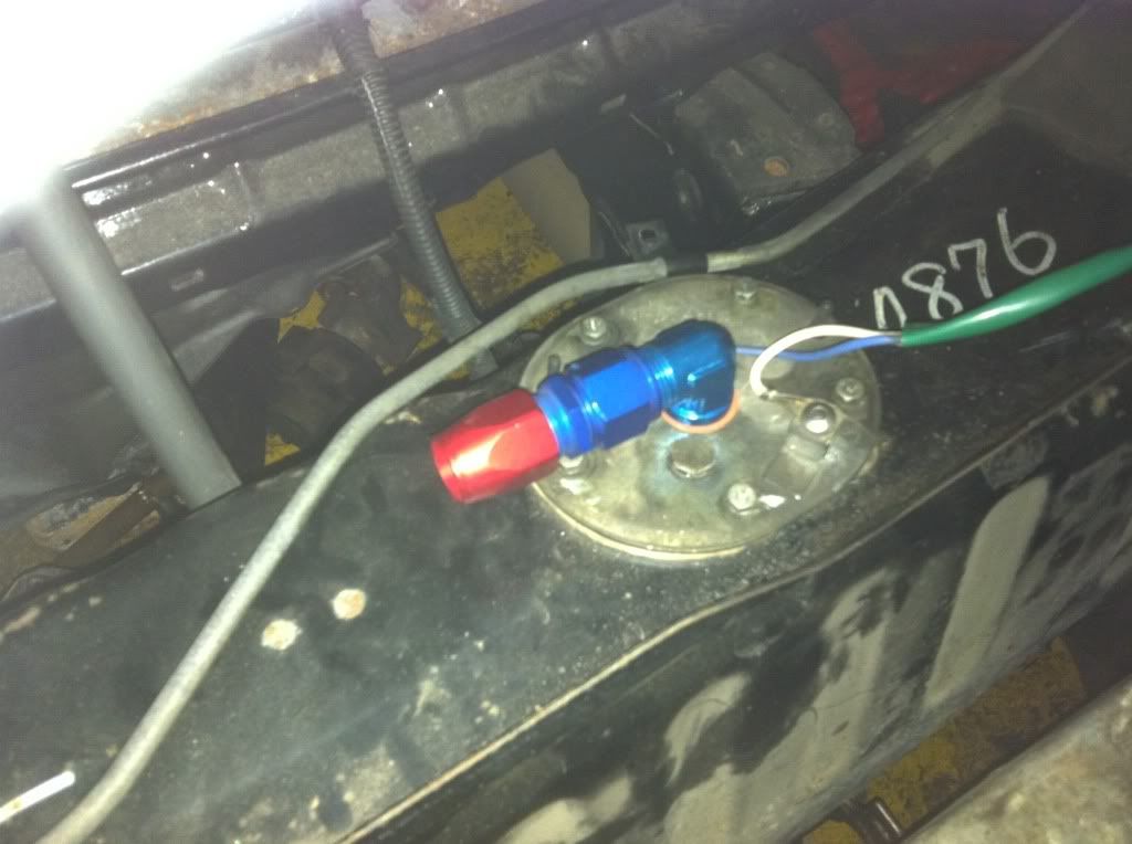

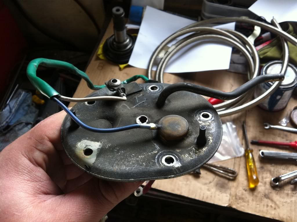

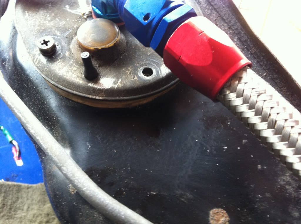

took the tank lid and cut and drilled it out for -8 elbow
put the -8 adapters on but #-o wont fit!
had to order 2 -8 push fit fittings and hose instead
-8 on the elbow
marked up the tank an drilled out for the return
return in the tank
all done ready to go back in!

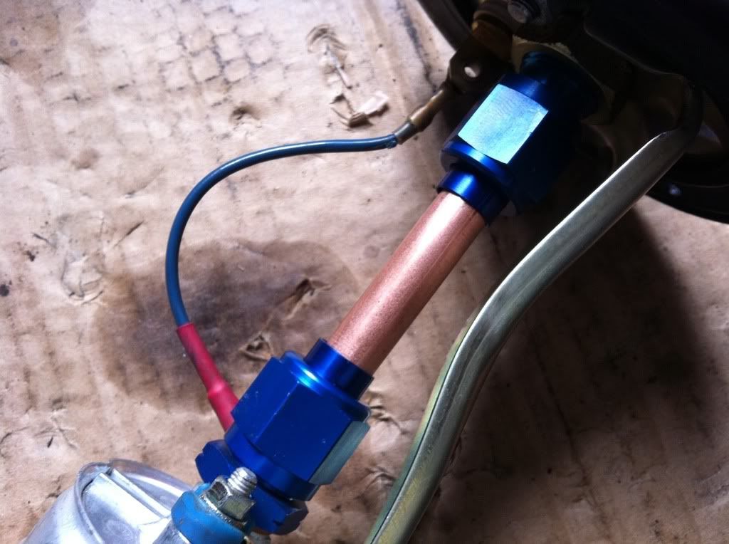

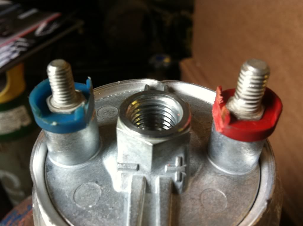

no i did'nt thats a lie! #-o
i got 2 flare fittings and flared my own pipe

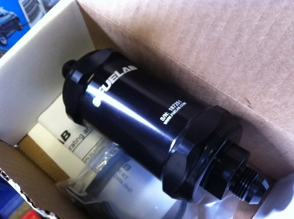

haha anyway the tank going in

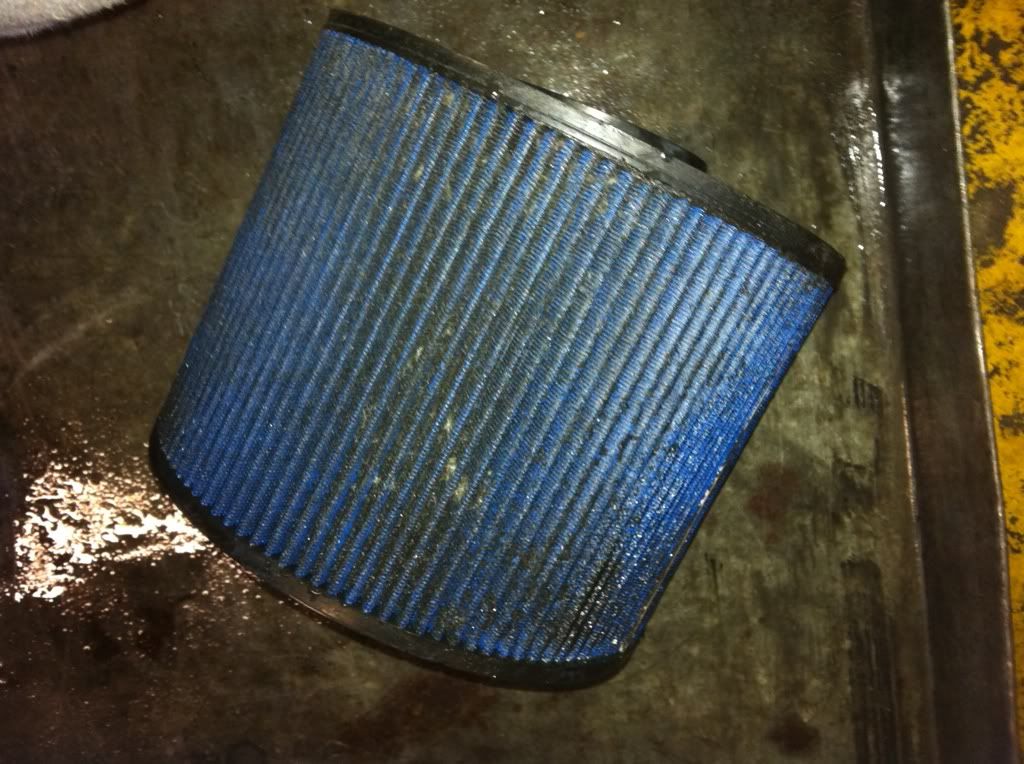

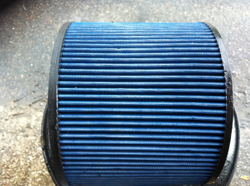

10 micron filter
Filter needing cleaning (bit random)

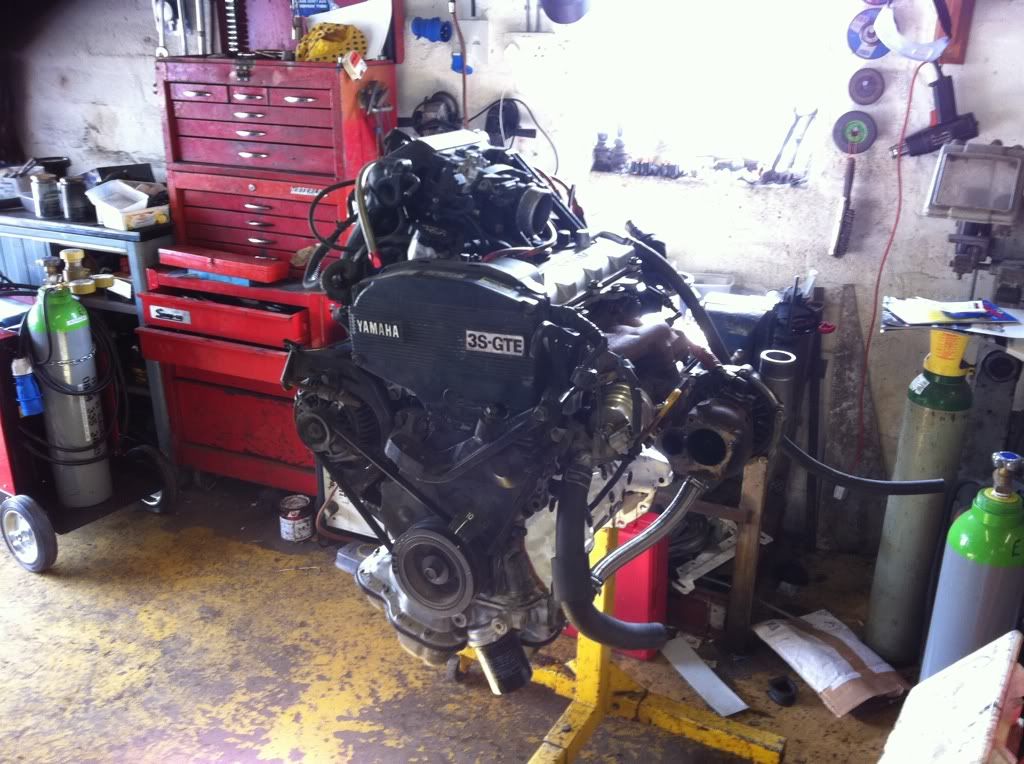

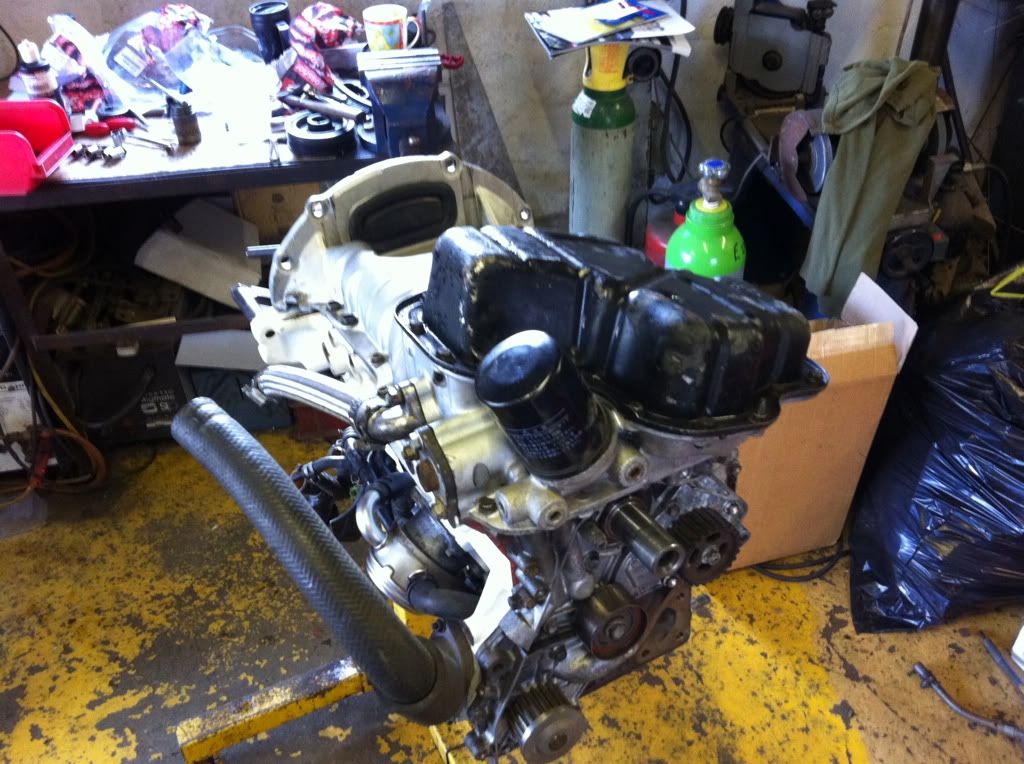

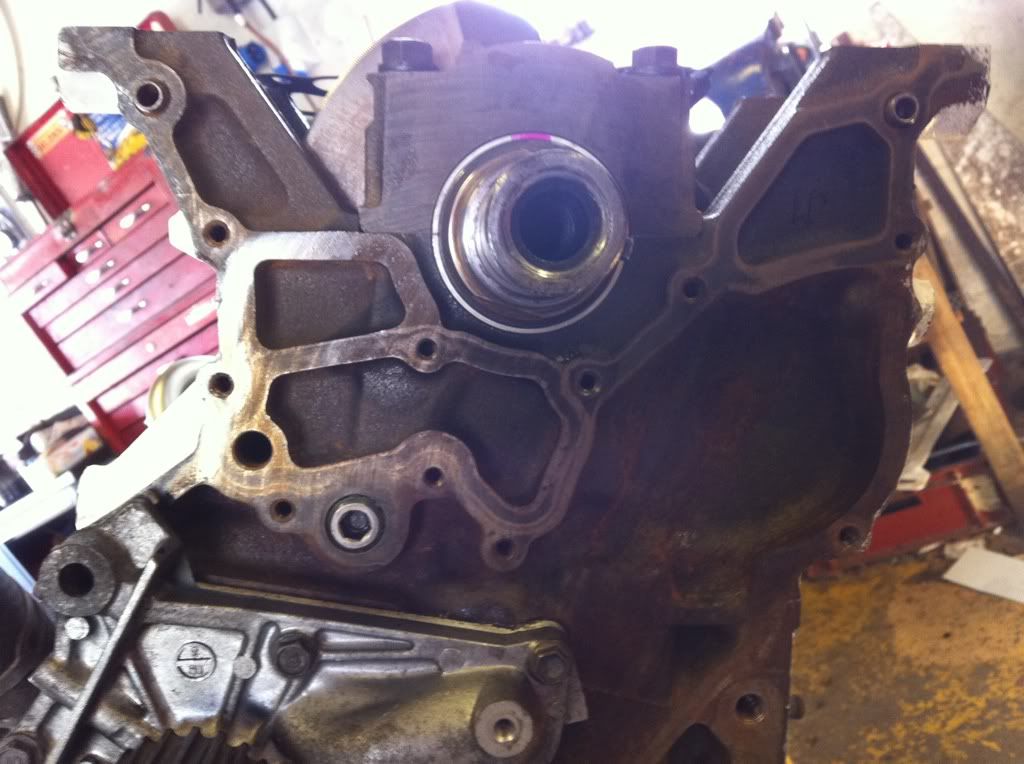

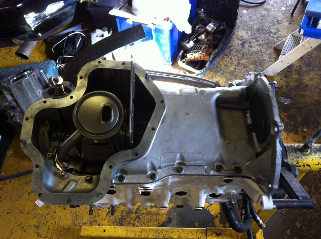

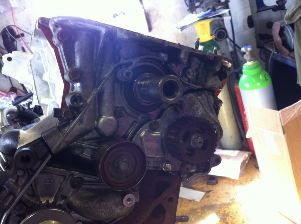

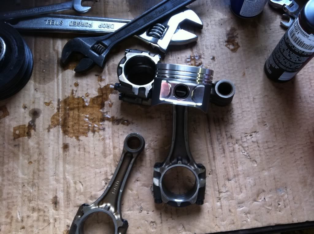

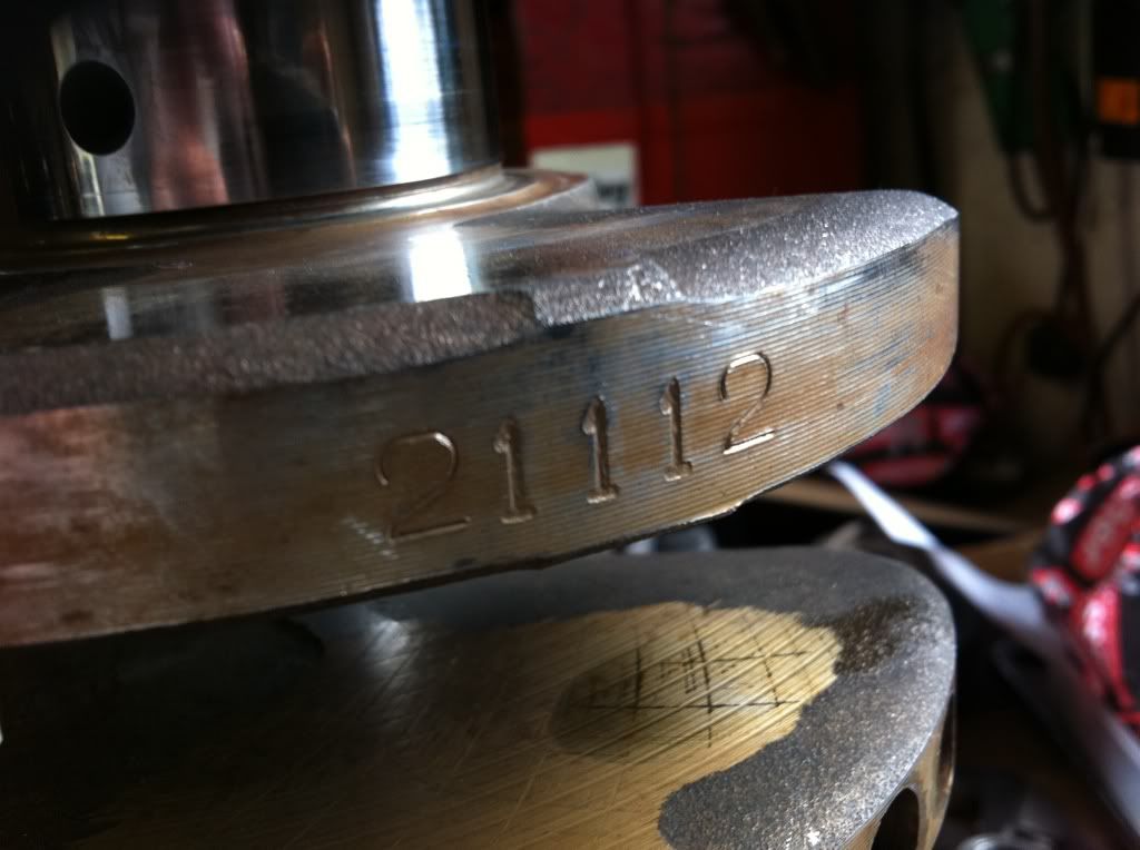

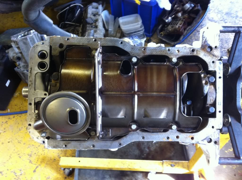

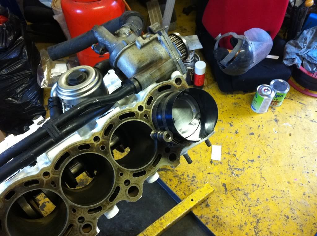

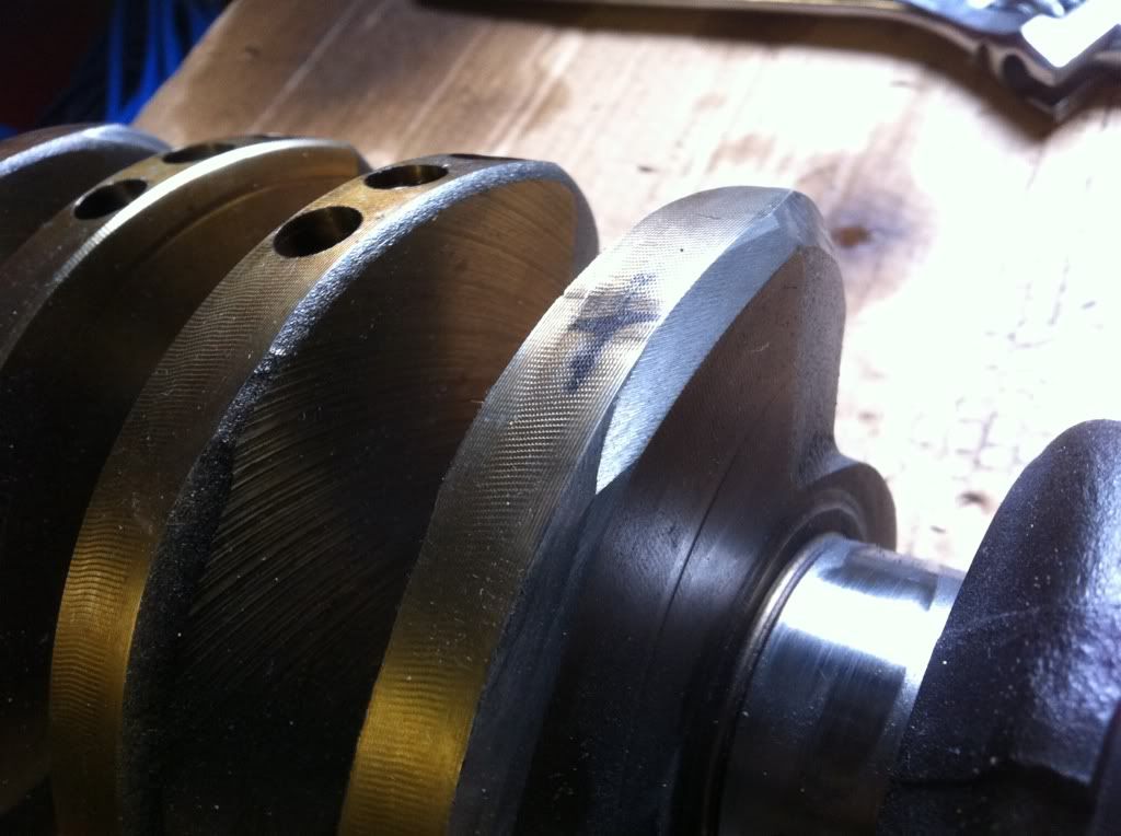

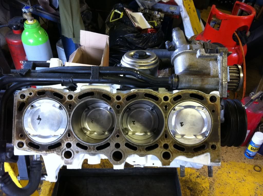

The crank and bits came back from the balancers amd the re-build continues..

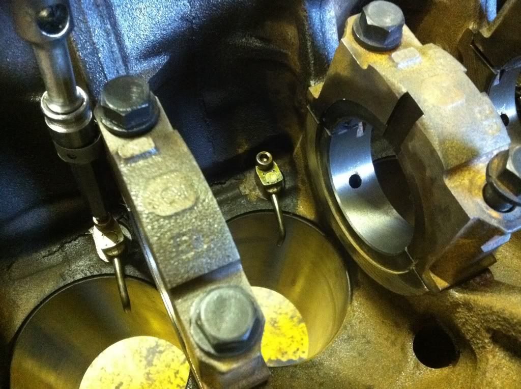

oil squirters back in
time to get the lube out!

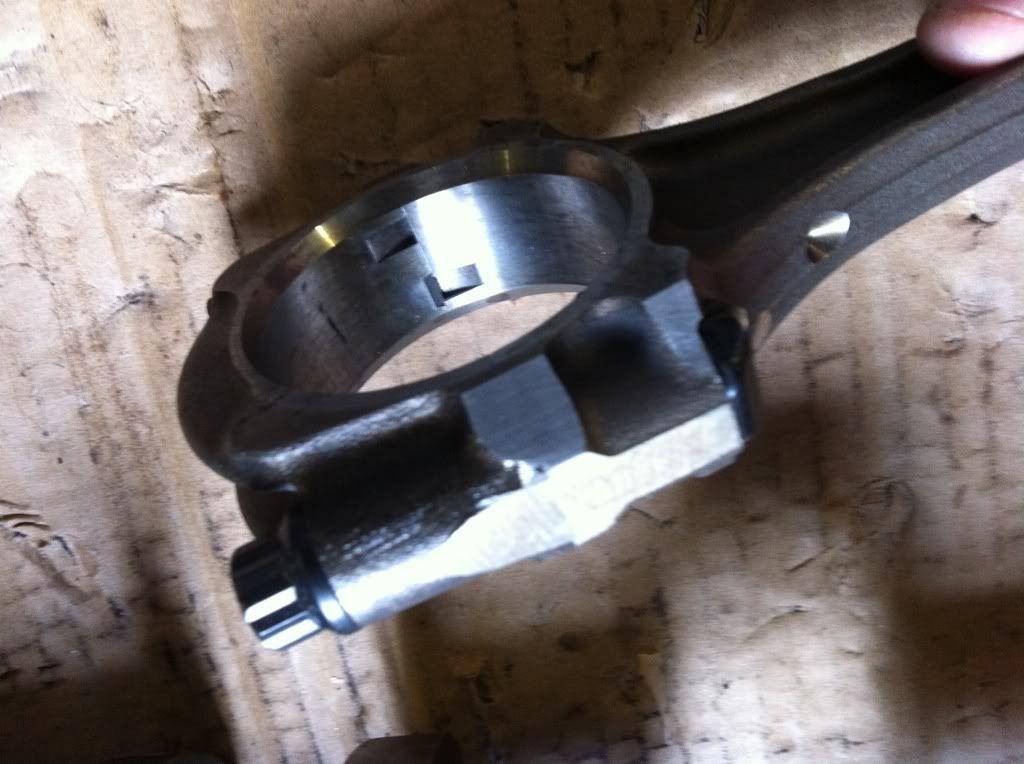

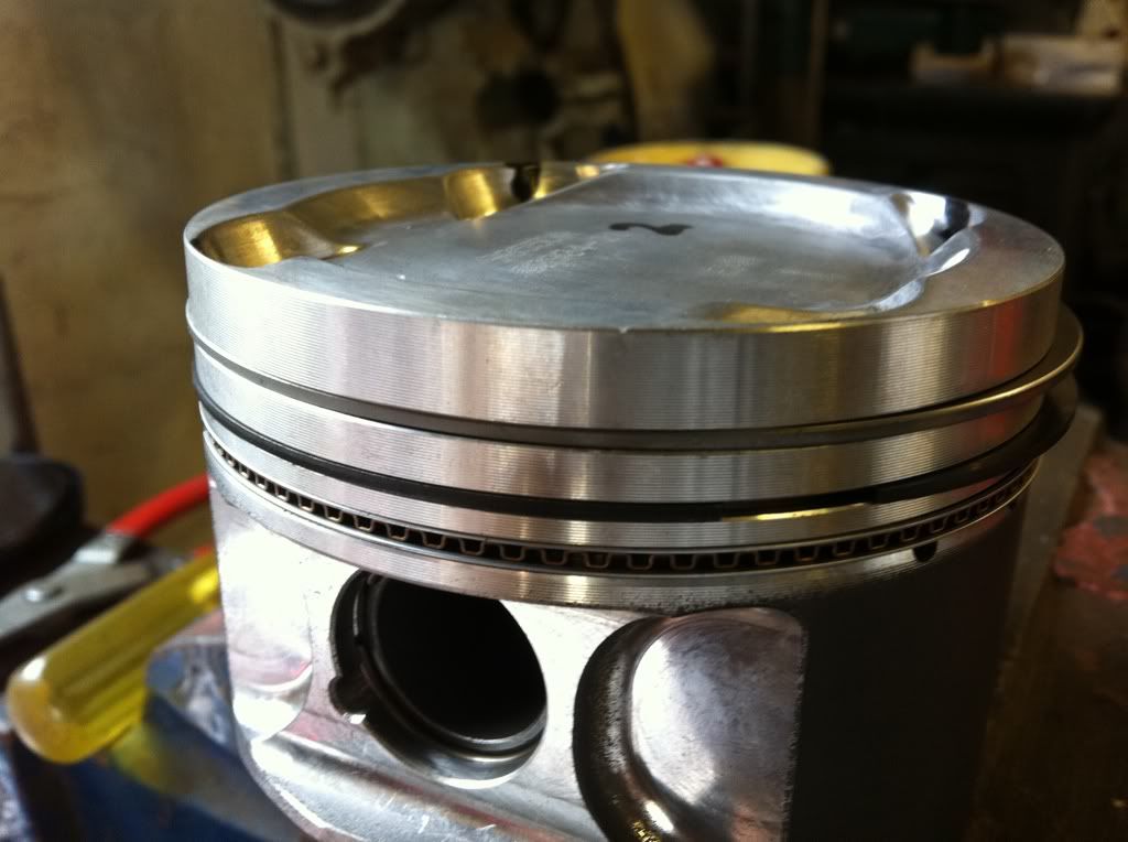

started putting the pistons and rods together

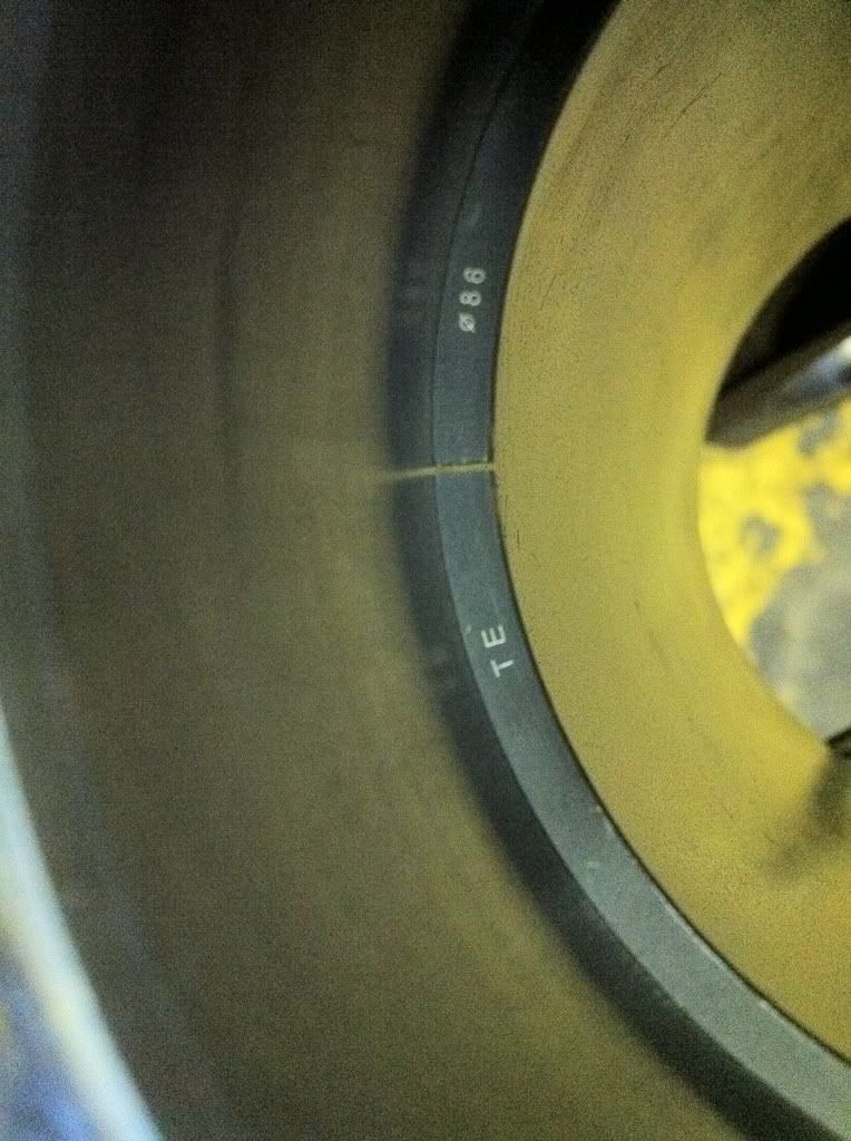

double checking the ring gaps
rings on

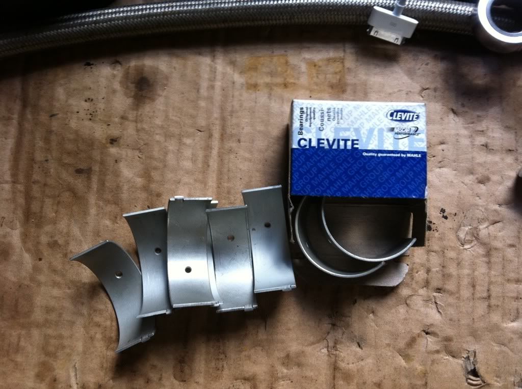

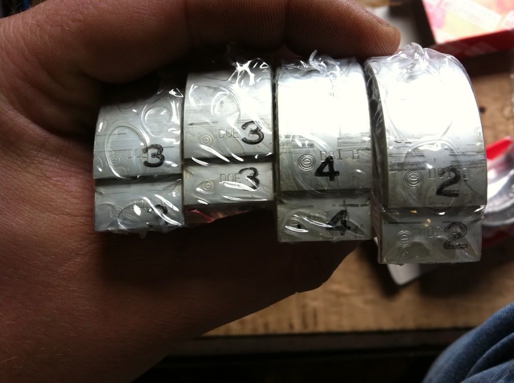

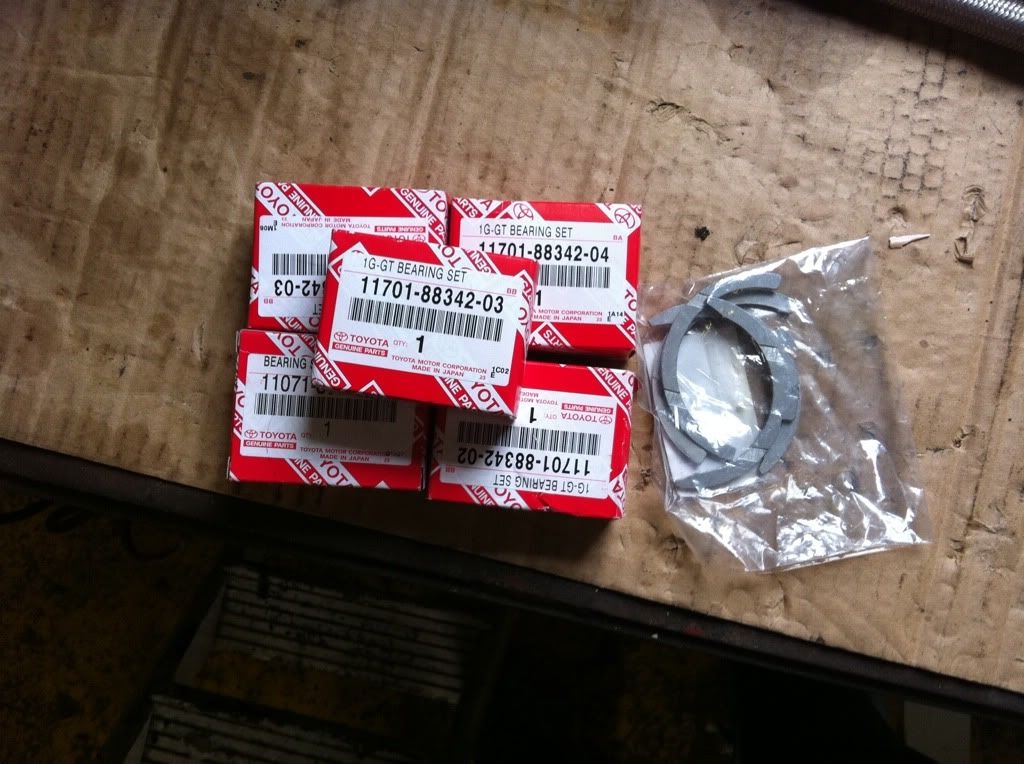

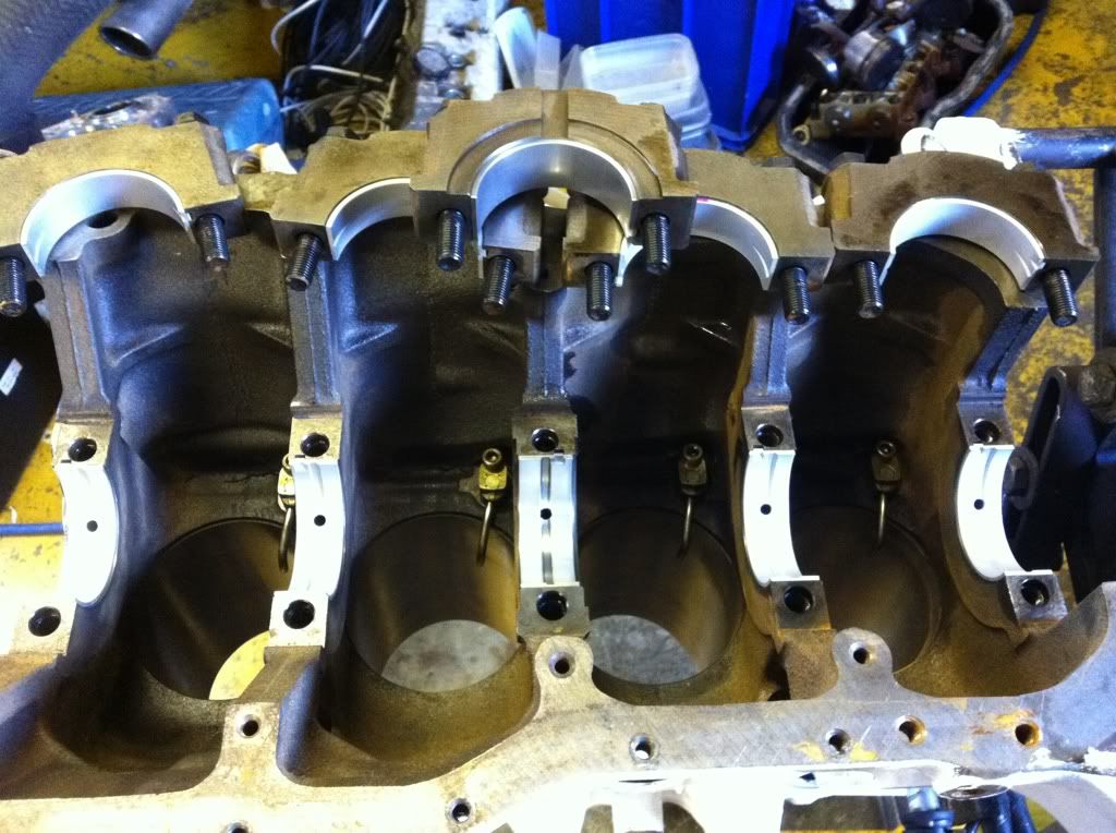

now the main bearings

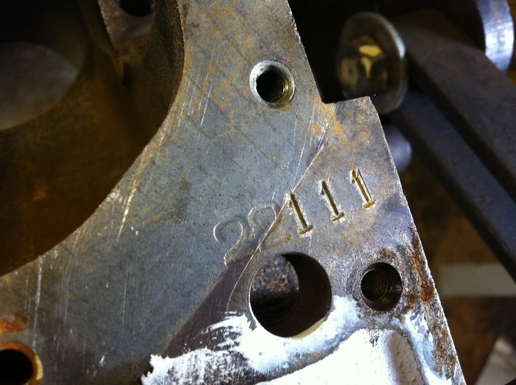

i wanted to get the bearings from toyota rather than after market ones as they are sized to the correct tolerances.
used clevite for the big ends

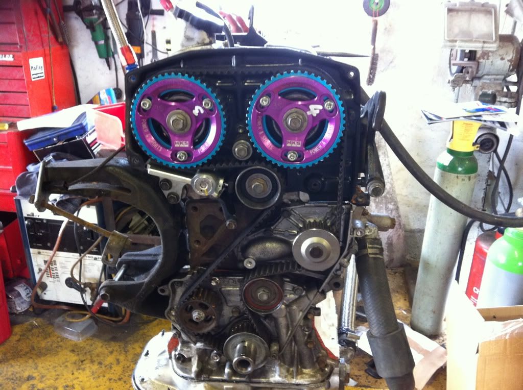

out of everything that we had balanced the hks pullys were the furthest out (not supprised tho)
Muffin!

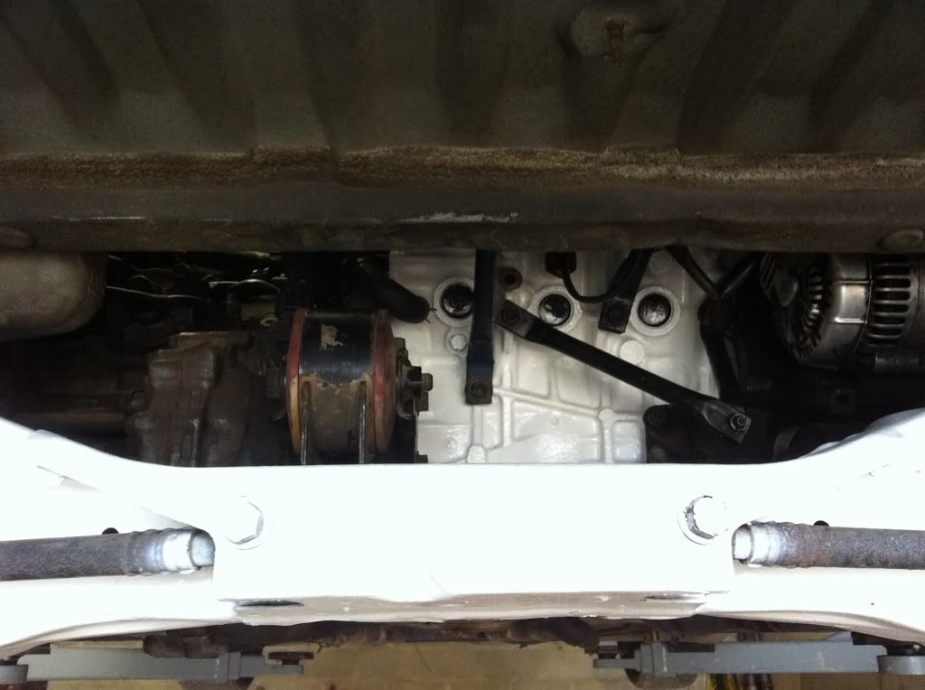

all in!

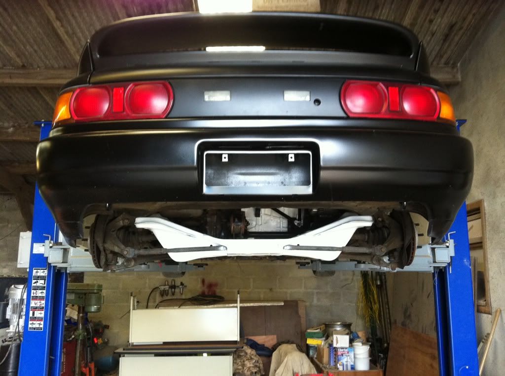

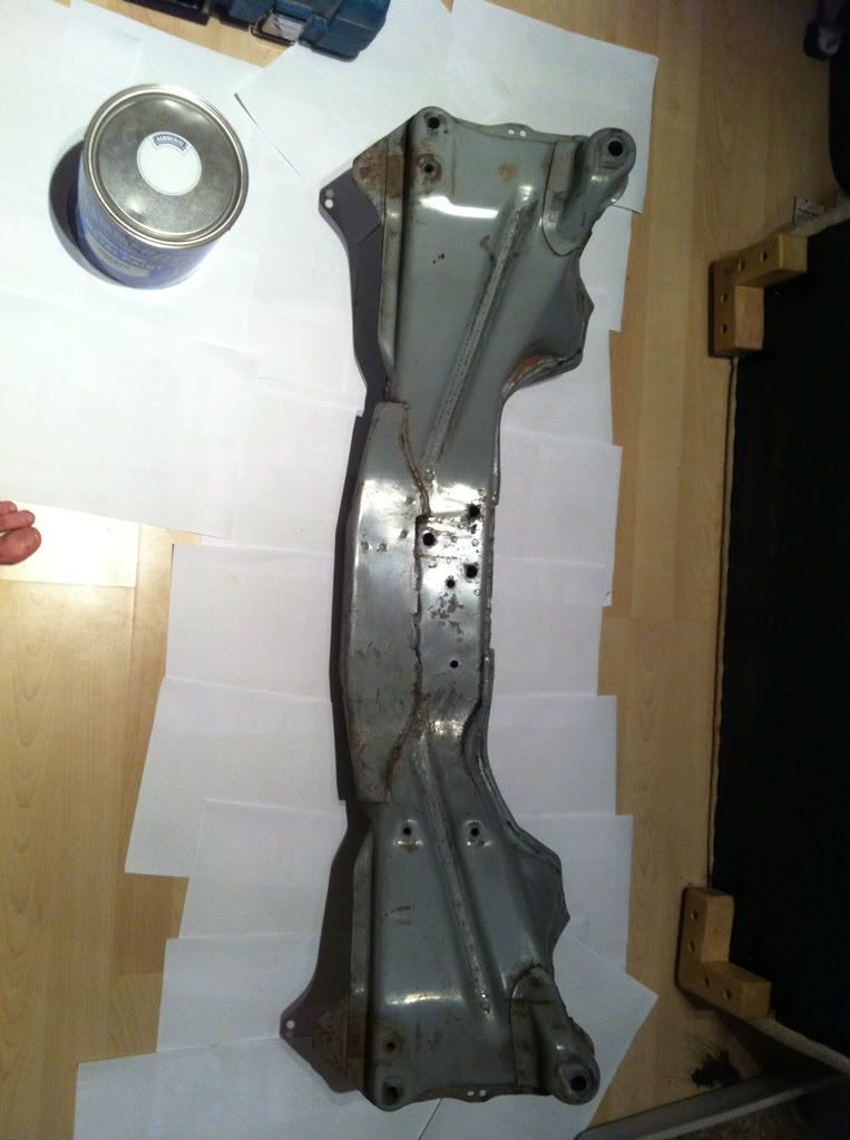

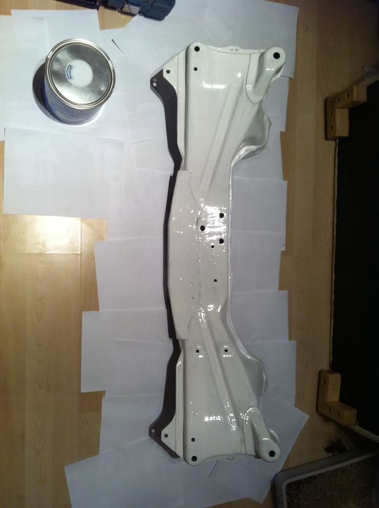

while it was out i thought the sub frame would look cool in white.

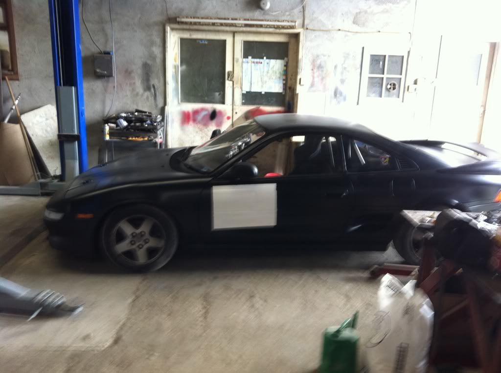

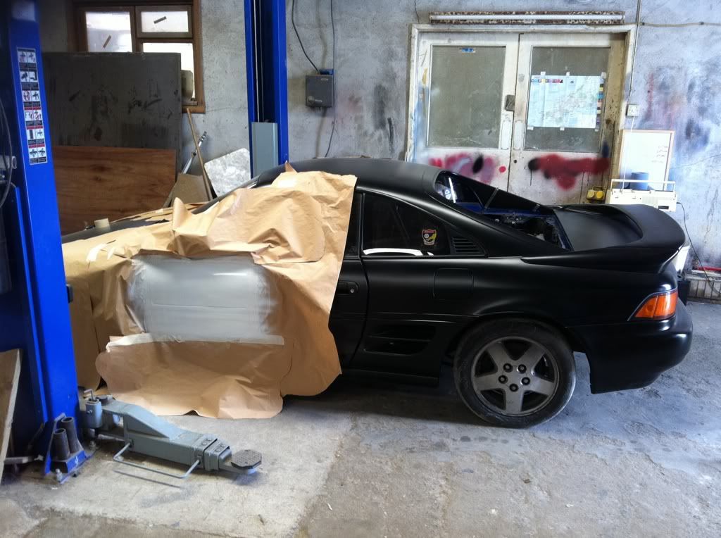

the last thing left to do before the last race was my number squares
all ready to race!!!!!

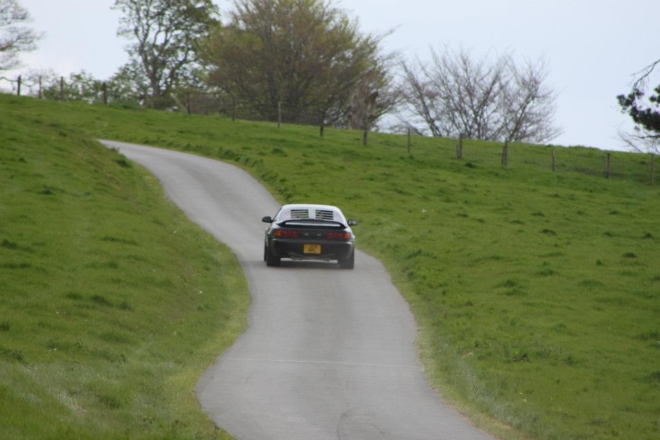

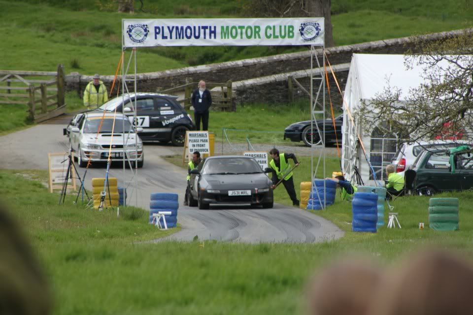

on to the first event of 2012 was werrington hill climb
this was my first time here and my god its narrow!
few pics and vids
sorry if you have seen these.
http://www.youtube.com/watch?v=u06wSvReRTI
http://www.youtube.com/watch?v=u25wPWtwbIA

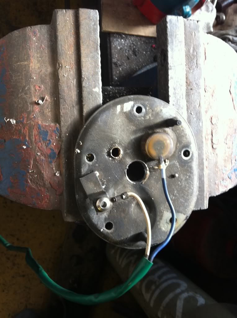

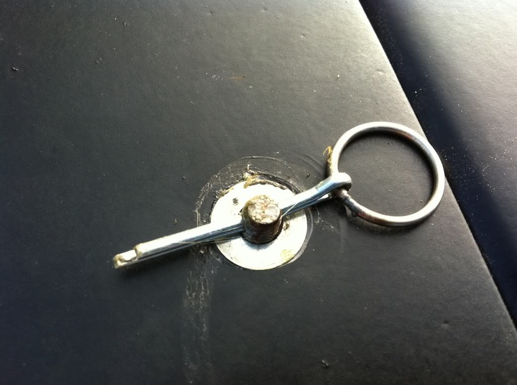

made some pins up for my engine lid
it was a pain in the ar$e undoing the bolts every time so i spun them around marked them up and drilled the holes.
i wound a ss welding rod around a drill bit cut it into circles fed through a split pin and tacked with the mig

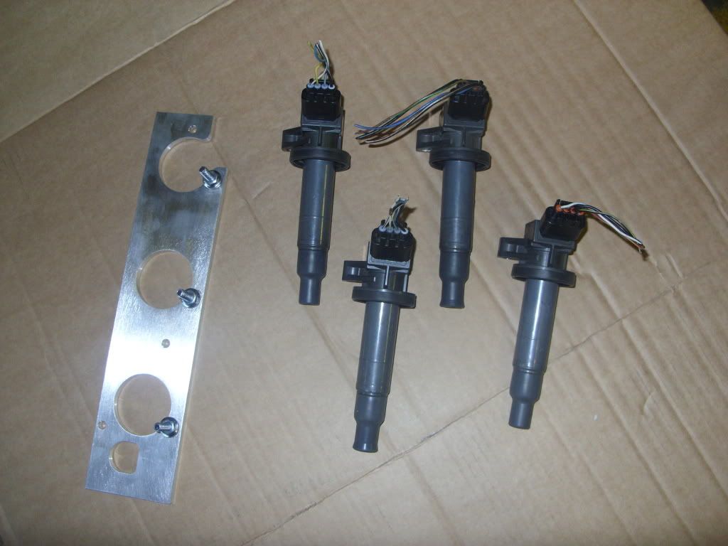

so the ride all sorted the next task is fitting all this....

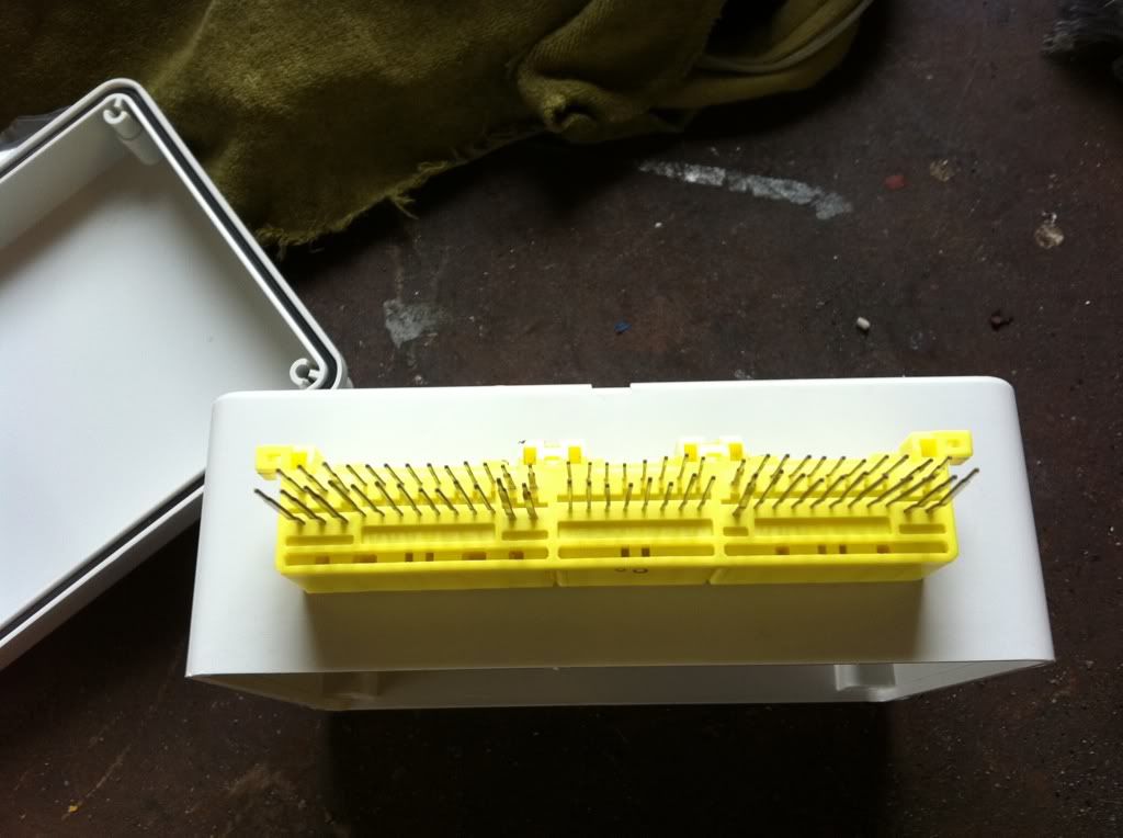

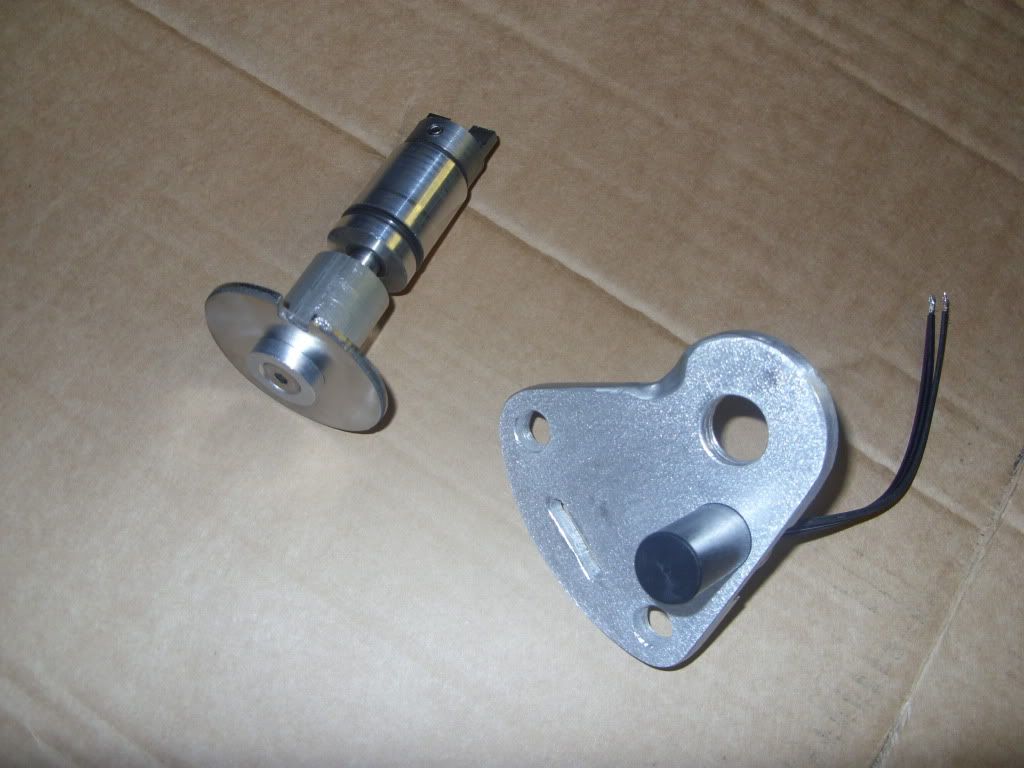

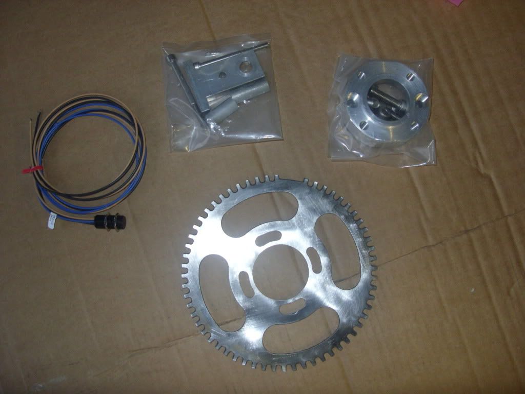

crank sensor
cam sensor
coil on plugs

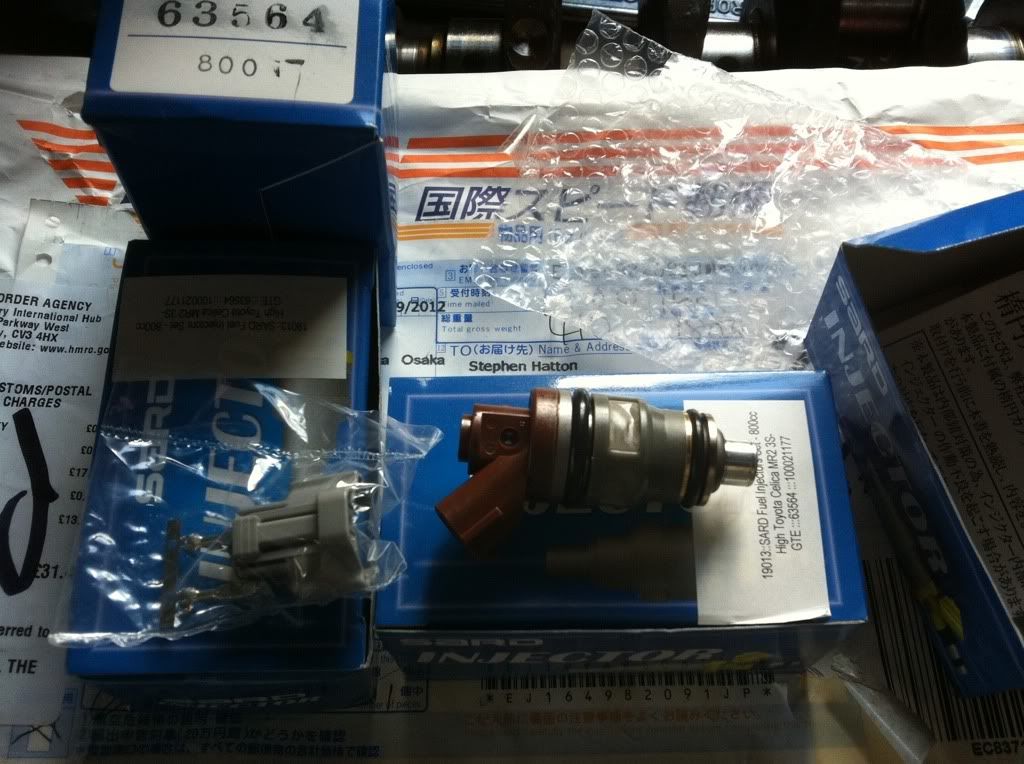

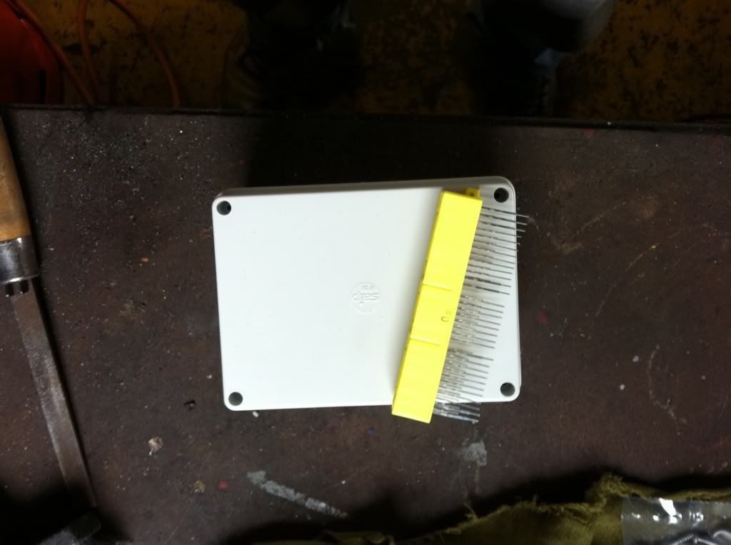

sard 800cc's
motec m84

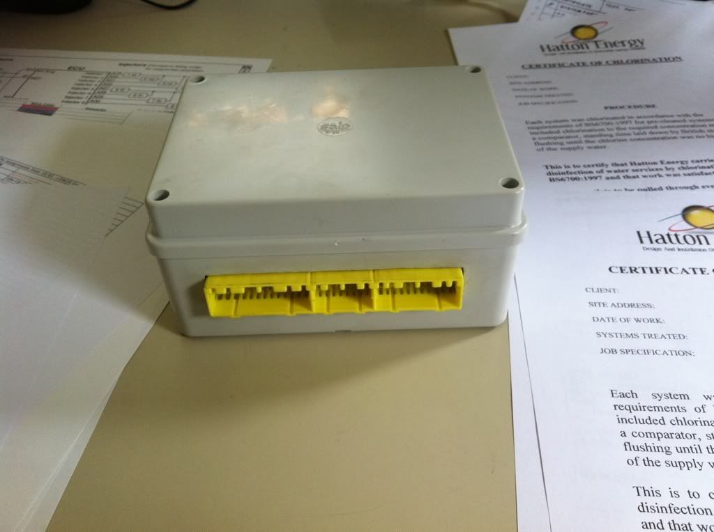

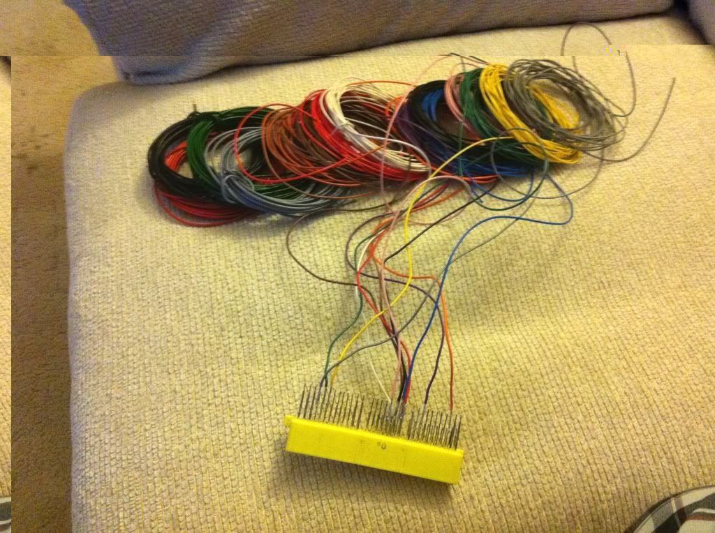

didn't want to cut the main loom so got a set of loom conectors a box and a shed load of pin locations and wiring diagrams.
and thats about it all up to date!
