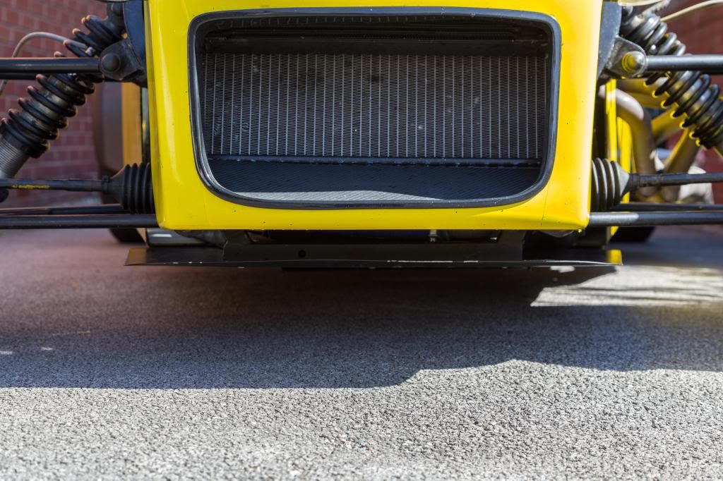

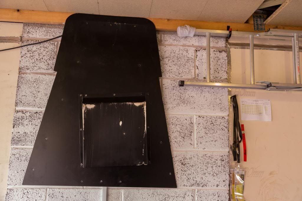

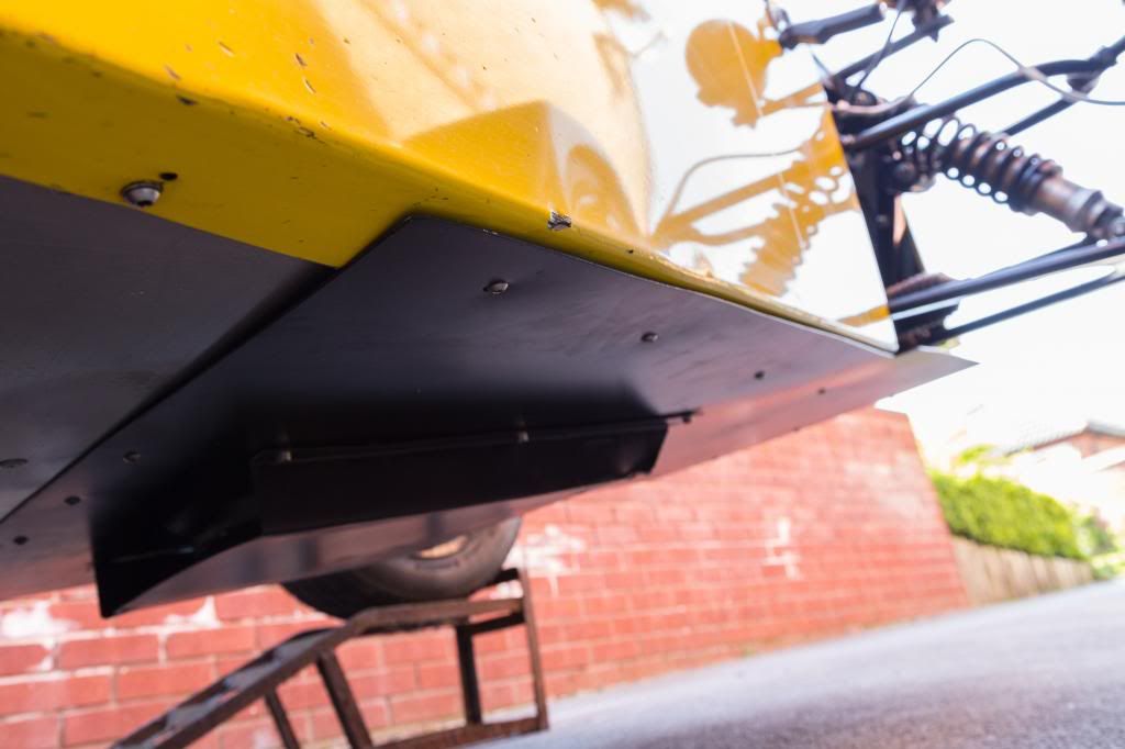

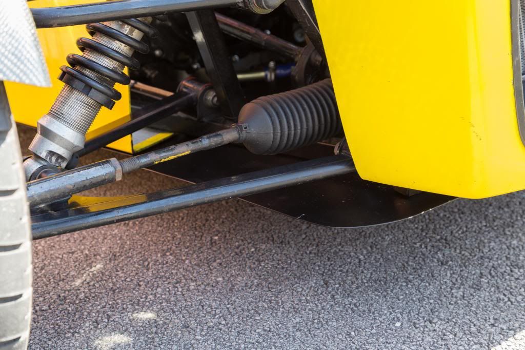

First up was fitting the custom flat undertrays which help reduce lift, especially combined with the rear diffuser. It's not secret that these Lotus 7 inspired cars have the aero properties of a house brick, especially above 70mph. Don't get me wrong though, the handling is superb. There are however a few ways you can improve things, this being one of them.

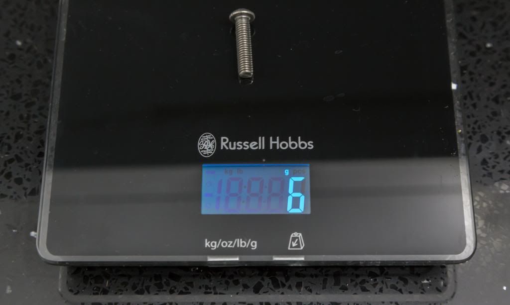

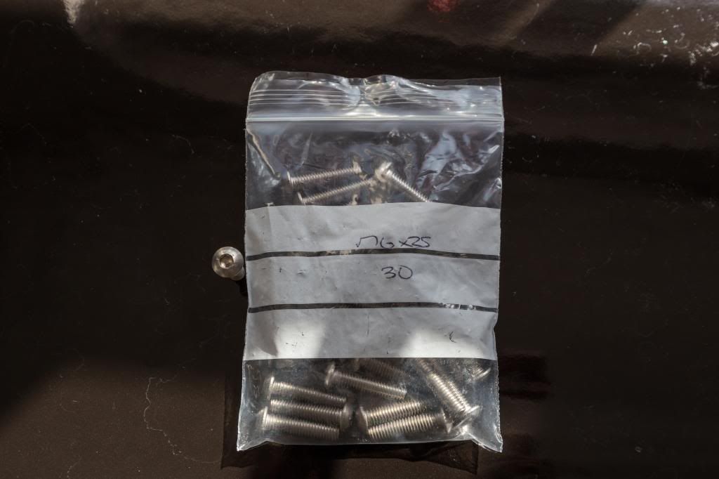

I ordered a bag of M5 25mm round headed (better for aero :wink: ) bolts. Now they've come I'm thinking they're a tad too long, so the excess is just weight in my opinion. I've ordered some 12mm bolts to replace them, however wanted to fit the tray anyway.

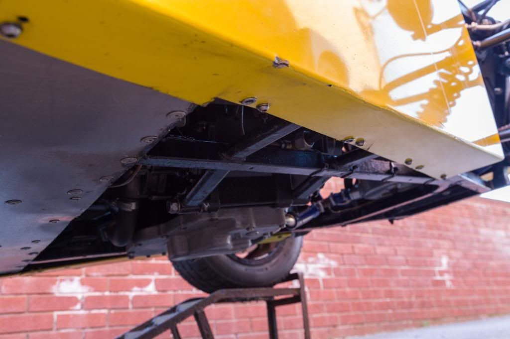

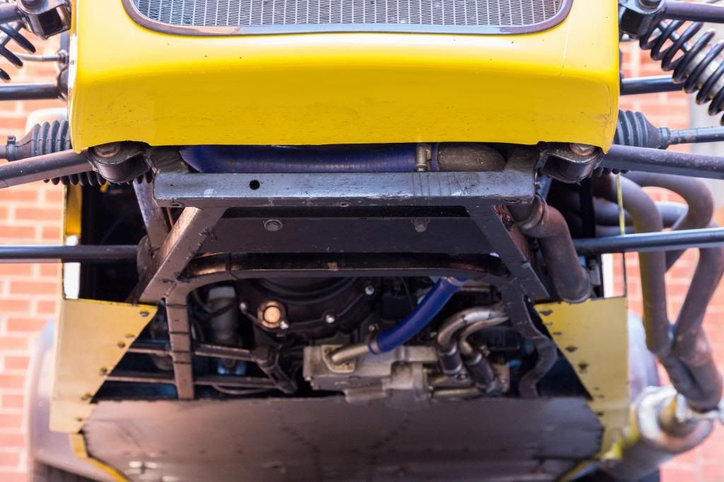

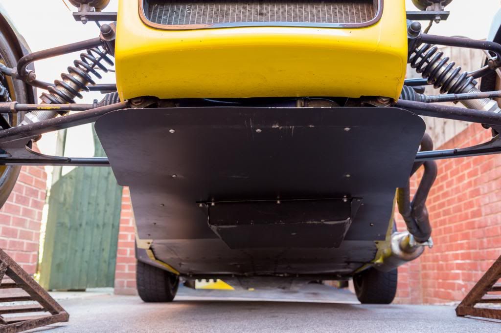

The underside of the engine bay as it stood.
Hung up, waiting to be fitted. There's a removable section where the Westfield dry sump sits. It's also vented to allow air to pass cleanly out of the bay.
Nature decided it was curious about what I was doing and offered to lend a hand :)
Fitted. Everything's nice and flat under there, which will reduce the parachuting effect the cars have by default.

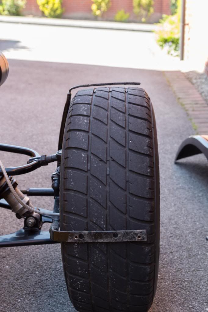

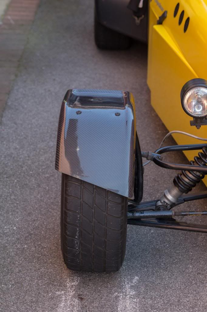

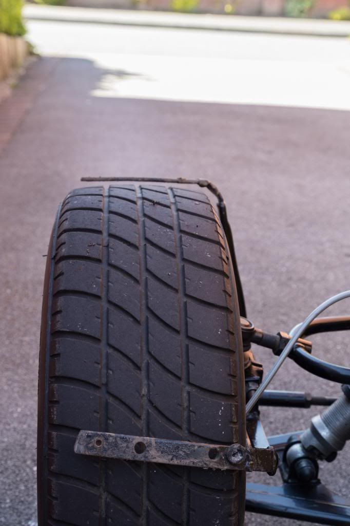

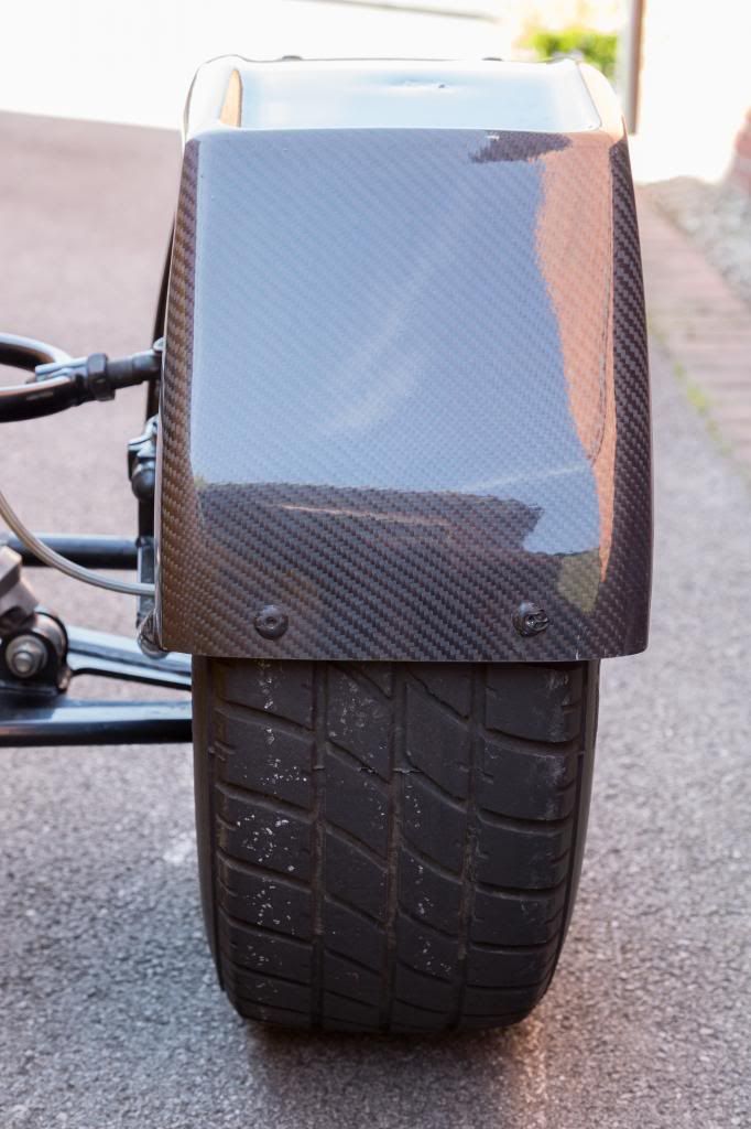

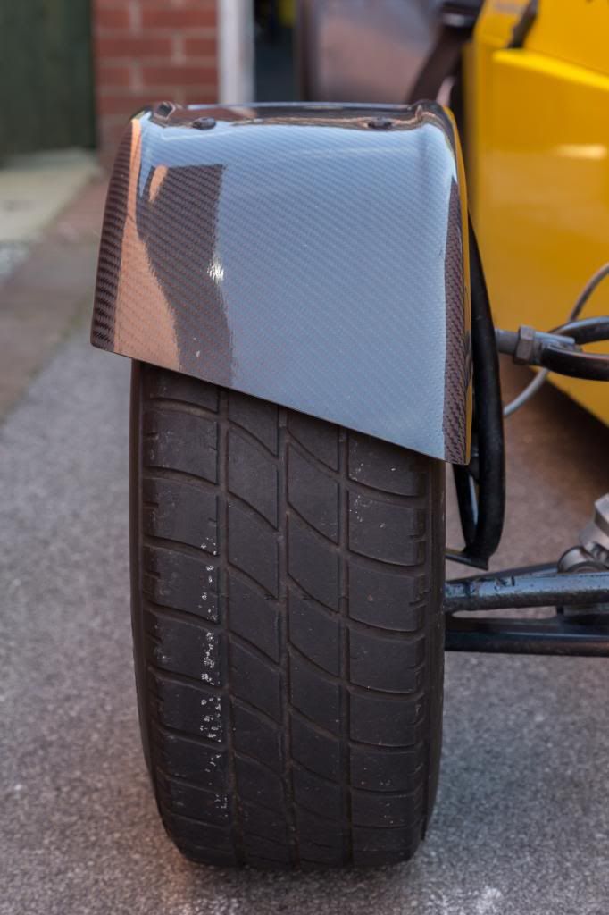

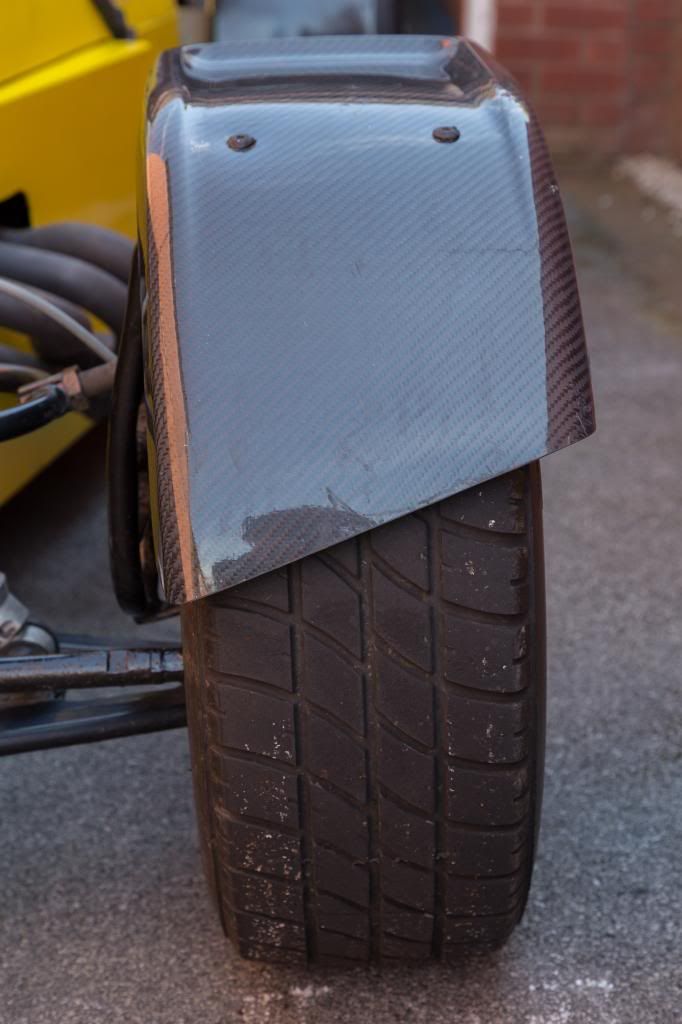

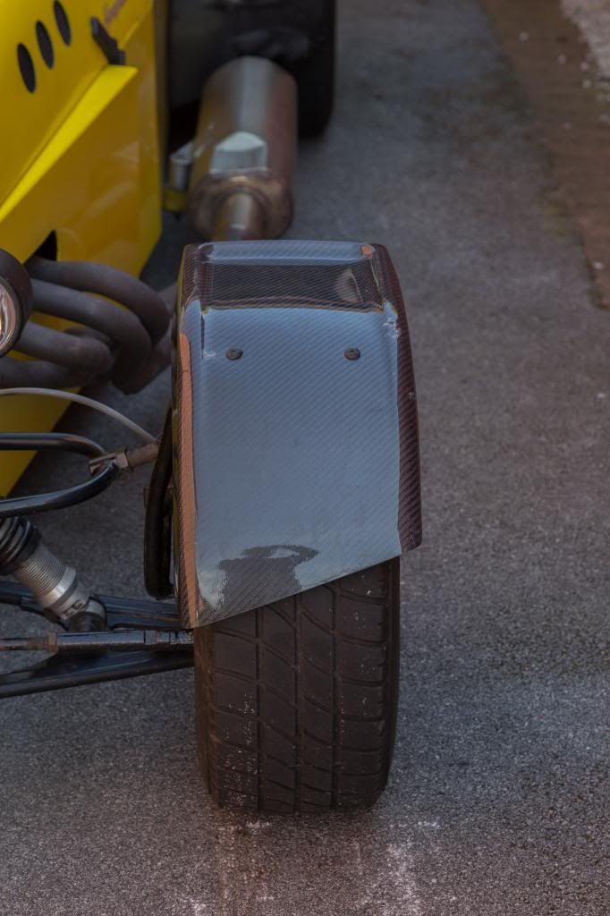

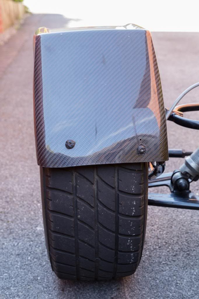

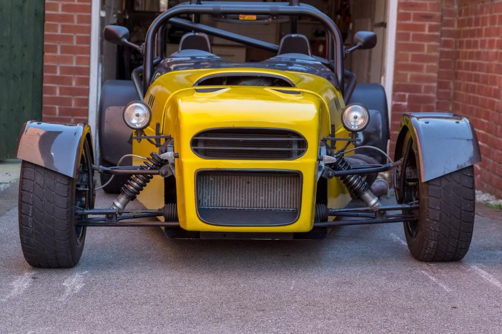

Next up was to sort the NS front wing, as it had been knocked out of line during a meeting of car and cone at Blyton. No damage to the wing itself, the beauty of carbon fibre, however the mounts were slightly on the p***......
OS wing front
NS wing front
OS wing rear
NS wing rear
Not much clearance under there, so it has a habit of collecting stones and making a good awful noise :lol:
Some persuasion later..
Not perfect but much better. I'll need to whip them off and get it in a vice to get it spot on. It's close enough for now though :)

Mr Obsessive weight weeny ( see the green hornet thread its well worth a read ) why didnt you order aluminium or titanium round heads for that undertray fitment? Those stainless ones are well lardy :clown:
Magic Beans
Posts: 4793
Post by Magic Beans »
slipping clutch wrote:Mr Obsessive weight weeny ( see the green hornet thread its well worth a read ) why didnt you order aluminium or titanium round heads for that undertray fitment? Those stainless ones are well lardy :clown:
That was my original intention, however at a total cost of £30 as opposed to £3 delivered I decided I couldn't justify it for about 80g. I could not have a glass of water before taking it out and save 4 times that :lol: The 12mm ones will be lighter :wink:

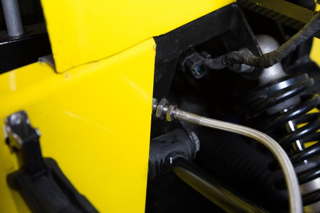

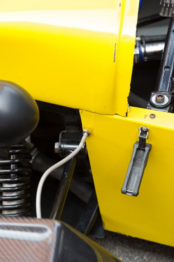

Another one of the snagging list ticked off...

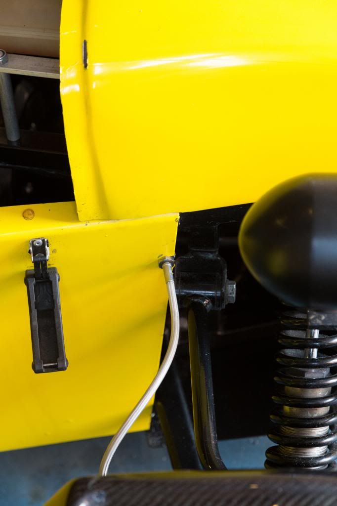

The braided lines and the copper lines they married up to were attached to the frame on the copper side, however the braided side wasn't secured to anything. Time to change that..
As it was.
A quick session with Mr Dremel and Mr Spanners later.
