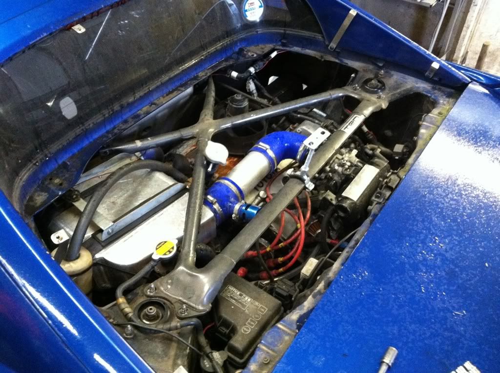

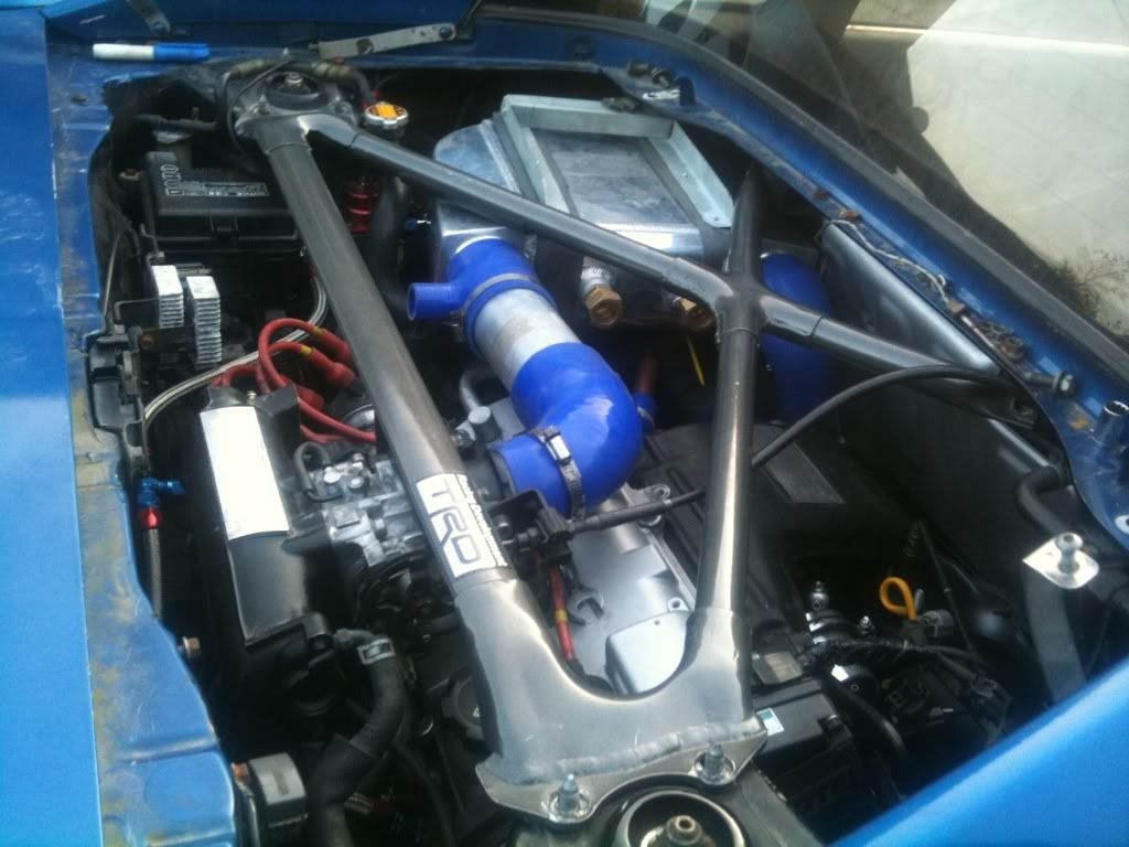

charge cooler is now in
note the trd braces from Mattymr2. cheers!
as we had no idea what the stock boost would be or the mixture so i fitted these along with a switch for the cc pump. also fitted my manual boost controler where the cig lighter was
this is how it looked all piped plumbed and ready to go

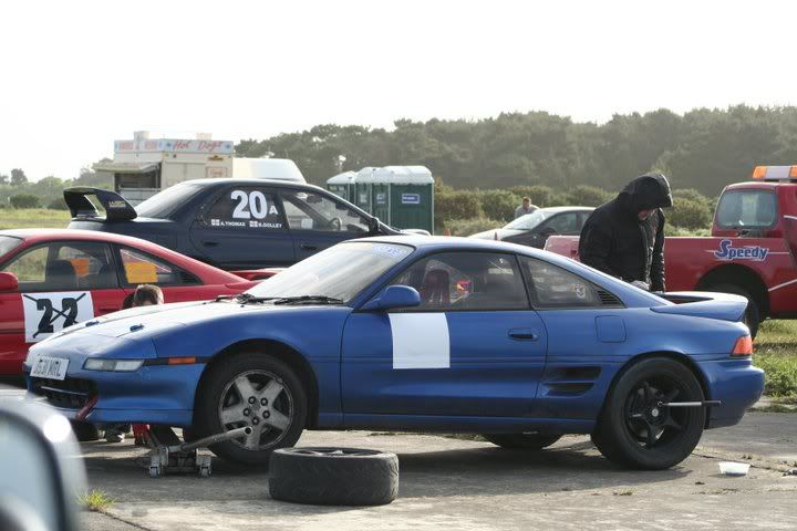

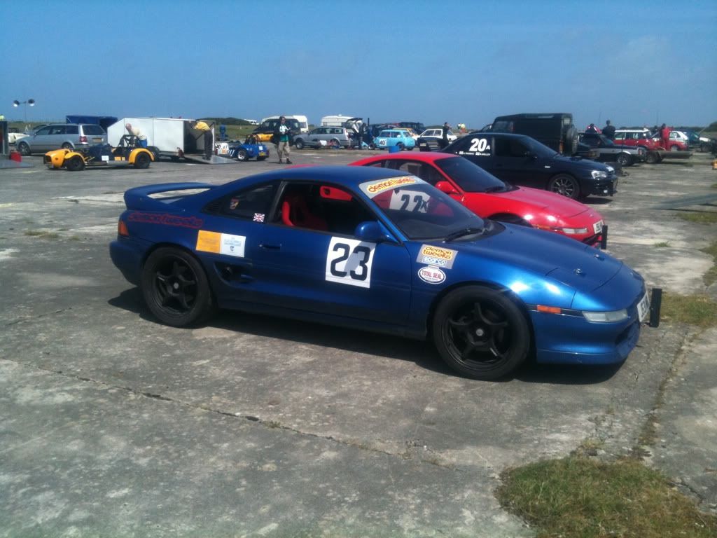

so all running and at the first race meeting ready to go
all stickered up for the first run
this was my fastest run of the day my first event in the car and beat my personal best and won the class by a 5+ seconds

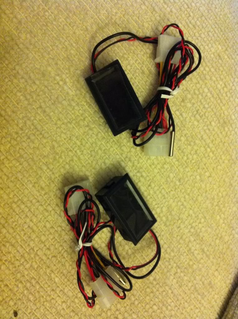

so having a bit of time between races i bought these to see how well the charge cooler was working
they work very well.

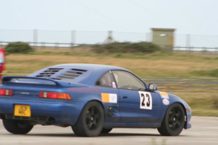

few more pics from the season
well that was the end of 2011 season and my first full season.
the hillclimb side of things didn't go as well as the sprints due to various problems.
but the sprints went better than i could have wished
i won every event in this car getting the overall class win and finishing 2nd in the cornish sprint championship and 7th in the overall championship.
Also setting 2 class records and getting the 2nd fastest time of the day at portreath sprint across all classes

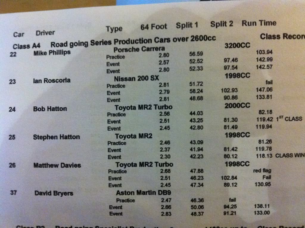

your fastest time 119.42
my fastest time 116.36
3.06 seconds thats not 75bhp difference................................ thats Talent!
118.13 was your best on that day and I was faster on the first run. I would have been up with you if I had not gone onto the grass to miss that rabbit

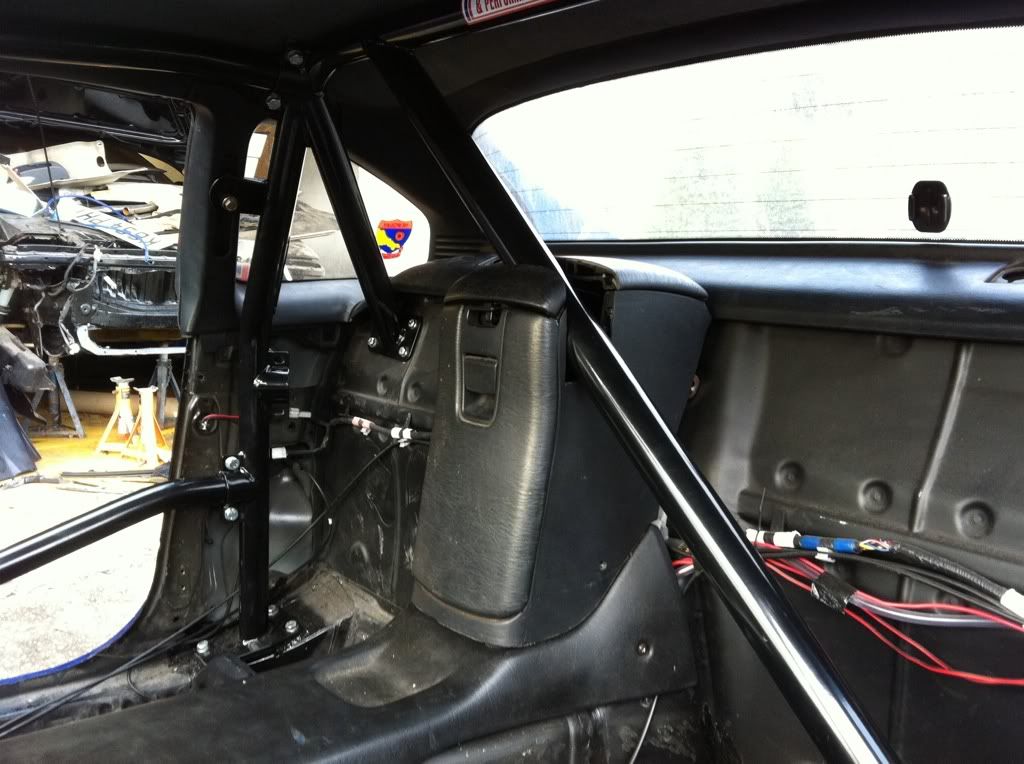

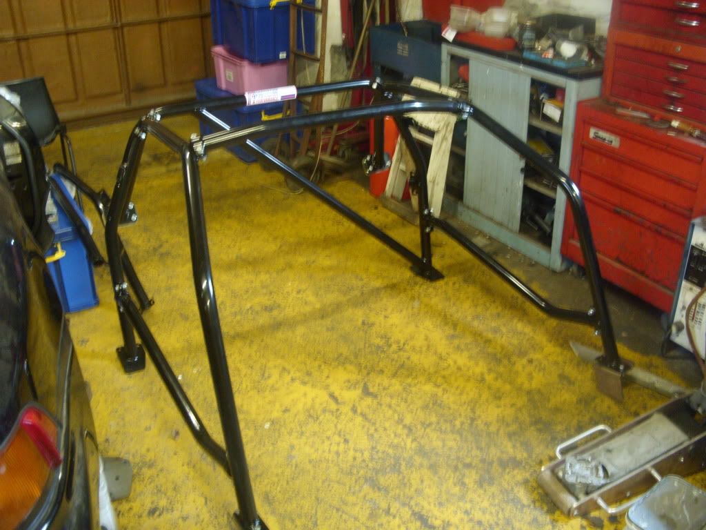

Moving on to the modifications for 2012

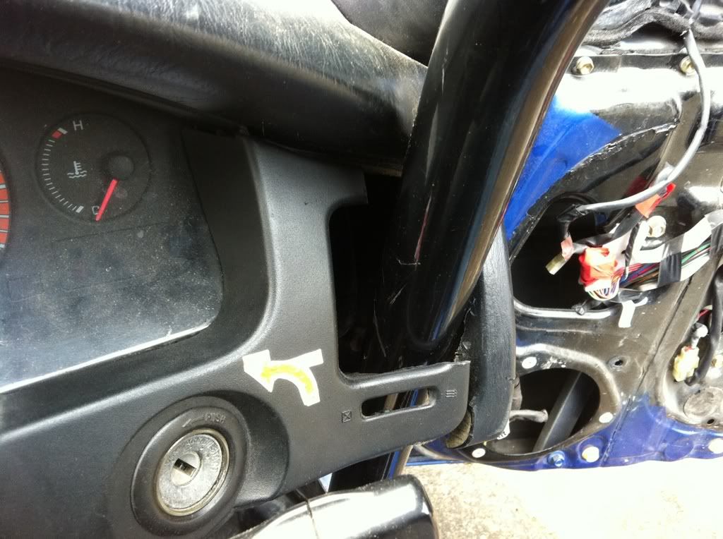

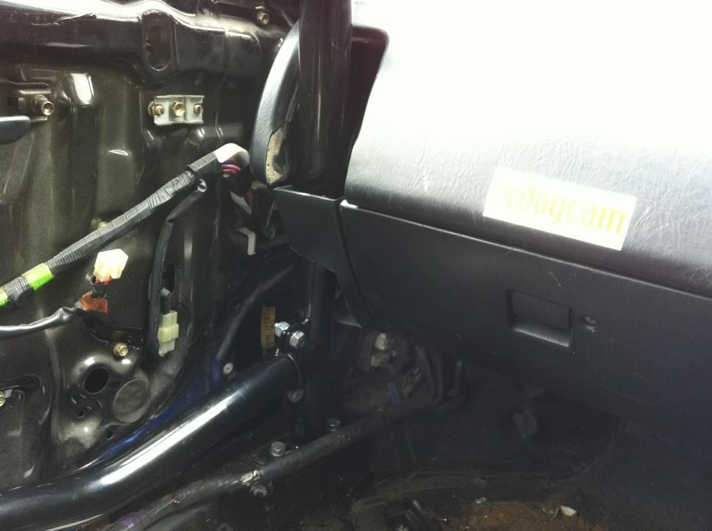

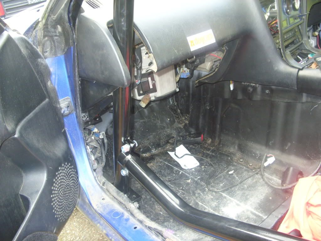

we had a few discussions in 2011 with the marshals about our saftey equipment or lack of it!
although we were well within the rules (for a road car) they were a little conerned that we were doing very close (somtimes beating) times/speeds of the full blown race cars and single seaters yet having no roll protection and standard seat belts.

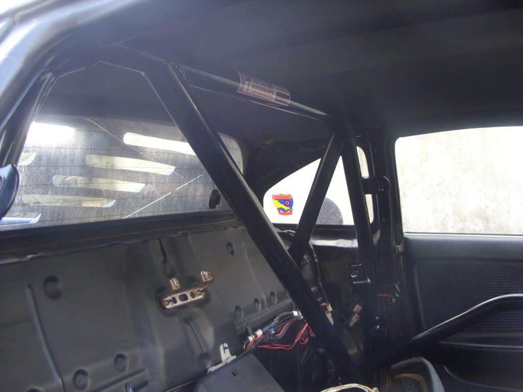

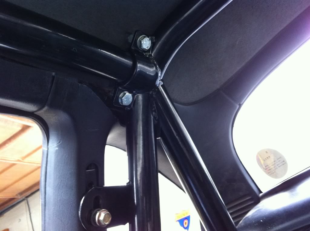

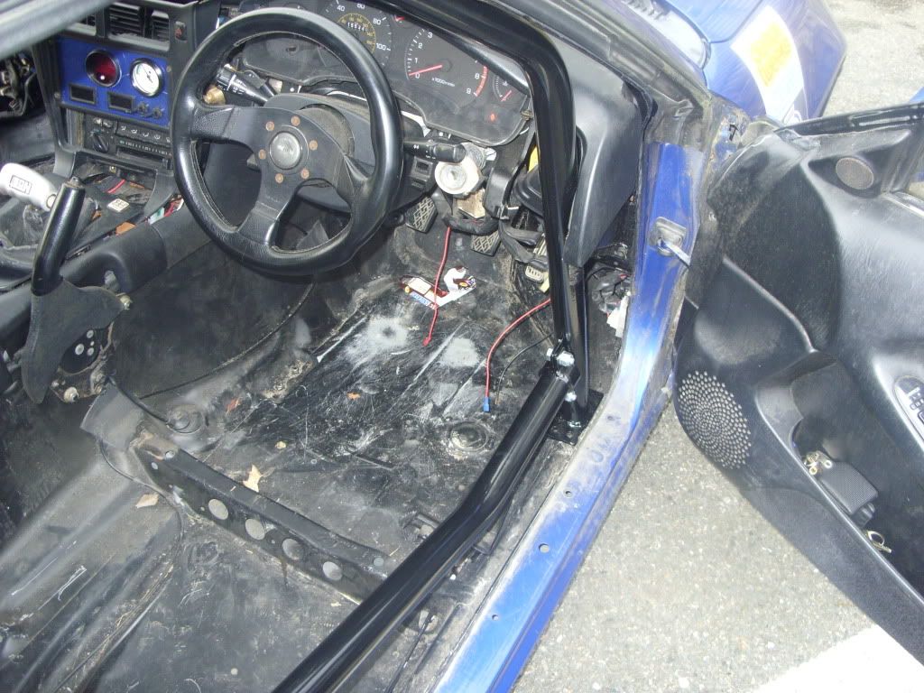

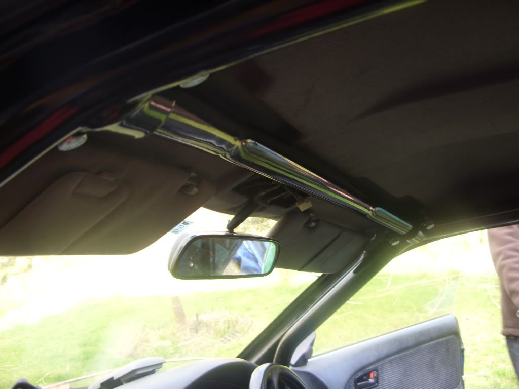

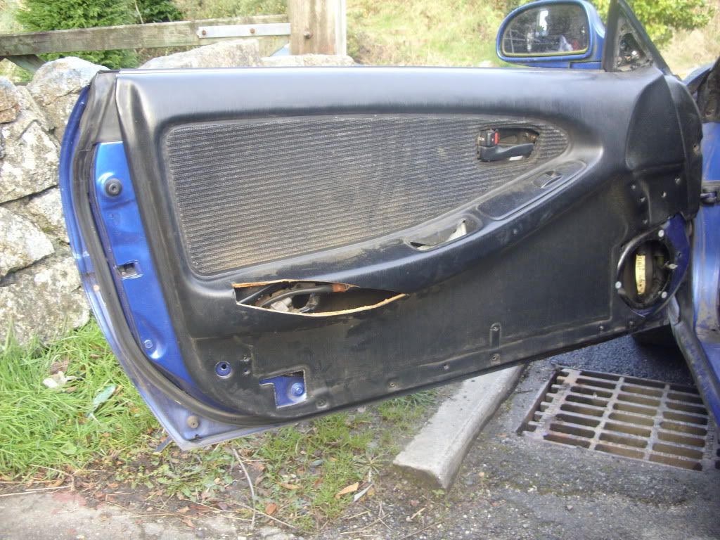

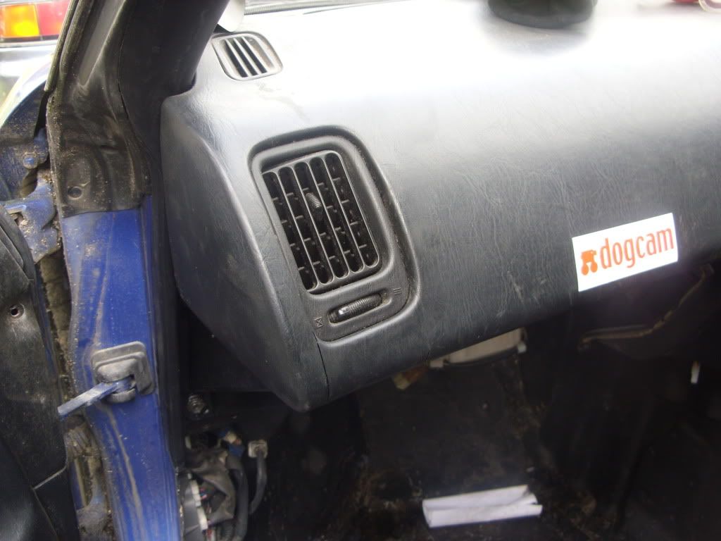

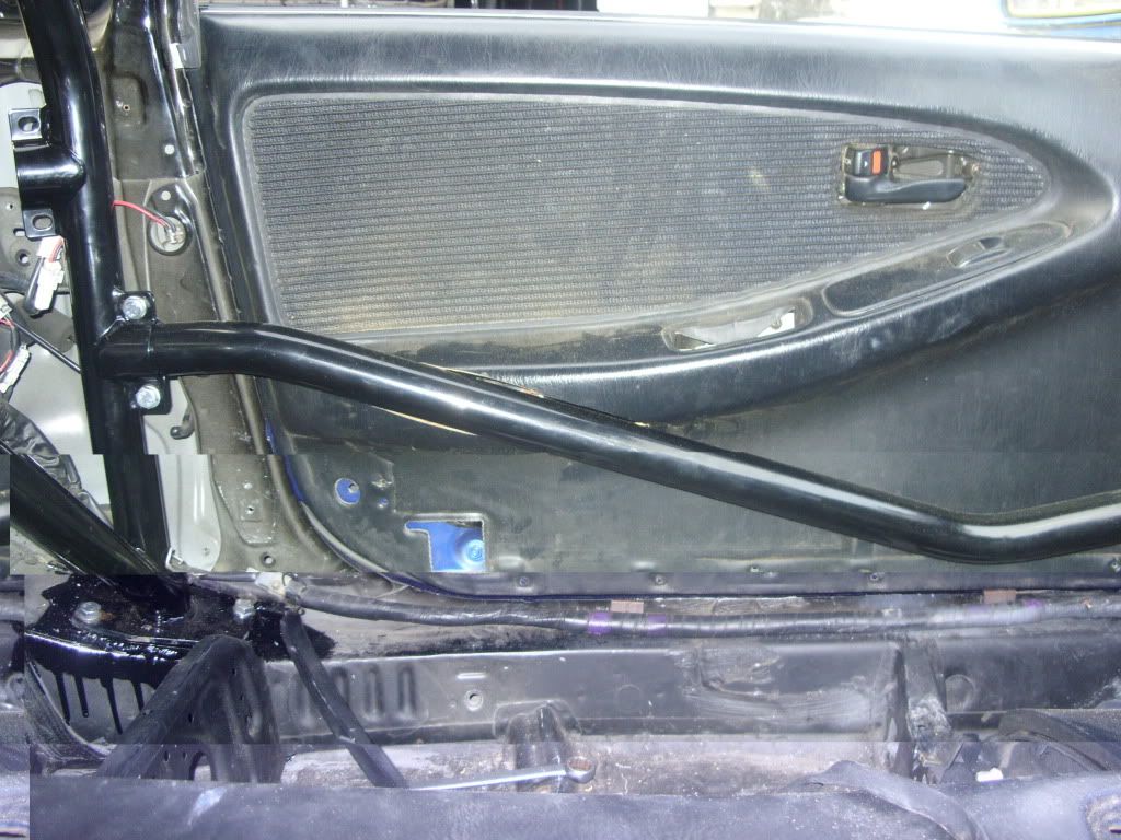

so we got a couple of cages

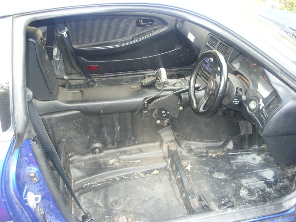

The biggest problem we were going to have fitting them was to stay in roadgoing we had to keep the interior as stock as possible.
lots of cutting and hacking coming up!

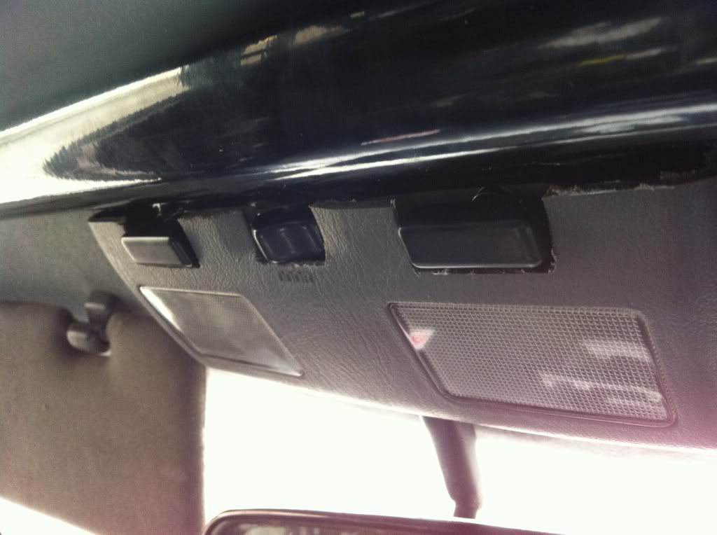

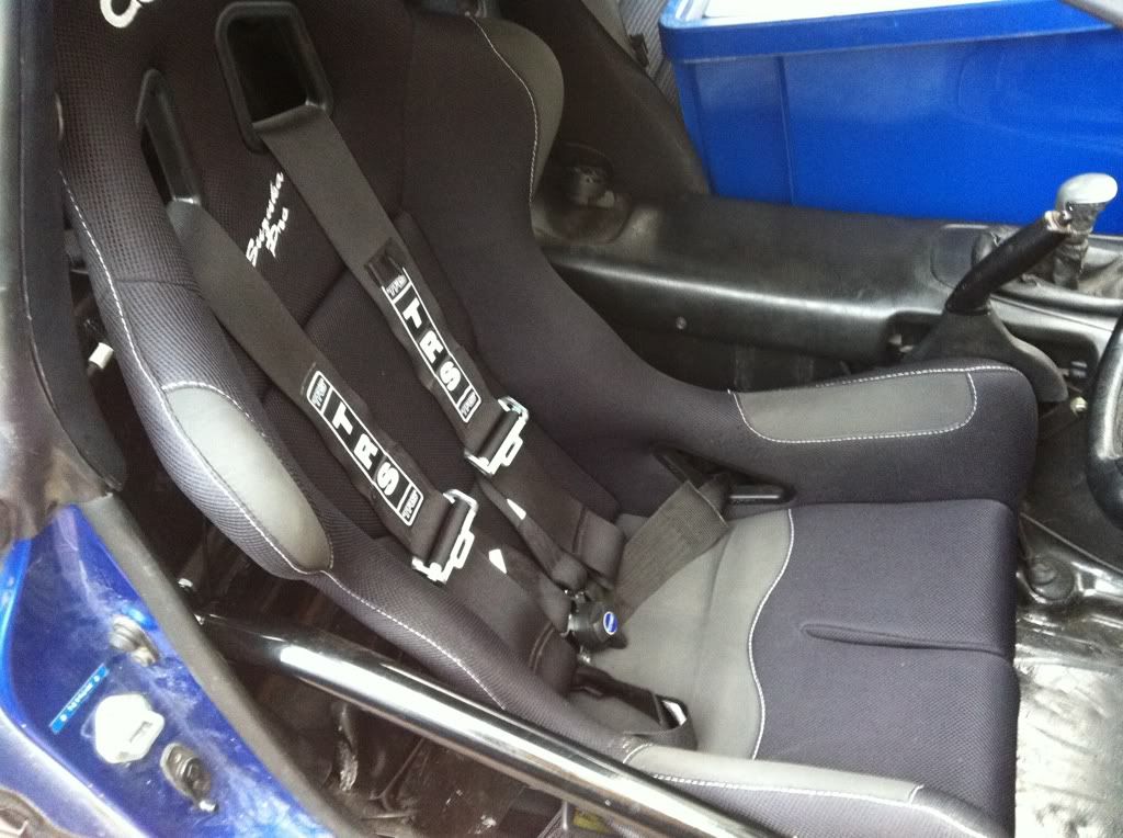

Cage and interior all in now for my seat

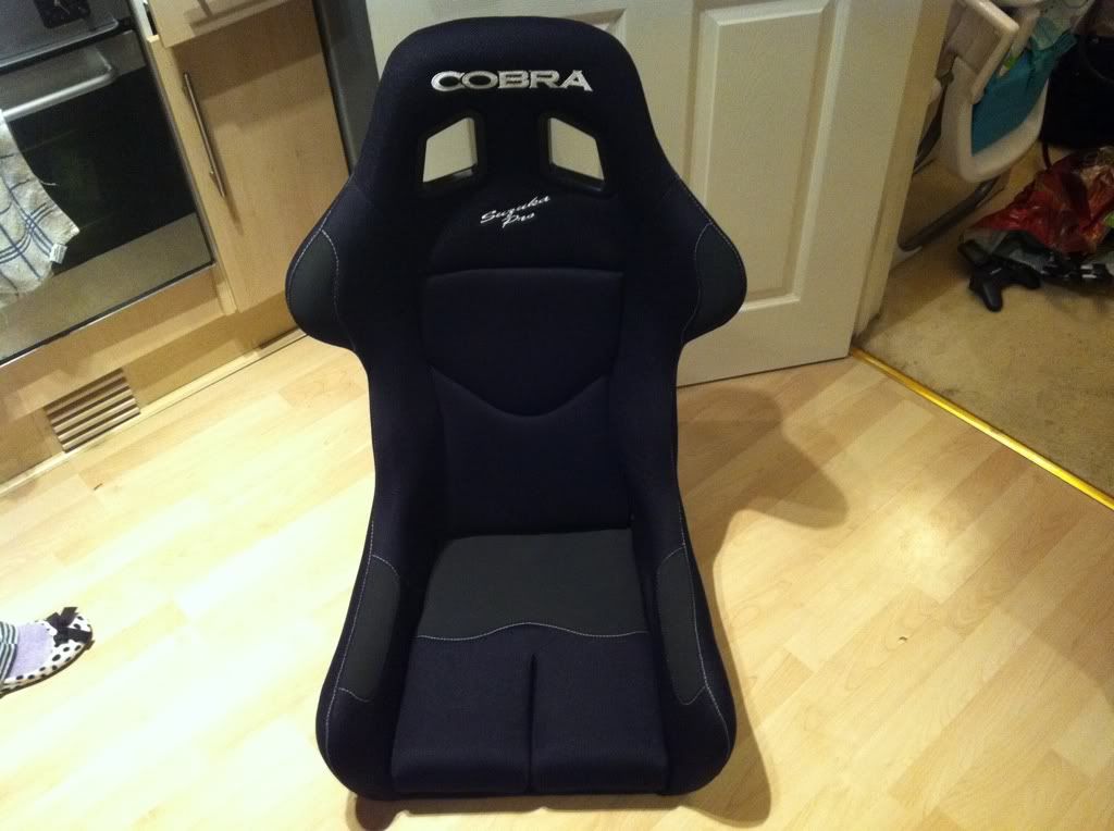

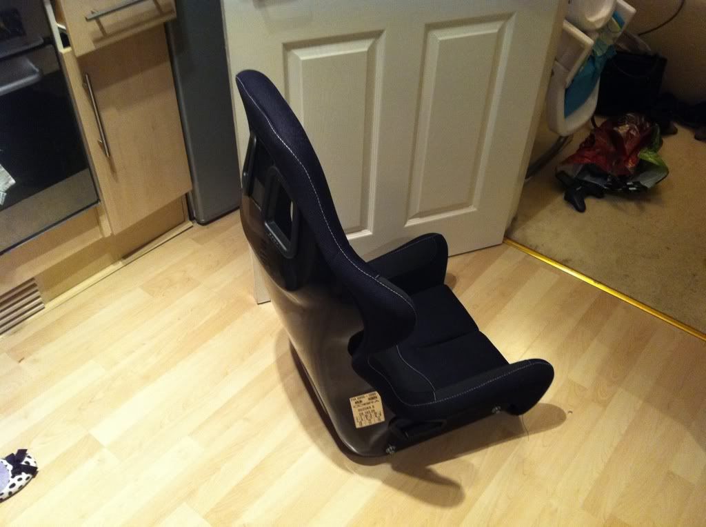

we went to the auto sports show and made the mistake of trying out some cobra seats
i got the suzuka pro gt

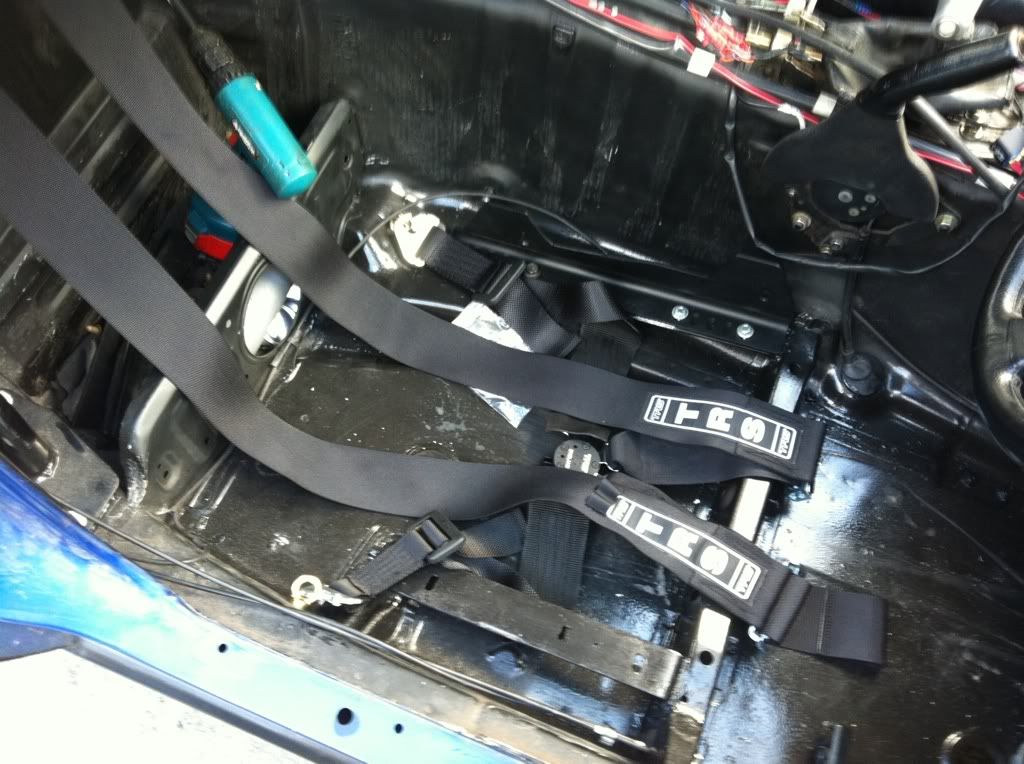

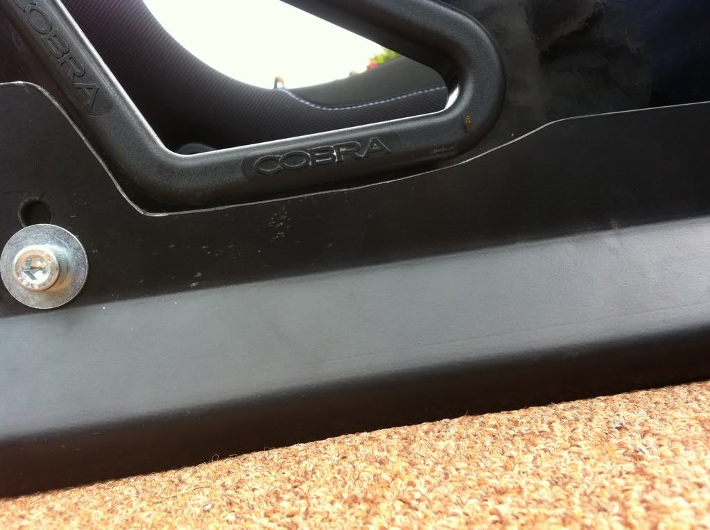

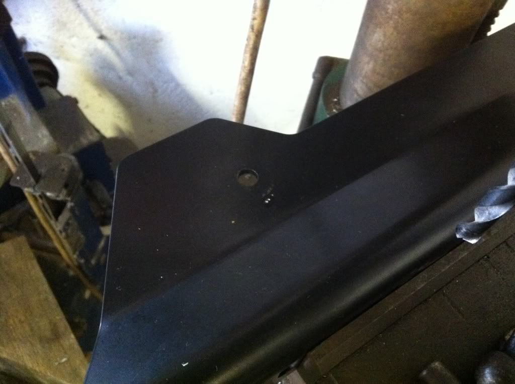

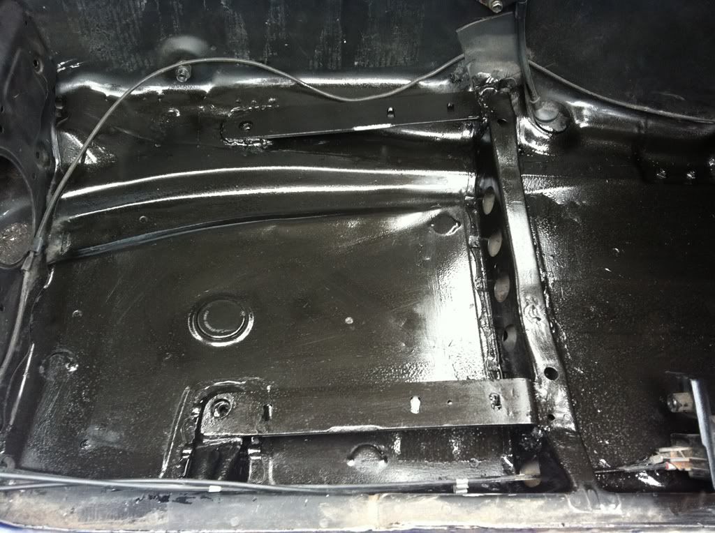

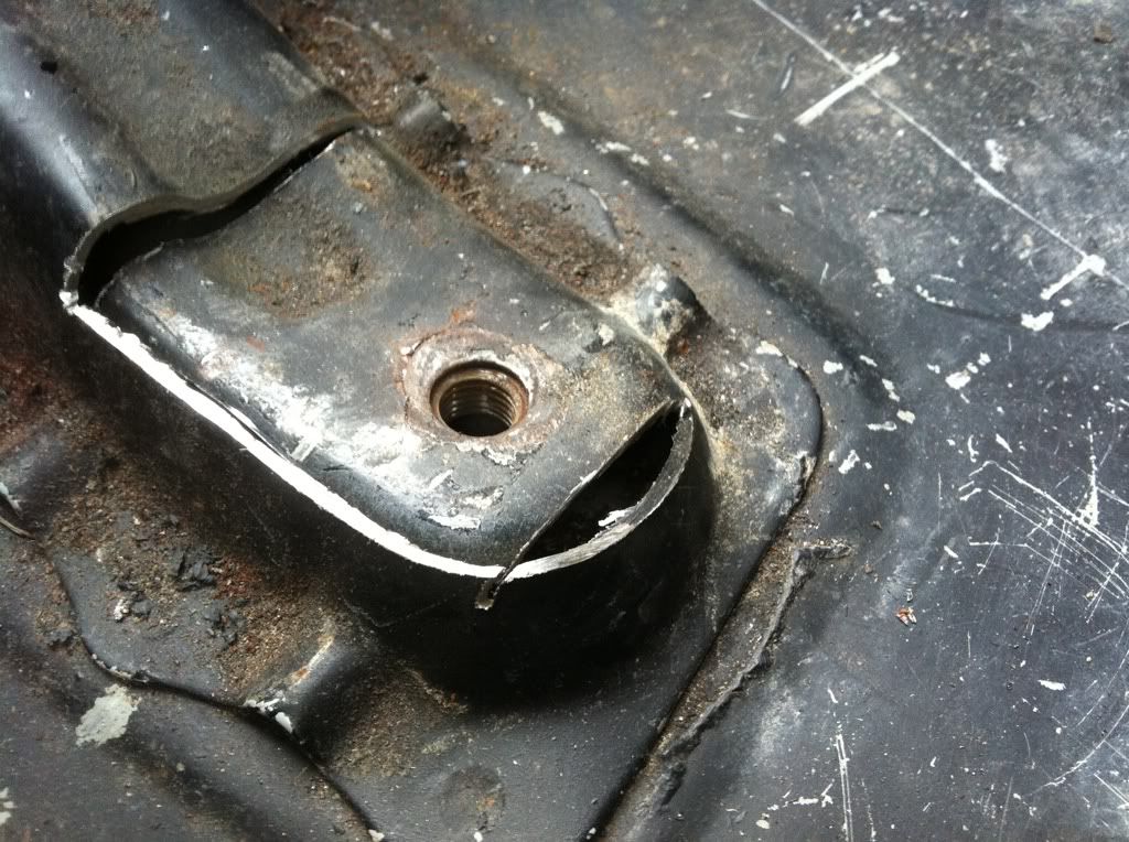

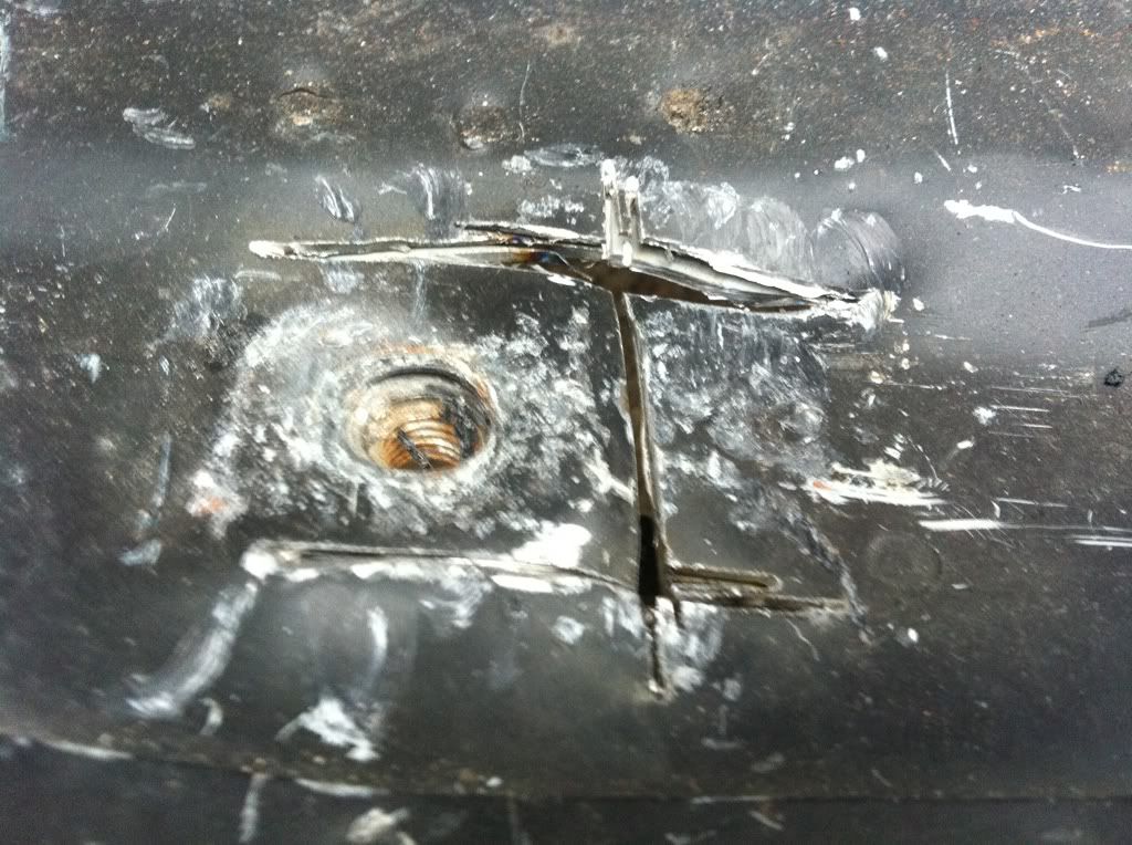

having the roll cage now above my head room was limited so had to drop the seat as low as possible

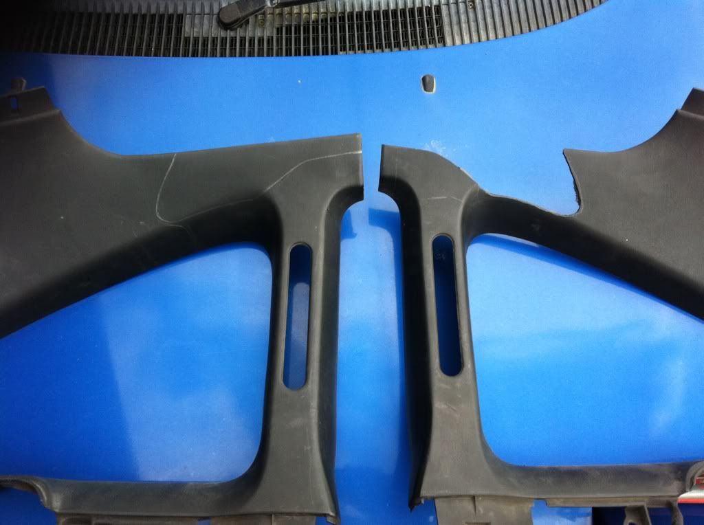

extra low holes
shaved the mount a little
a little cutting
plates welded in and painted

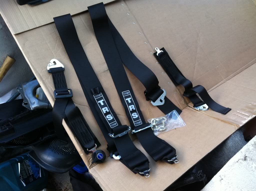

then the harnesses go in
all done
extra low holes
a little cutting
all done

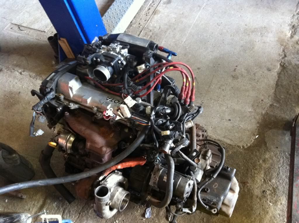

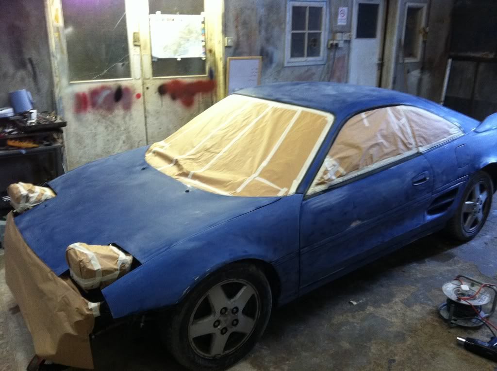

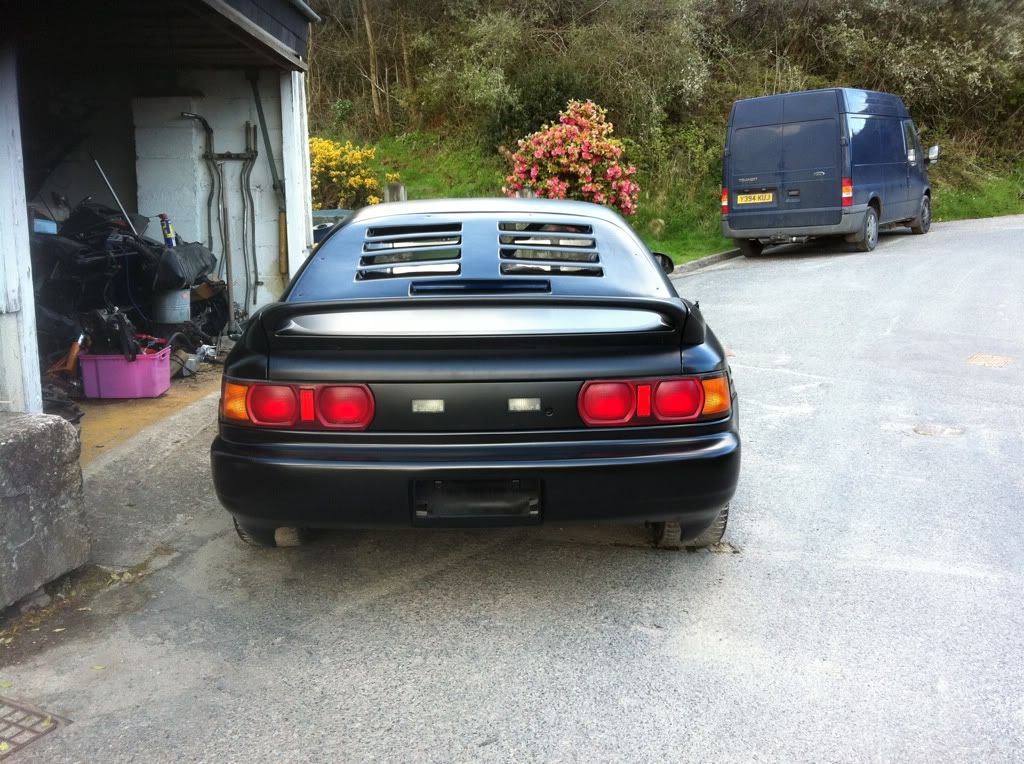

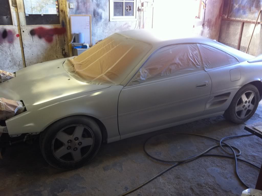

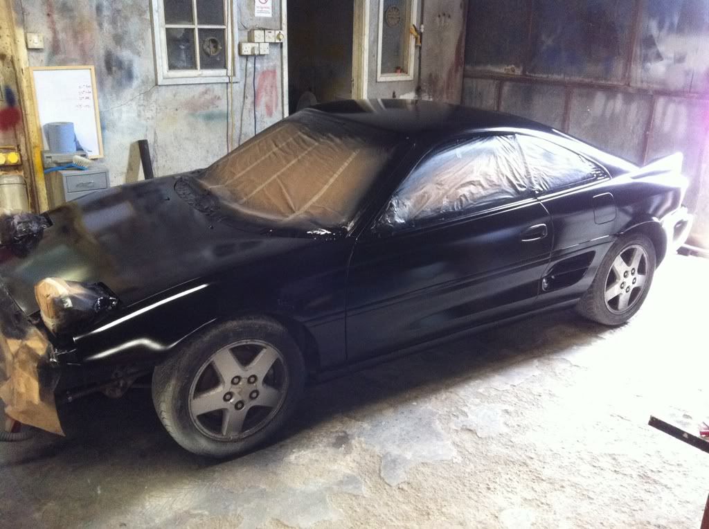

Next task for 2012 was to drop the engine out

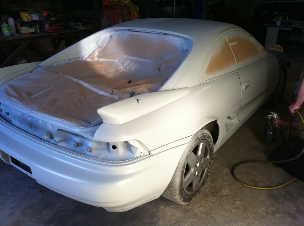

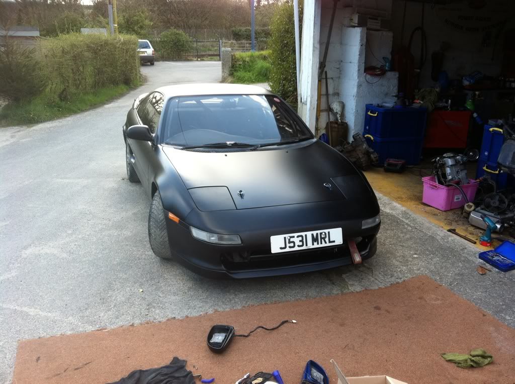

once it was out i decided i wanted a colour change
so stealth matte black was the obvious choice
thought id stick a set of rev3 lights on while i was at it
so car painted time to crack on with the engine.

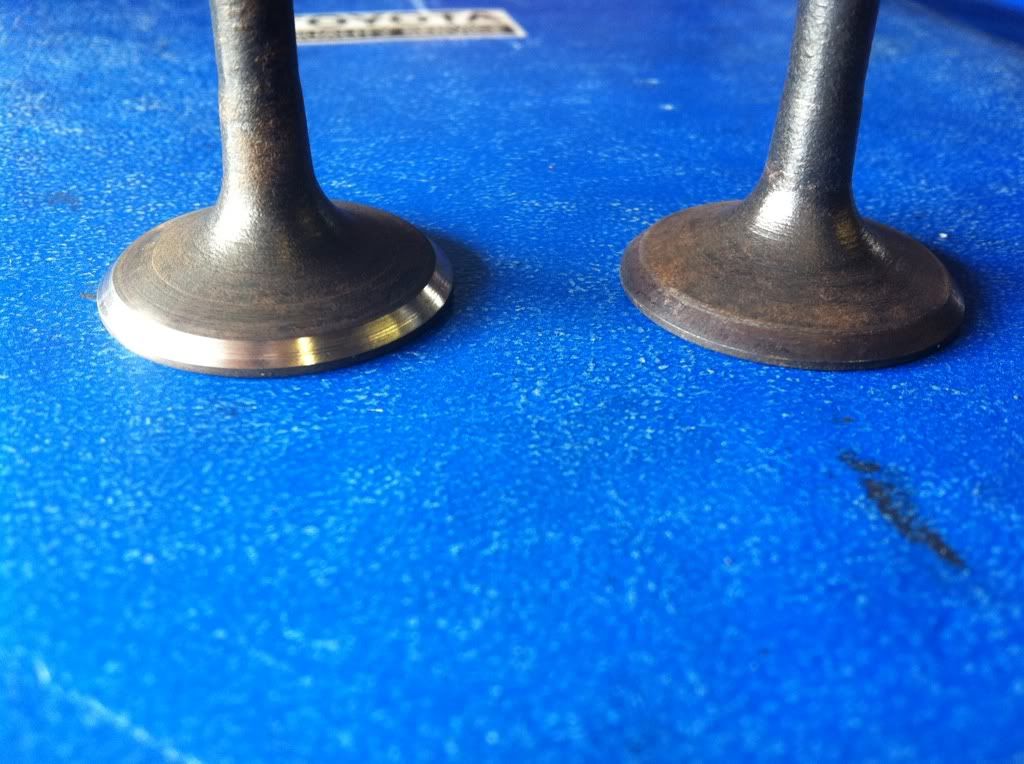

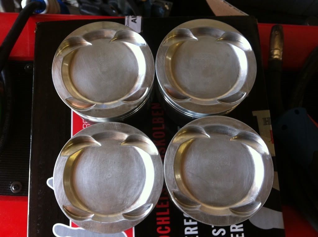

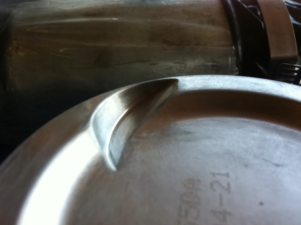

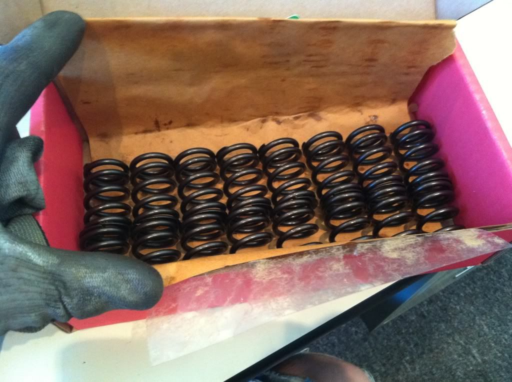

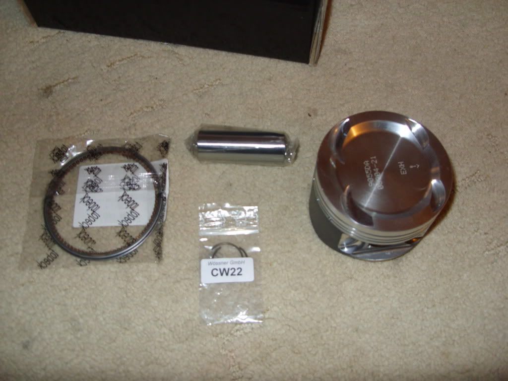

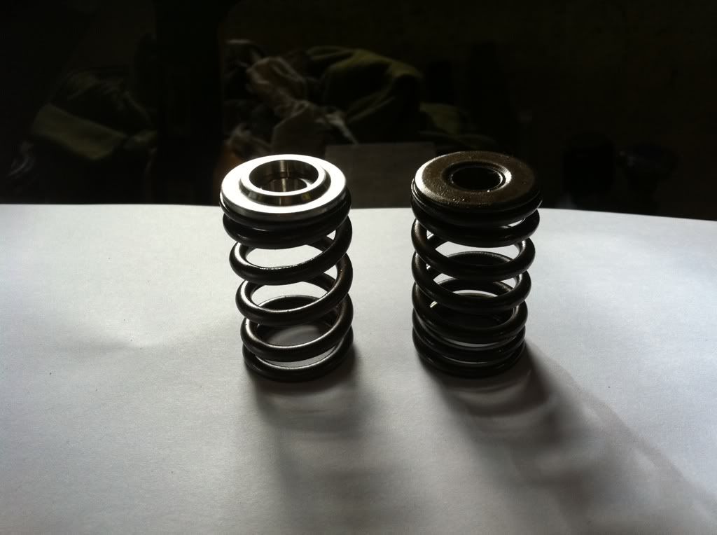

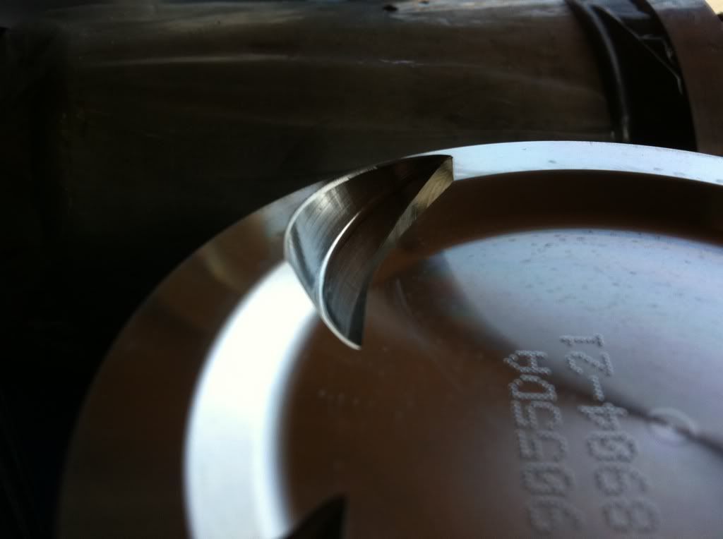

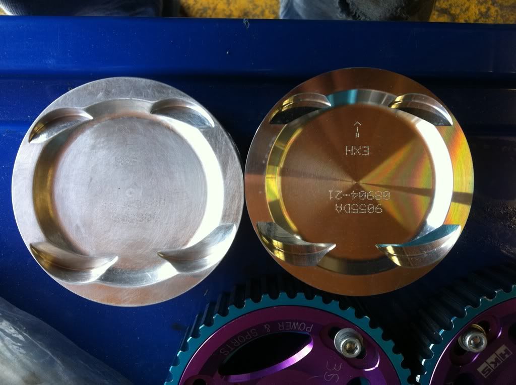

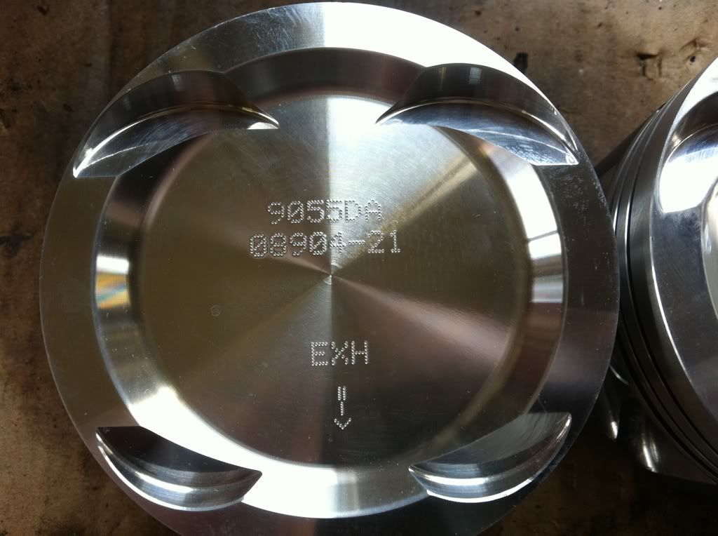

The first thing was a set of wossner 8:1 86mm pistons

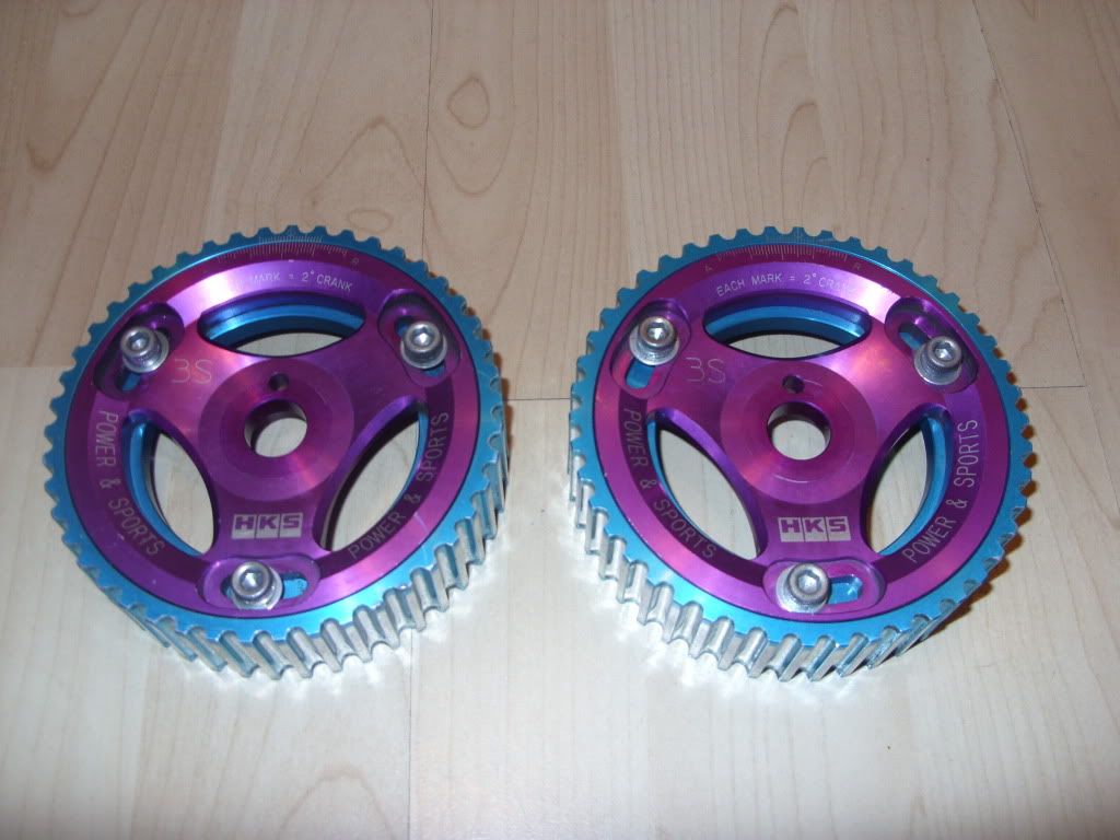

then cams and pullys

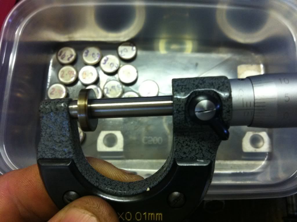

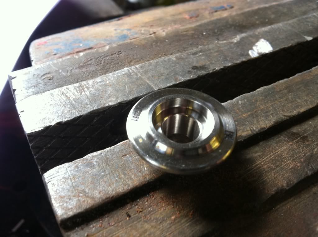

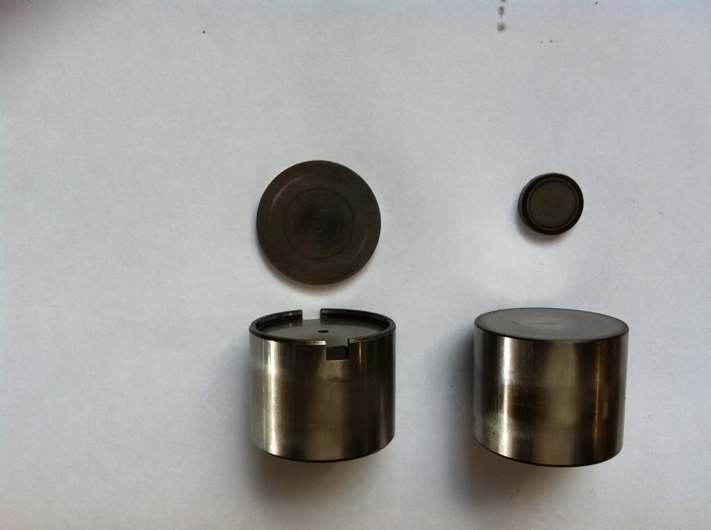

valve springs and retainers
so set to work on the pistons
once again removing sharp edges and flatting off the shine
all done

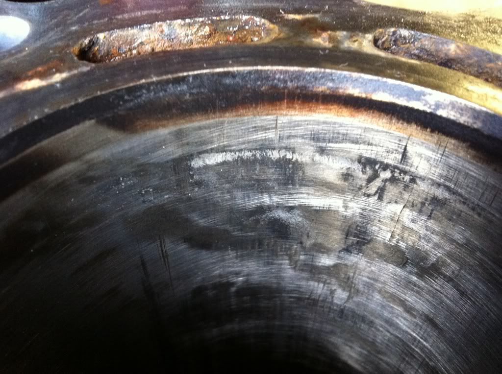

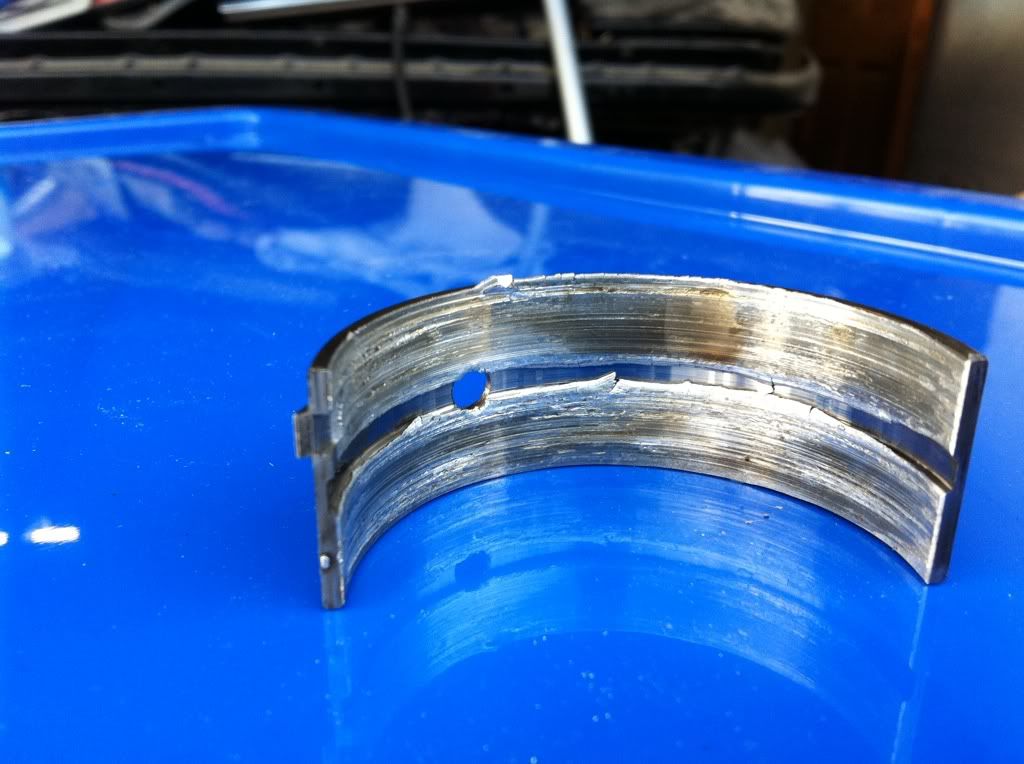

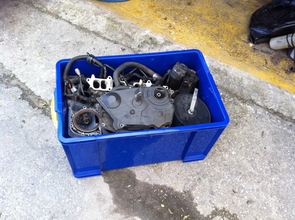

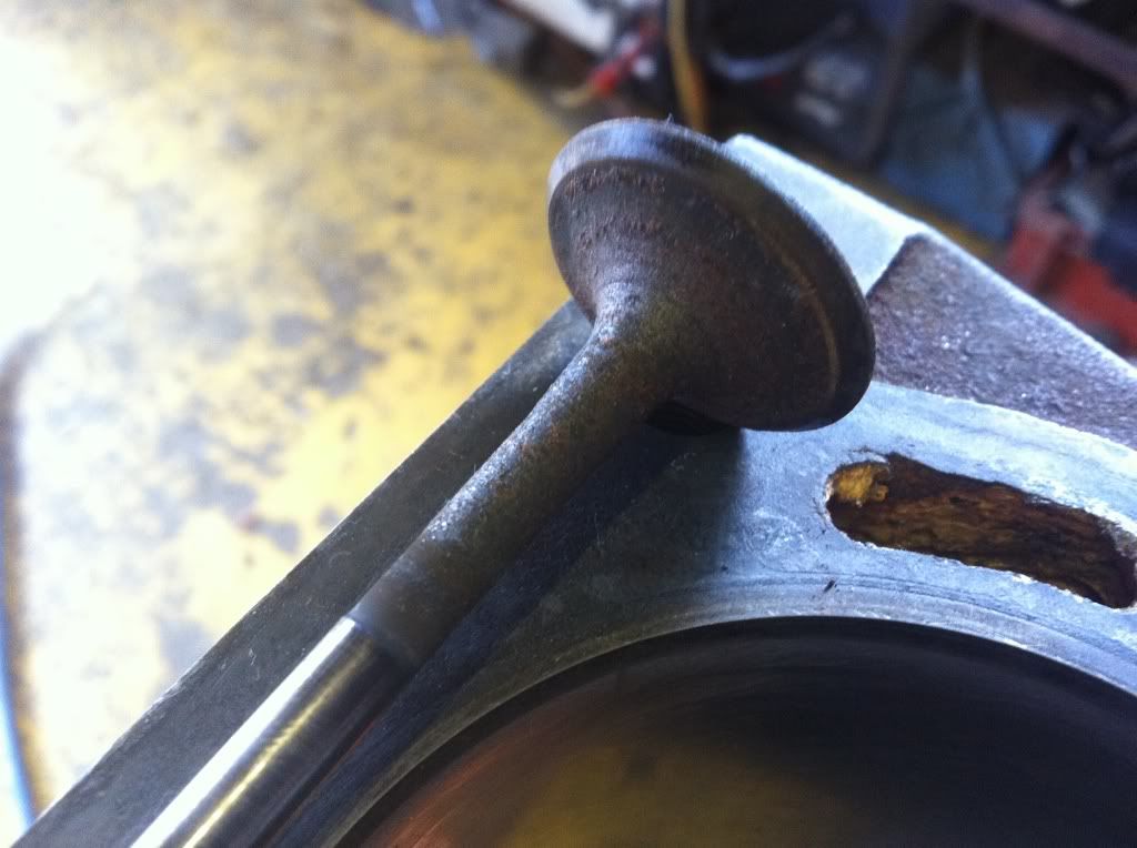

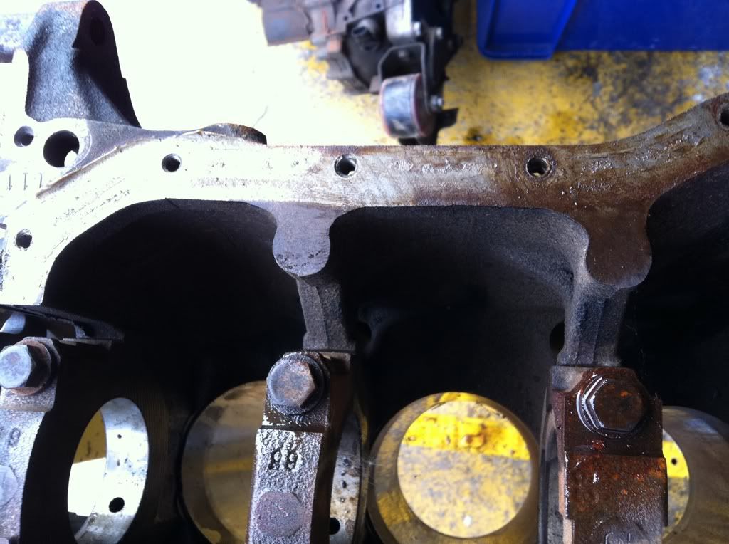

with the engine out (again) i started the stripping down!
couple hours later

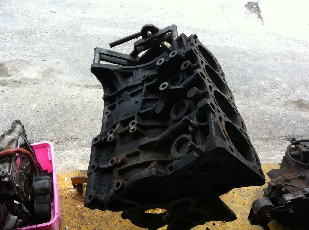

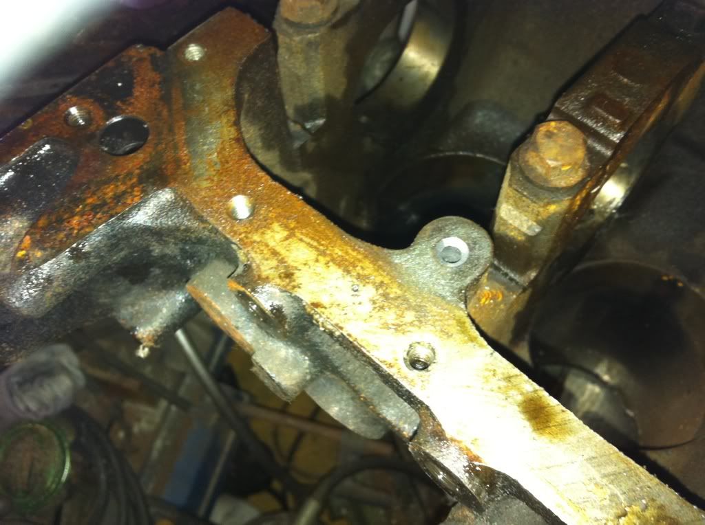

well after i took the crank out we saw further damage from poping the engine the year before
this is where the piston melted and had to scrape the aluminium off

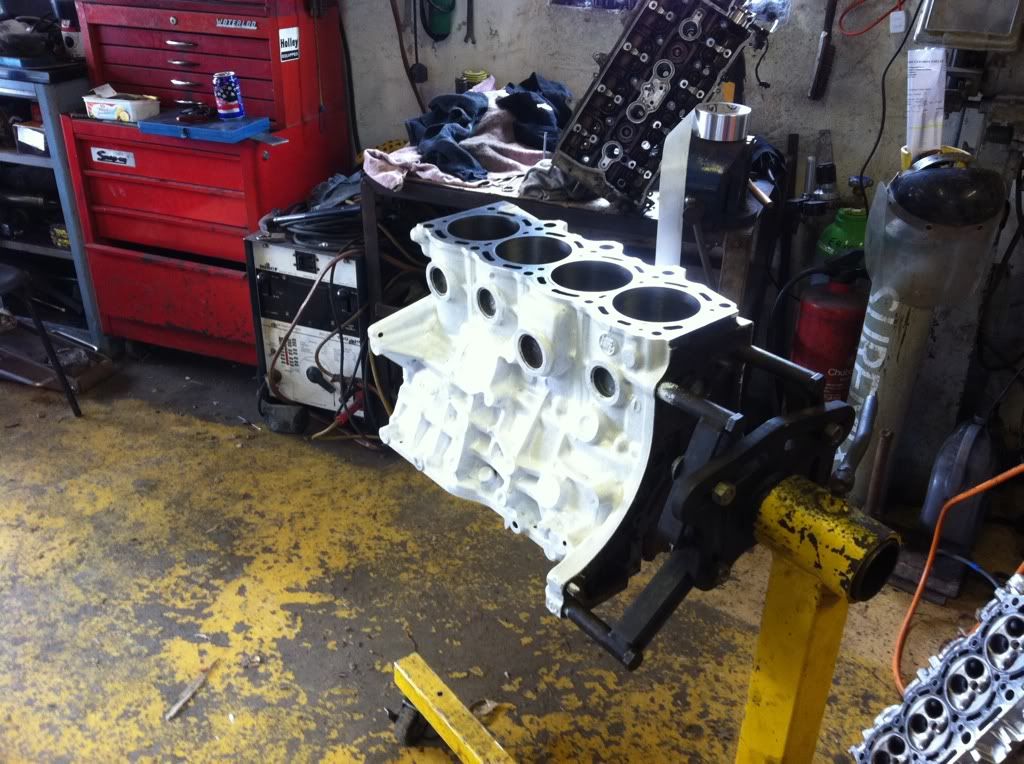

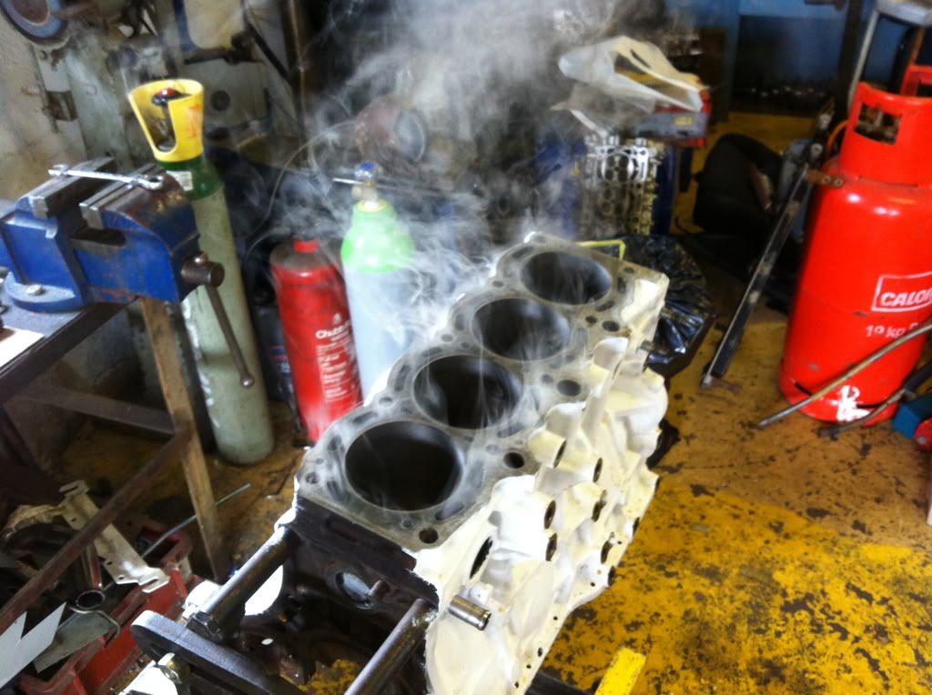

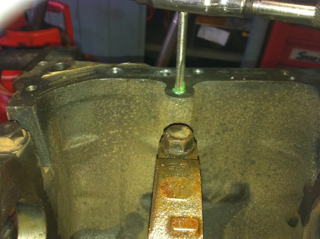

as this block was now scrap i had to use one of the others we had.

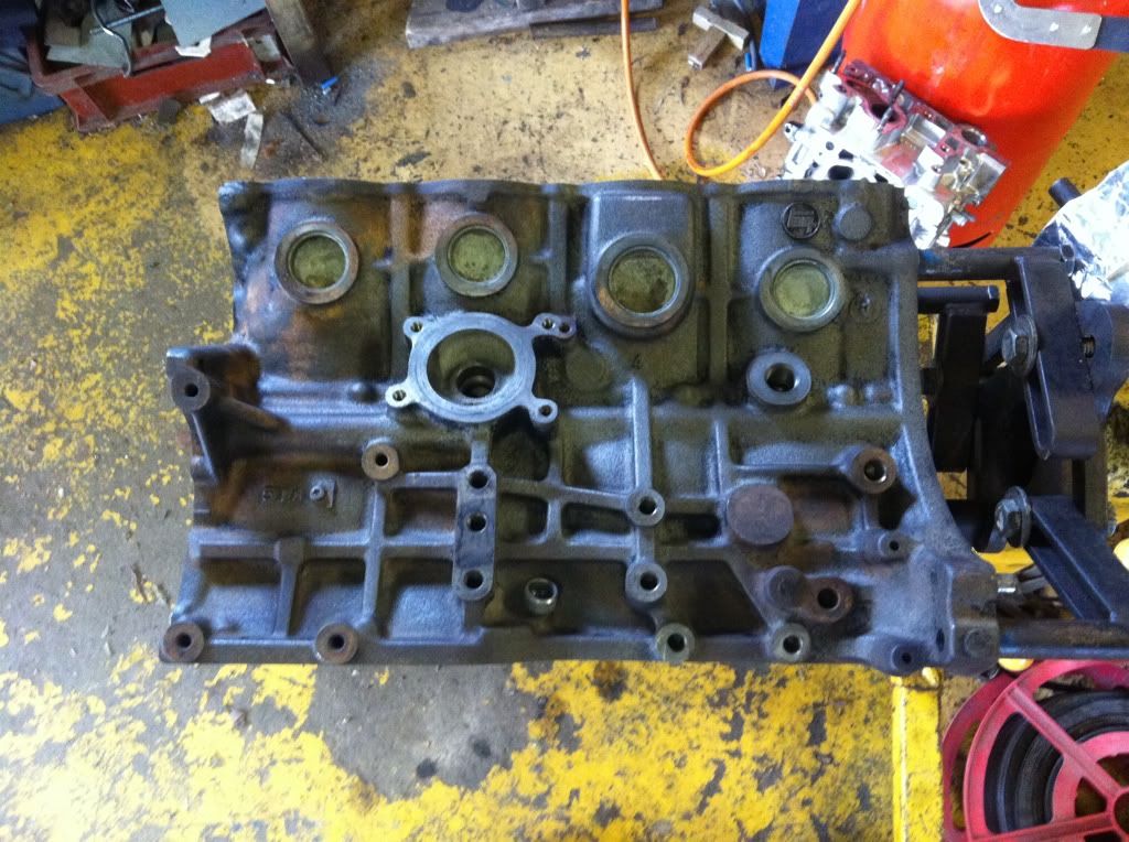

just making sure its an 86mm bore

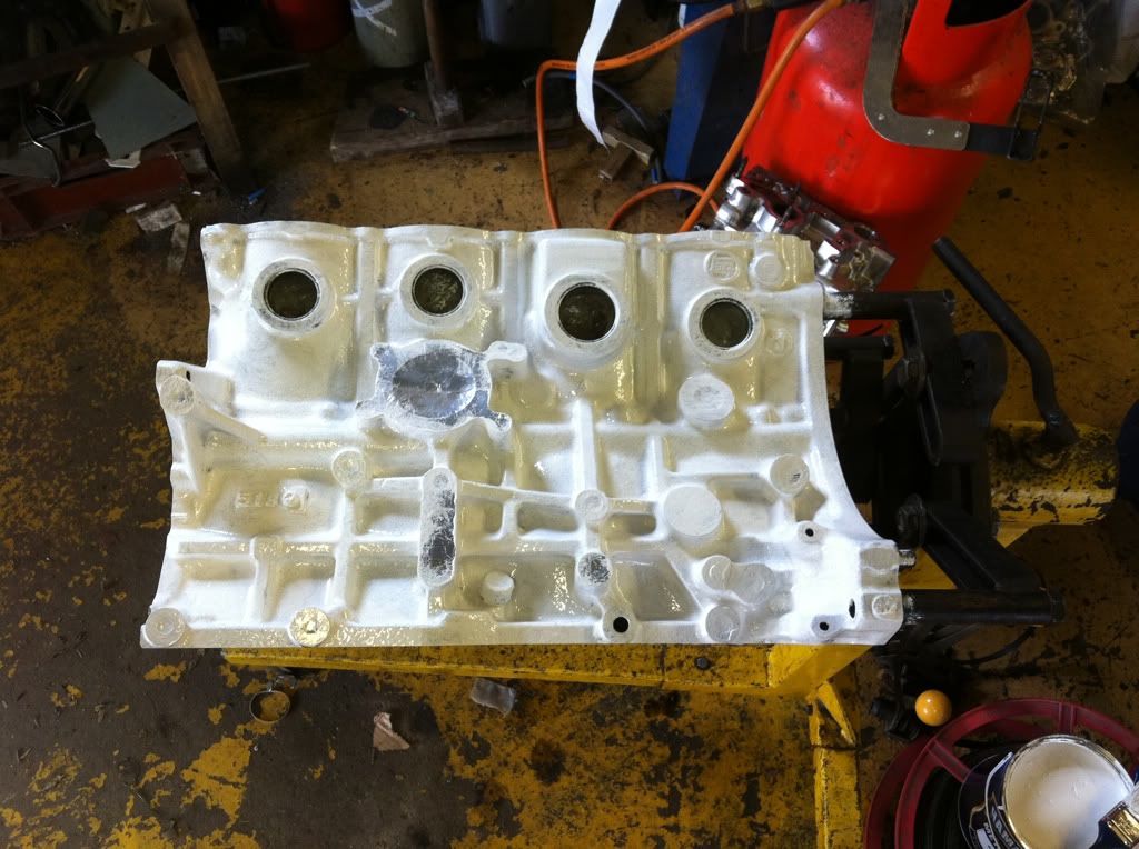

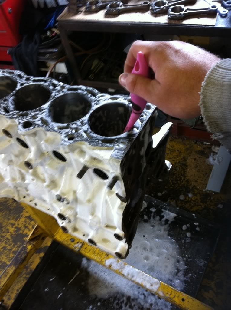

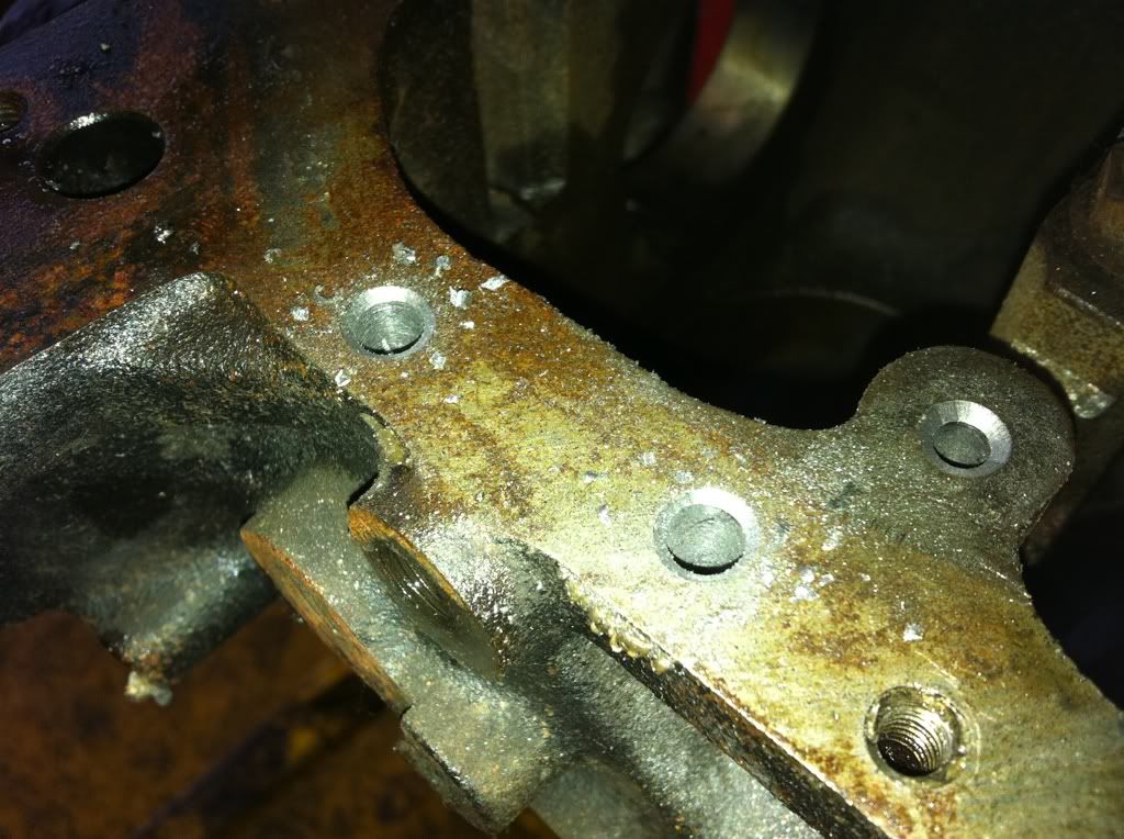

another rev2 so the usual was done to fit a rev3 sump and baffel
so that done i took it for a dip and hone

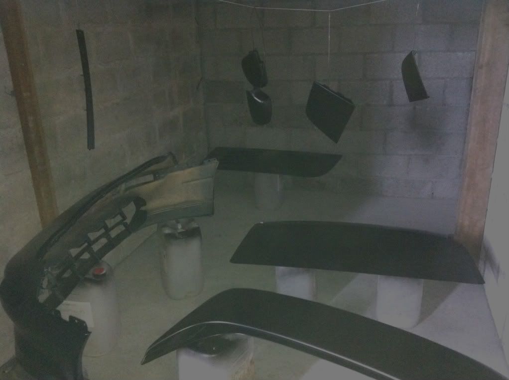

ready for paint
ok some of you may think why white?

once i got the outside well cleaned and painted i gave the bores a very very good scrub
then blasted out every oil and water way with steam to wash out the acid.
this was great fun

so while they were away i got on with the cams
took the cams out and the buckets.
as these cams are quite agressive i couldnt use rev2 buckets and shims as the cams will flip the shims out.
so got one of the rev3 heads and took the buckets and shims off it
got my hands on all the rev3 shims i could find measured them then wrote the size on them.
got the springs out
got them all in with the valves and fitted the buckets

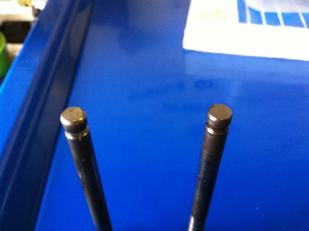

then when i was putting the cams in i realised i had used rev2 valves
the rev3 valves are shorter between collet and tip
so out they came
i cleaned up and re-cut the rev 3 valves
valves went in and all fitted lovely
head done!
all done
couple hours later

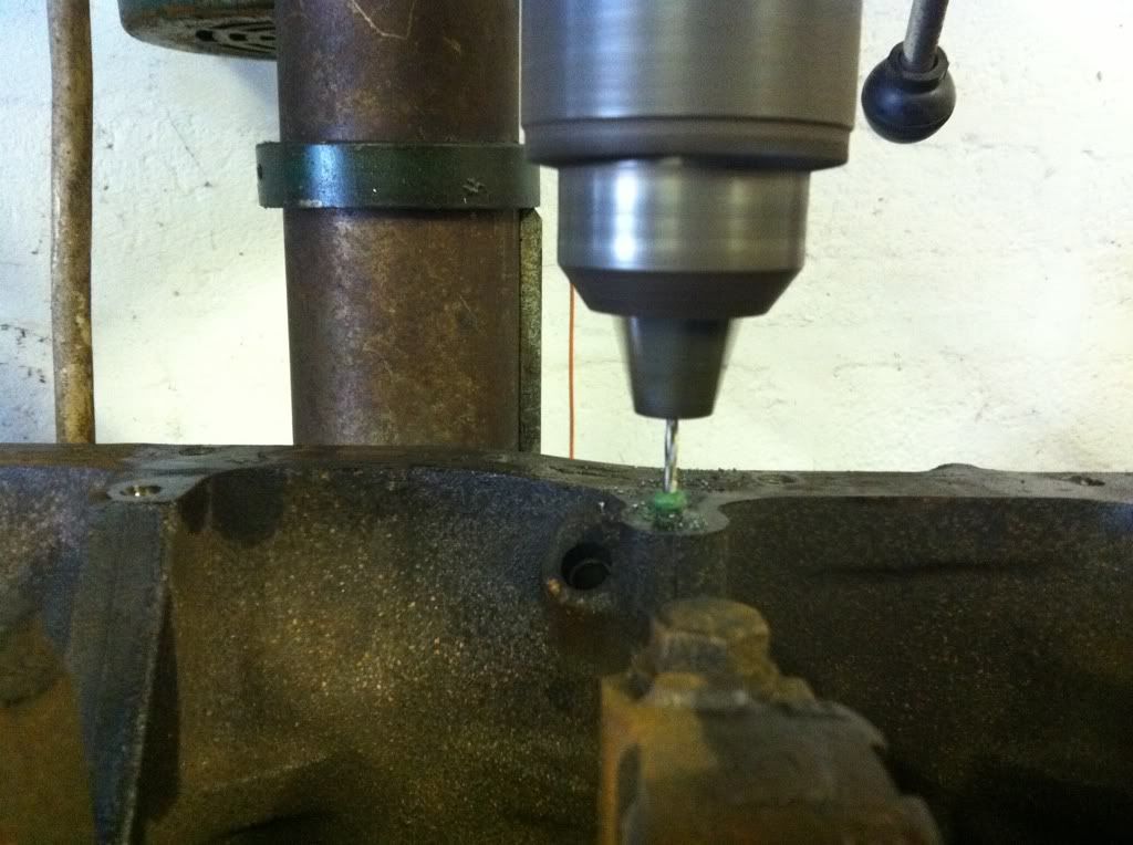

ready for paint
well ive found white to be so much easier to work with/on even tho it gets dirty easy.
this was great fun
got the springs out

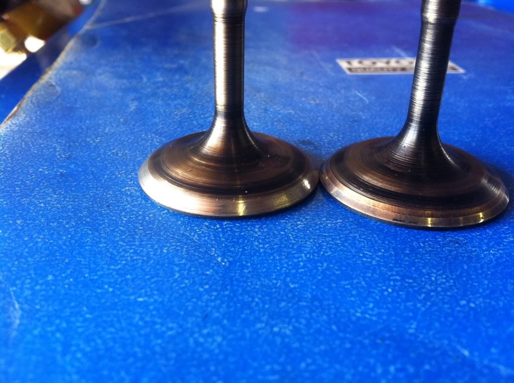

so out they came
head done!
