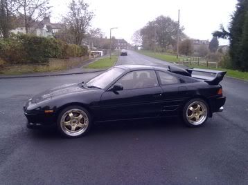

Hey I can post pics!!!
here is one ...
I need to polish it and clean it make it nice !! :)
