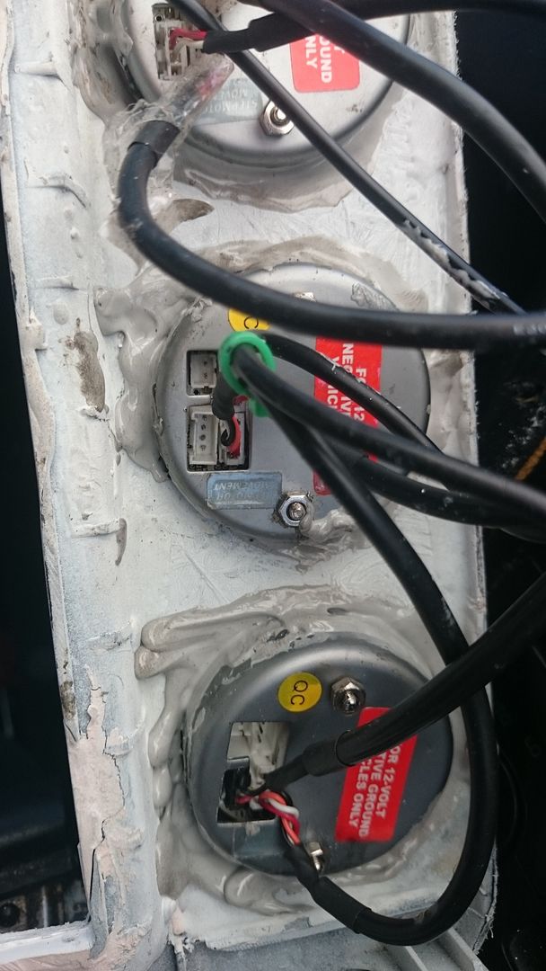

I am 100% sure the original gauge works but the two wires for the sensor have come loose and I can't figure out where they go and in what order, I have the choice of 7 pins [-(

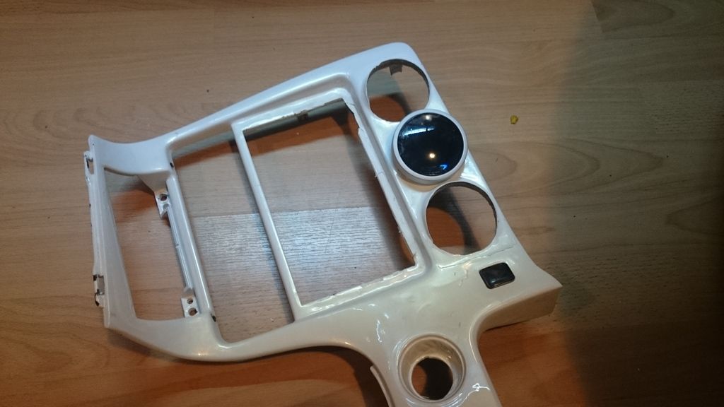

So, as I was never happy with the finish on the centre panel I decided just to remove it, file the holes for larger gauges, buy new 60mm gauges and get the whole panel fixed up and resprayed... :eye:
current wiring, couldn't find anything about the wiring online...

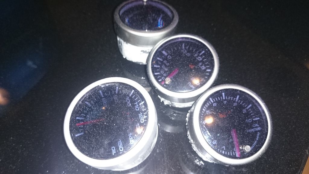

larger dial against the smaller ones

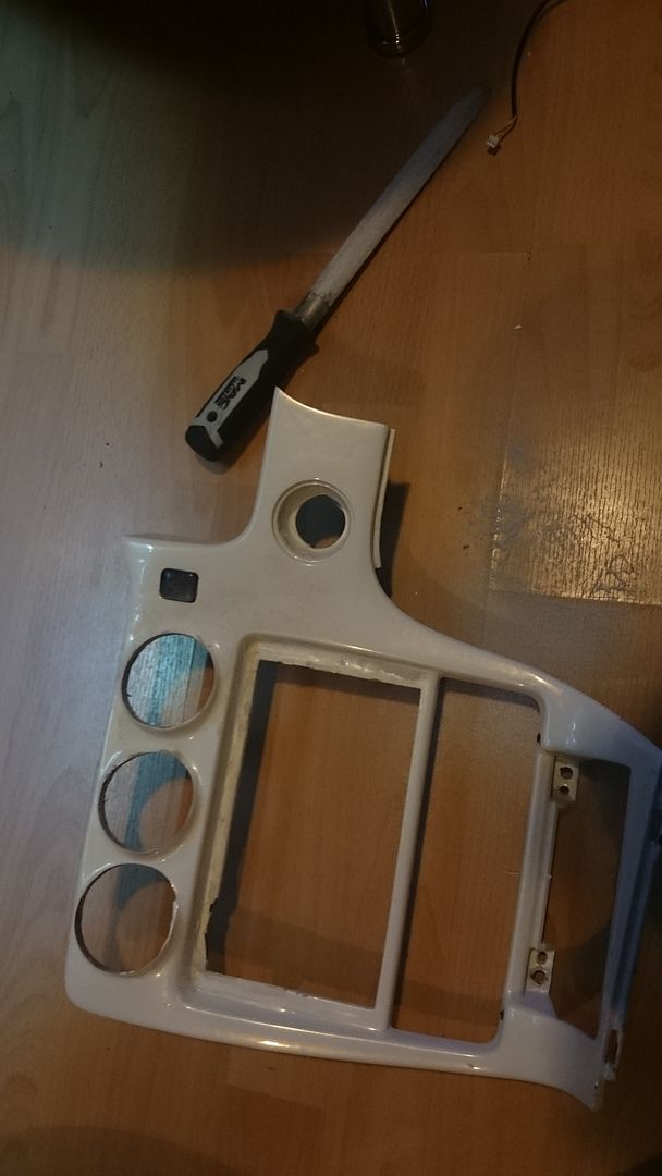

the finish on this was pretty tatty, it also had some hairline cracks, the holes now all hold a 60mm gauge so I will rub it all down, fix the cracks and repaint it.
