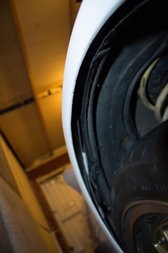

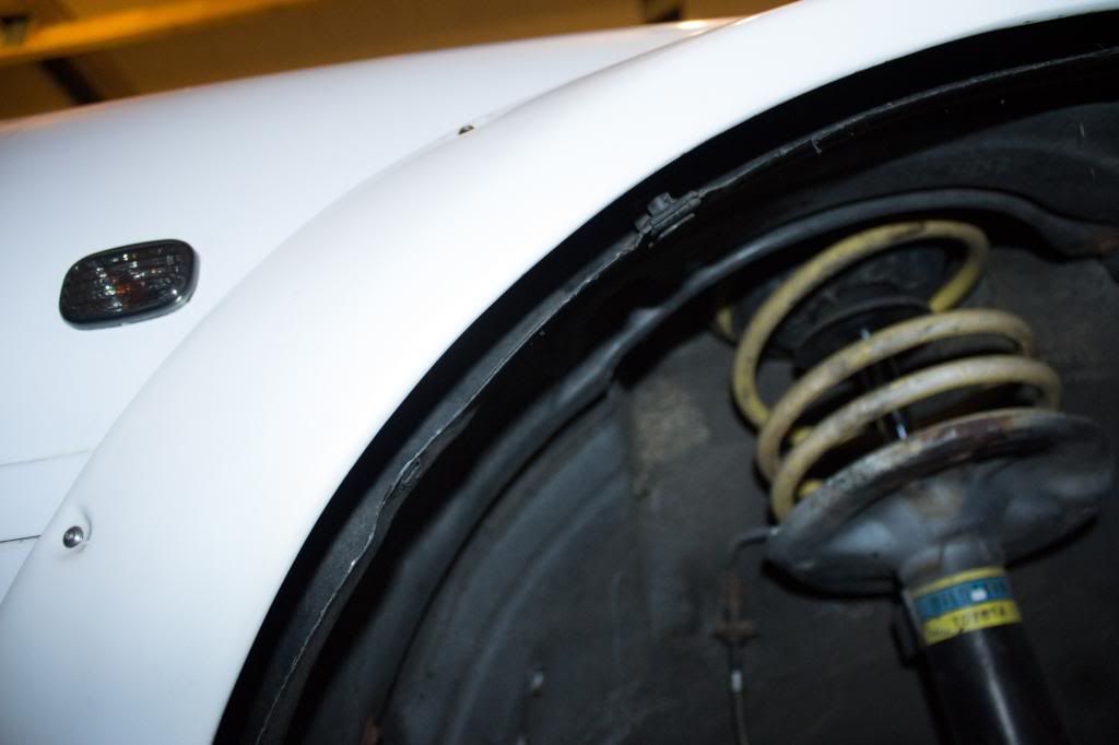

Managed to get a run at trying to fit the arch liners, all the while knowing such a simple job would become a massive PITA :lol:
The driver's side liner is in, however there's a tiny little gap between where it ends and the body starts :-k :whistle:
The above can be resolved either through custom pieces or by fabricating bridging strips to go in between, however I think the larger issue is that I still think the tyre outer will rub on the liner when it's dropped down. Not done it yet but it would seem that's the case :-k
I guess a solution might be to trim it back further up and make pieces which fit with the contour of the arch and clear the tyre.
There's also work to be done where the lower bumper meets too.
There's also the small issue of the fact I appear to have two driver's side liners #-o :lol: Tools downed for the night :eye:

Looking at that I reckon your best bet is to make up some liners from scratch mate, maybe out of ali? Or even thin fiber glass?
Might be worth having a chat with Paul Woods, I'm pretty sure he's got custom liners nailed- might give you some tips/ ideas :thumleft:

I think you're right.
I'll wait until the tyres are on so I can see the clearances etc, then I'll probably be giving Mr Woods a call. Never really done any sheet metal work before but I would also like to fabricate a flat undertray for the bumper.
Maybe a bit more research is required, as if it's going to be custom there might be ways to improve on the original designs and improve airflow :-k

I think I'll end up creating two pieces for each wheel arch, one at the front (wheel meets bumper) and one at the back (wheel meets the skirts). They'll both be tapered up to a point in the top of the centre of the arch, that way they will isolate the arches in the same way the stock liners would but won't foul the wheels when they're fitted and the car's back on the ground. I can't think of a reason why I would need a liner which goes all the way over the top of the arch, other than when Toyota made them it's easier to create a single piece :-k
I think the best solution for securing them to the top of the arch would be to use rivets, as there's a couple of perfect mounting points.
Before I do that I guess i need to create a template for the front undertray, as that will pull in the bumper sides, which currently flare out slightly. Perhaps clear plastic sheeting would work well to template with, as I'd at least be able to see mounting points etc :-k Suggestions welcomed though :)

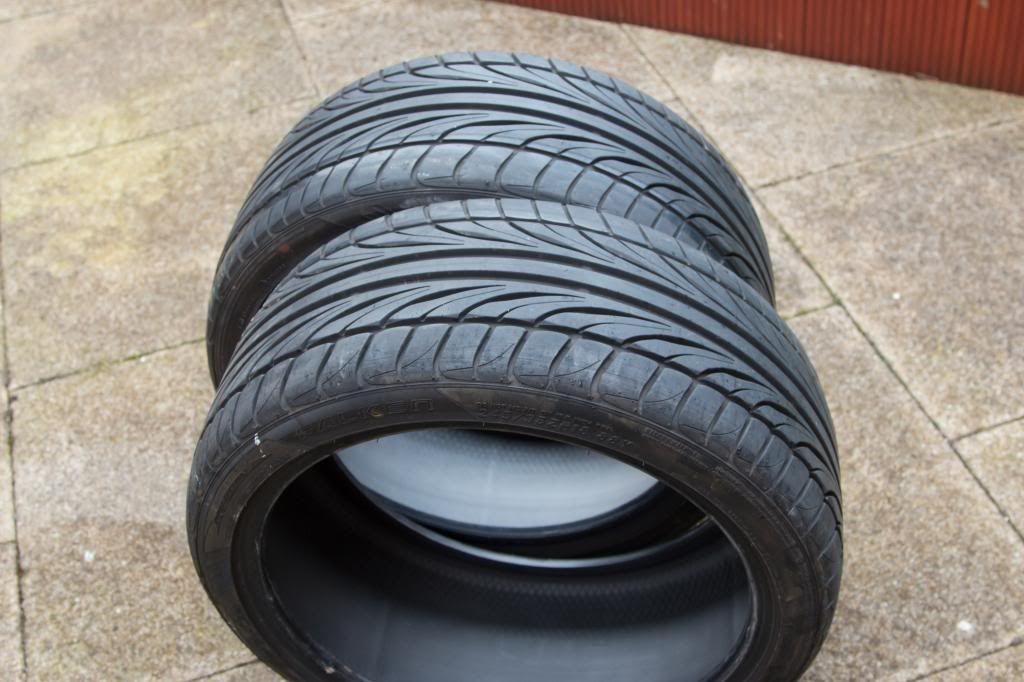

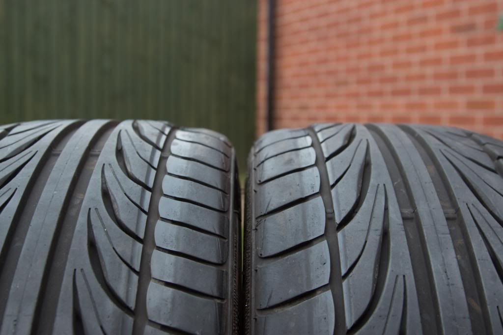

After the old tyres were removed I took some time to inspect the wear on them and I have to admit I was a little OTT in my description of the wear severity :oops: The fact they were originally fitted in that way still stands as a big no no though [-X
Seems like an awful waste to have to swap them, as there's no more than 1mm of overall wear in other areas :roll: Possibly they'd serve as rears for someone :-k

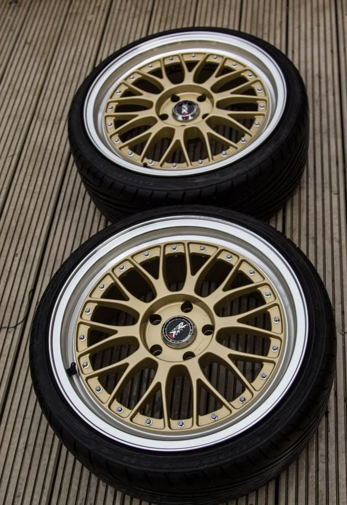

New ones are on but the rims need a damn good clean! Carbotechs are so dusty it's insane :lol:
They're a bit of a stretch but it's a compromise I had to make. Just need to keep well away from kerbs 8-[
They came up well after a damn good scrub though :)
Need to find time to tidy up the calipers, then I can test fit and see how they work with the liners. Although no matter what I'll be fabricating some custom pieces. It's too much of a bodge otherwise and I'm not a fan of bodges.. :wink:
