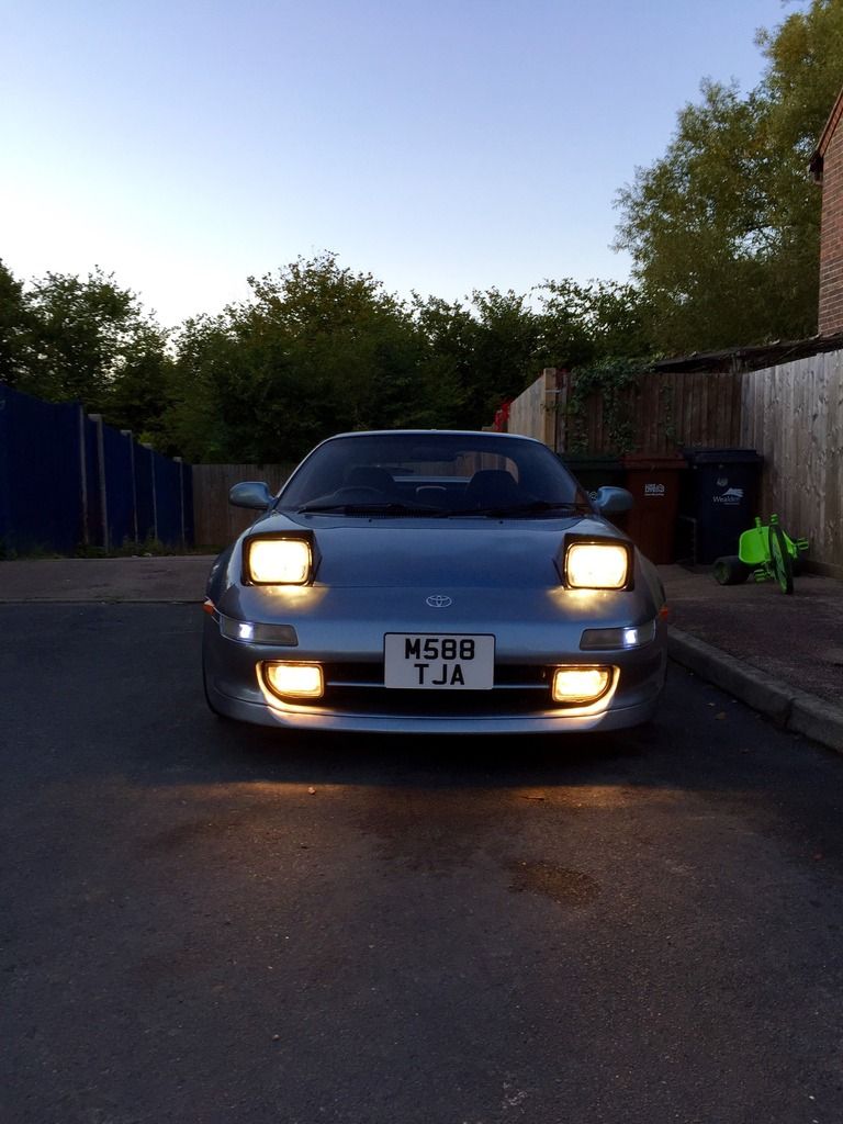

Hi Guys
I'm looking to improve the lighting from the headlights and also the fog lights, I'm running a set of LED sidelights that look great and produce a very nice white light, however the headlights and fog lights are still retaining a yellowish bulb that doesn't really penetrate the dark properly.
Obviously the main point in improving is for visibility. However i'd also like to get a nice white light from the bulbs / HID's to match the LED's.
my question is whats best and if you can recommend any kits / bulbs.
thanks,
Jordan.
[Mk2] [Turbo] HID kit or Performance bulbs ?
