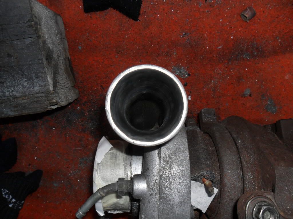

Post by 2mad »
alex687 wrote:so wouldn't porting the wastegate have the same effect by allowing the gases in their quest :) without sacrificing the turbine efficiency??
Thats what i did ... can post picks .. made my wastegate ports massive :thumleft:

Post by alex687 »
2mad wrote:Thats what i did ... can post picks .. made my wastegate ports massive :thumleft:
Go for it. how far back into the housing did you have to enlarge them?

Re: [Mk2] [Turbo] Can anyone help me identify this smoking issue?? VIDEO
Post by 2mad »
pics..

Post by 2mad »
Both ports all the way :thumleft:

Post by alex687 »
Wow nice job. Not sure I have the patience to do something like that!

Post by 2mad »
alex687 wrote:Wow nice job. Not sure I have the patience to do something like that!
Took 2 days .. found it kinda therapeutic .. i could theorise but the car went like stink after doing this ... with no creep :thumleft:

Post by mr2magic »
Re porting the wastegate and thereby improving flow:
In a word no. The wastegate has the job of divertung the exhaust gasses before they've imparted their energy on the turbine and has no impart on the capacity of the turbine. Increasing the wastegate area by too much will hurt transient respons and top end because more of the fixed amount of exhaust gas available from combustion will go through the wastegate if it opens.

Post by 2mad »
mr2magic wrote:Re porting the wastegate and thereby improving flow:
Well it peped my cars performance up 8-[ .. exhaust gases have to get out through the turbine or wastegate ... seemed to help me O:)

Post by mr2magic »
Was it a standard ct26?

Post by 2mad »
mr2magic wrote:Was it a standard ct26?
Ct20b .. my mods worked real well .. wish i had concentrate data :(

Post by mr2magic »
Hmmm I really believe that your being mislead. We know the ct20b has the perfect exhaust housing, turbine and compressor combo. Porting the wastegate would mean, that more gas bypasses the turbine from the moment the flapper cracks open........less gas at the turbine means less power. But as with any theory, the real world numbers will tell the whole story.

Post by 2mad »
mr2magic wrote:Hmmm I really believe that your being mislead. We know the ct20b has the perfect exhaust housing, turbine and compressor combo. Porting the wastegate would mean, that more gas bypasses the turbine from the moment the flapper cracks open........less gas at the turbine means less power. But as with any theory, the real world numbers will tell the whole story.
Kinda get what your saying ... but i had creep ... so the power was not usable .. after porting no creep :thumleft:

Post by mr2magic »
Boost creep or boost spike points to a mismatch aswell ;-) Basically the wastegate cannot divert enough exhaust gas to stop the increase in turbine speed - ergo the wastegate is to small.
So you're not really making more power, you're making the correct amount ;-)

Post by 2mad »
mr2magic wrote:Boost creep or boost spike points to a mismatch aswell ;-) Basically the wastegate cannot divert enough exhaust gas to stop the increase in turbine speed - ergo the wastegate is to small.
Yeah ill agree with that .. sounds plausible bud .. creep fc-uks things up proper :(
