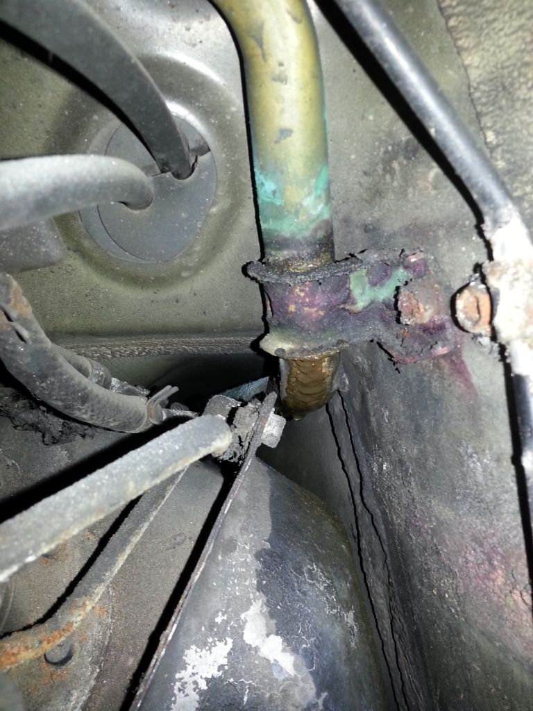

They break because the pipe has a metal bracket that bolts to the body work and the pipe expands at a different rate to the body work. I plan to cut the bracket off (a good second hand set) and then use a rubber or leather strap to hold the pipe to the body work.

If that's not long enough, have someone who can braze re-do the suspect joint, which is what we do.
Then you can have original pipes with the known weakness removed.

This is the puppy leaking. I assume it's the same pipe

Yeah thats exactly where mine has gone, I am going to cut the bracket off and use a 'P' clip with a rubber inner. I will get some second hand pipes but I will pressure test them after I cut the bracket off. They are made of xxxx metal so can be welded, brazing or soldering/silver soldering are your only chance to fix a broken one.
