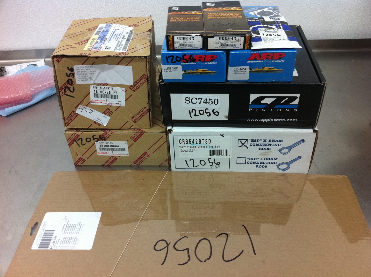

My bottom end forgies, water pump, oil pump and gasket set about to leave the Newfoundland, destined for greatness across the pond!!!! :D

So I now have possession of my CP pistons, Eagle Rods, new water and oil pump, ARP bolts, ACL race bearings, OS Giken fly/clutch and alloy crank pulley (the topic of much debate), along with a complete cometic bottom end gasket set.
The block is going to get machined, balanced and assembled at MJA Engineering, not an MR2 specialist, but seems to know what he is talking about, and has been doing it for 20 something years (not to mention the fact that he doesn't charge the earth).
