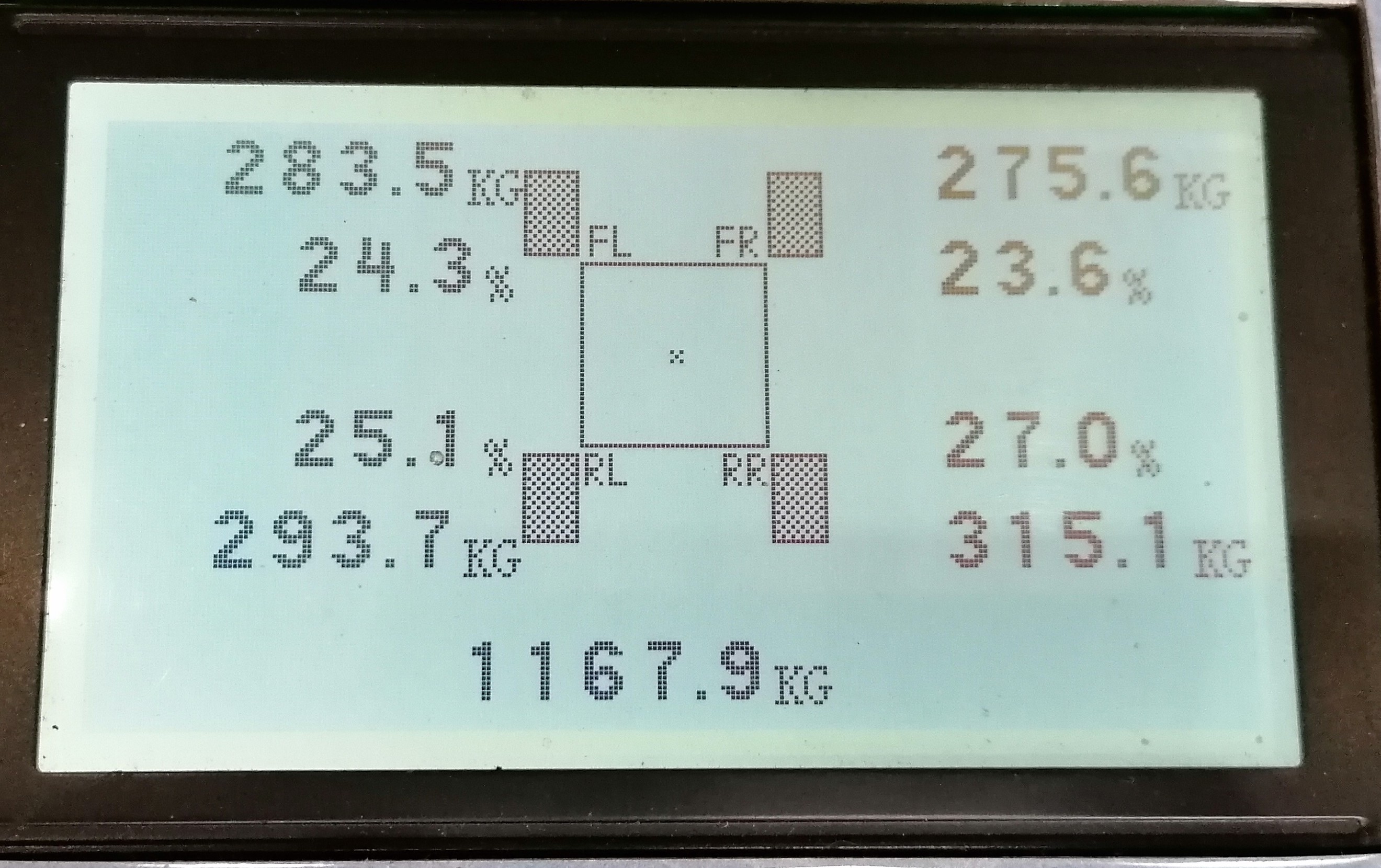

Managed to use some corner weights, quite happy as 95% of the cars components are in place. Main thing missing was oil and coolant.
Corner weight
Corner weight

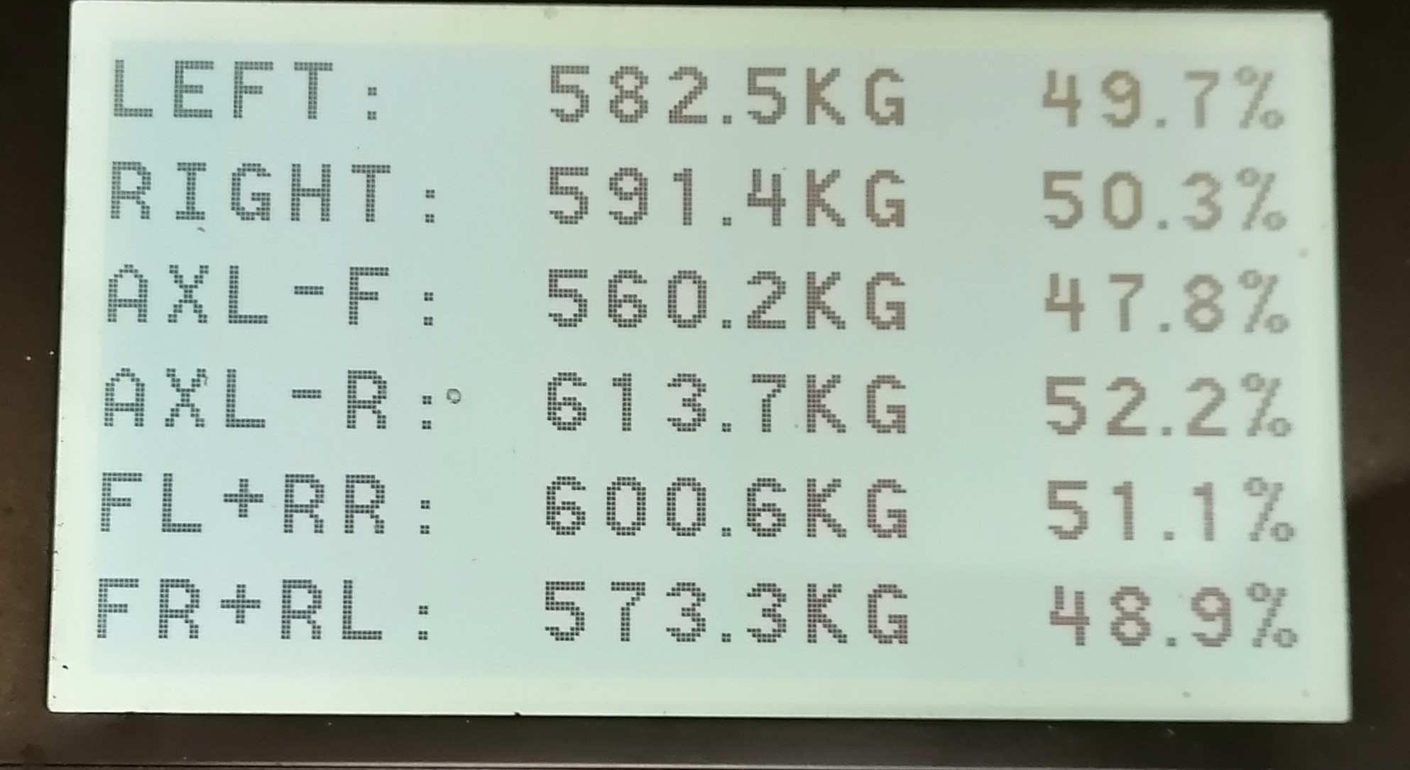

Axel and diagonals
