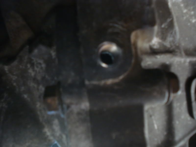

You should now have clear access to the 2 holes in the gearbox.
Before the recoil kit can be used, the hole has to be widened. The drill is 10.3mm, so only a bit wider than the 10mm existing hole. This is the advantage of using an insert kit, rather than say moving up to a M12 bolt – which would need a 12mm drill.
Make sure the drill goes in straight, it will tear through the aluminium gearbox, and you want it to line up when the brackets are back in place. You don’t need to go in too deep – say 4 or 5 centimetres.
Next
Insert the tap into the square hole on the hook tool. Simply wind this into the drilled hole. Again, make sure you do this straight – steel is stronger than aluminium. Every few turns, un-wind it a bit to clear the debris out.
You need to wind the tap in about half way down – say 5 centimetres or so. If it gets really tough, stop – you’ve probably reached the bottom of the drilled hole.
Next
The inserts have a tang across the base. Take the tap out of the hook tool, and slide an insert over the end of the tool. The tool has a slot in it, and the tang in the insert needs to sit in this. the tang should be at the end of the tool - i.e. go into the gearbox first.
The insert is a spring. You have to wind it in under force to stretch it. This makes it grip the inside of the threads you’ve just cut, and will stop it unwinding when you take the bolt out.
You line up the tool into the hole, and start turning whilst applying pressure. This will cause the first loop to catch in the thread. Keep turning, and it will simply wind the insert into the gearbox.
Keep winding until the end of the insert has gone half a turn or so past the lip – i.e. completely inside. This is where you find out if your hole is deep enough.
Taking inserts out needs a special tool, which I don’t have. Google will have the answer though. Don’t break off the tang until you’ve got the insert fully in
Next
For a long bolt to fit in, the tang has to go. Remove the winding tool, turn it 90 degrees, and insert it back in, and give it a sharp push. As the slot won’t be lined up, it will shear off the tang, which should fall out.
Job done
It’s now ready for your bolt. The kit I have is a normal pitch – 1.5. Wind a bolt in to check its all working. The inserts look quite slim, but they are stronger than original apparently. Don’t forget, the clutch slave bracket and engine mount bracket add depth, so your new bolt has to be long enough to reach the insert properly. The bolt can go through it – you just don’t want it hitting the bottom of the hole.
